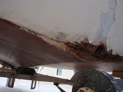

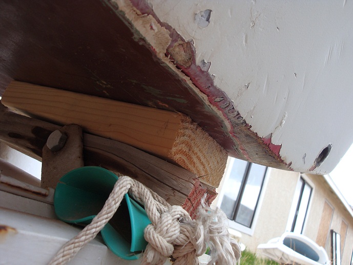

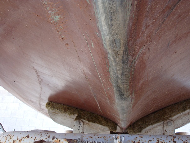

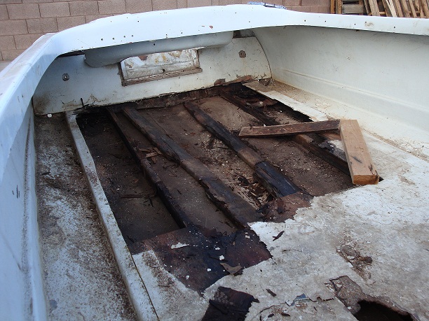

Adding a couple pics
One of 2 spots of Hull /Transom joint dammage.
Right side Hull/Transom dammage
Hull dammage on bow. This I am not sure how to repair ?
Re:Restore question - New glass over old glass 14 years 8 months ago #56412
from your pictures you have a restorable old boat. your best bet is to strip out all the rotten wood, cut out all the glass that the stringers were mounted to , grind out the hull , clean it out and see how it all looks . the original glass is more than likely still very strong and probably wouldnt need another layer but that choice is up to you . You can use either epoxy or polyester resin to do all your glass work but remember once you use epoxy resin you have to stay with it because epoxy sticks very well to polyester but polyester bonds poorly to epoxy .
Re:Restore question - New glass over old glass 14 years 8 months ago #56416
Gil is absolutely correct. You have your work cutout for you. Everything has to be stripped. The bottom back of the transome is goona take some real work. It looks like most of the "meat" is missing. Just an idea, you might want to pop the upper part of the boat off, if possible. It'll make working on the deck easier.

I am looking to see how I would have to go about fixing the Hull damage. It looks like at one time the boat was worked on... in the pics, oyu can kind of see what looks like a second glass layer on top of the original hull. there is red under the white line of the shreaded glass.... or possibly a bondo layer ??
From what I understand, when the hull is laid, the transom joint to the hull and sides, get laid up a little thicker ??
So to fix the center damage, I would guess that I would need to cut out the damage and install a backing that keeps the shape of the hull, and lay up the glass from the inside, just like when it was initially laid.. But with the damage on the right side, would I need to do the same process? The hull is not breached on the right, but in the center it is... Or if I cut the center out, would I have to blend the entire transom to Hull joint as 1 piece, or is the patch in the 1 spot acceptable ?
AS far as teh extra layer of glass, yes I would want to add at least 1 layer of CSM to furthur water proof the old glass. Per layering specs, Mat /cloth/ Mat.. Originally, the builder did not lay down the top layer of Mat... I was going to grind down the paint on the interior anyway, which the way the finish is currently, I'm sure will cut into the top cloth layer, so I may as well make the finish better than it was.

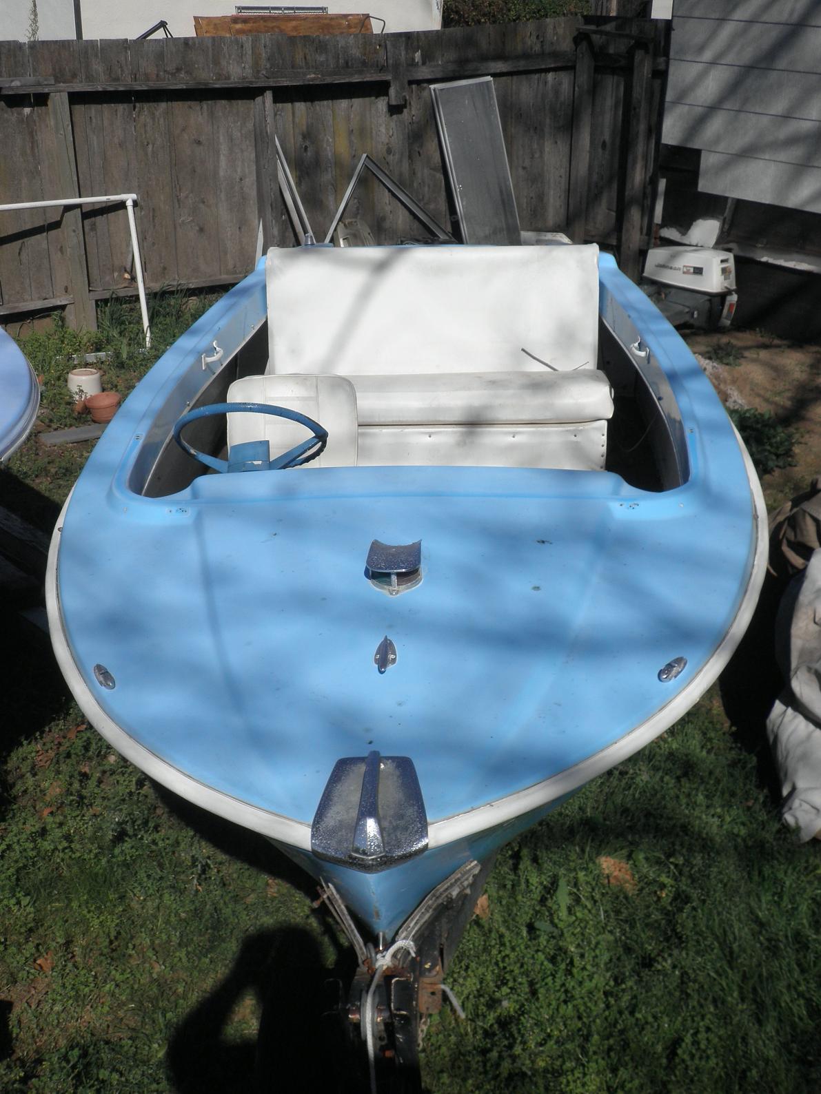

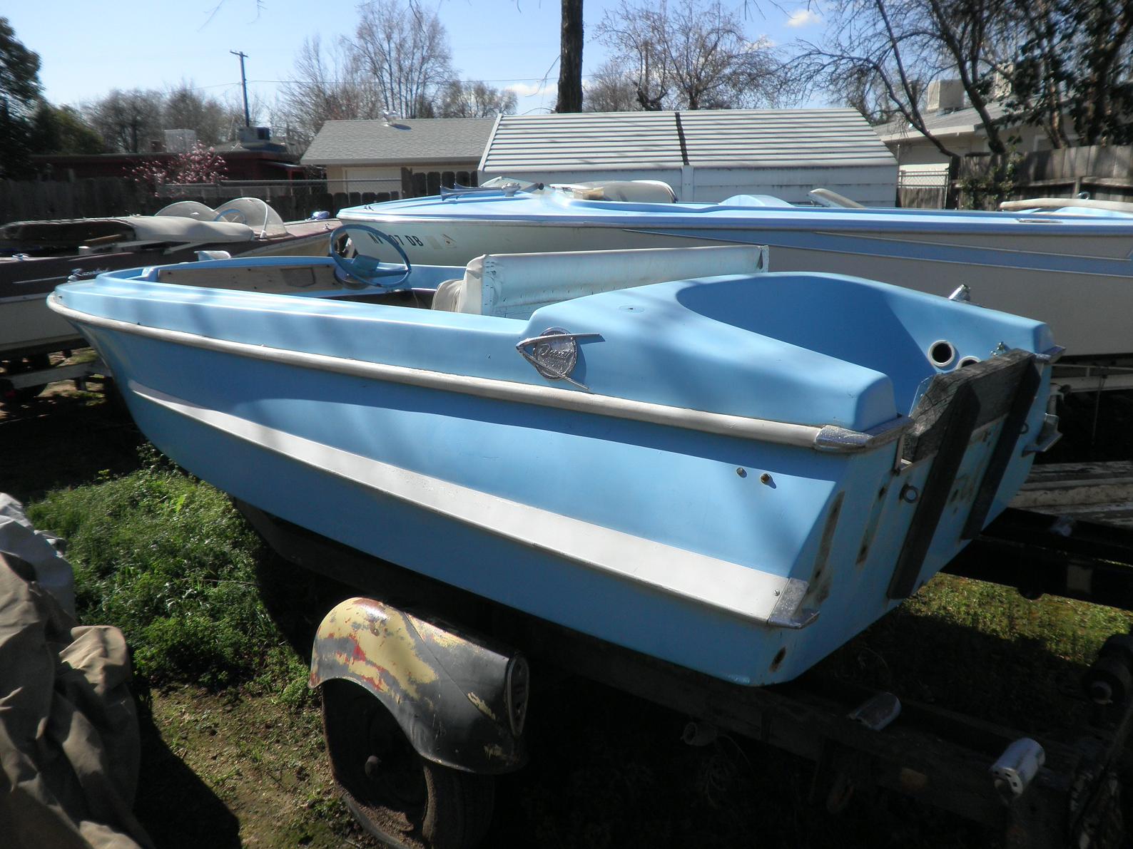

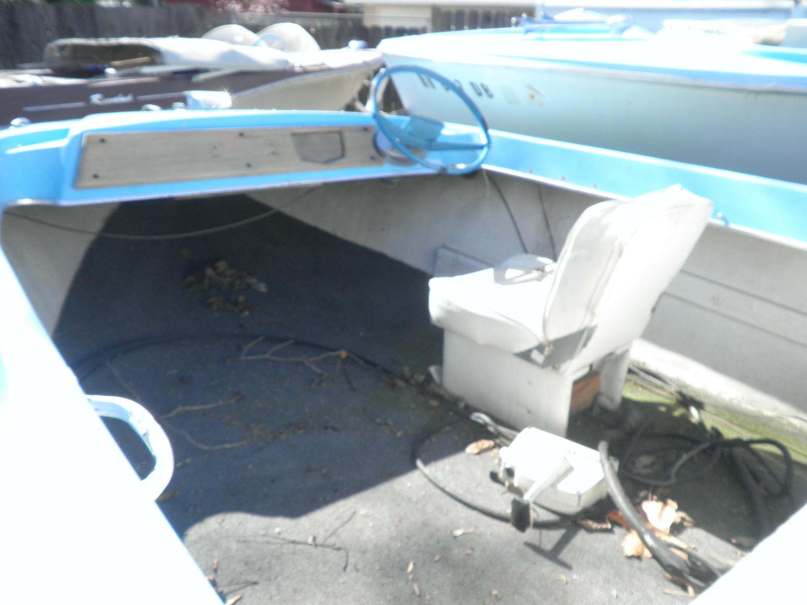

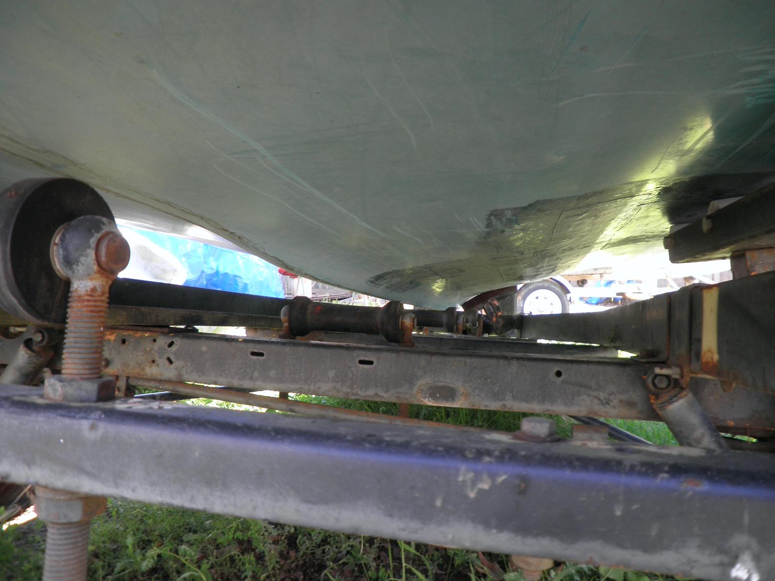

Here are some pictures of the Belmont I have. The boat is your for the taking - free. The trailer, the mercury motor control box, and the steering wheel assembly are not included. You will need your own trailer and straps, or I will sell you a decent trailer (not the one the boat is currently on) The boat has current CA registration - and the title is somewhere in my office. I have floated this boat & it does not leak from what I can see. The floor has one small soft spot, but feels good otherwise. The keel is straight - the bottom has a repaired area. but in all, it's way better than what you've got. The price ain't bad either..
Let me know if you want to come get it.
Bruce
