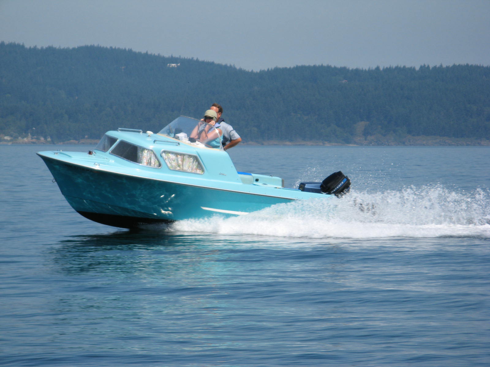

I had a 40 H.P. Evenrude on my Catalina when I bought it and that would get on a plane but you had to have everything forward to do it and it took awhile . I put an 85 H.P. merc on it and it jumped out of the water . Your 60 would work and if it's a good motor I would try it. If not don't go anymore than an 85 . Catalina's are pretty tippy because you stand so high in a narrow boat. My 85 went as fast as I wanted to go . If I got going fast you had to make sure people didn't move from one side to the other very fast.
