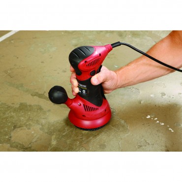

Evening All,
Sorry about not being around much lately. I'm carrying 21 credits this semester as well as working three days a week. I will be so glad come graduation day this fall.
My question involves a tool from our favorite place, that's right - Harbor Freight. I noticed this when I received the latest sales flyer and it looks promising to me. I was wondering if anyone had any experience with one. The reviews show it did a good job removing paint from wood without scarring it so I'm thinking it might do well on fiberglass.
The tool costs $29 and would also no doubt need a few replacement disks/wheels/whatever it uses to get the job done. If it works well and would only involve an investment of about $50, I think its a worthwhile investment.
As always, I value the opinions of the gang on here. Like I told John Gibson when I saw him, the group here are some of the nicest people I have ever encountered.
Take care all!
Todd
P. S. Here's the link to the tool at HF's website.
www.harborfreight.com/electric-paint-remover-65990.html
Here's a pic of the tool, too!

I posted then went to the site. Personally, I would not use that. It looks like it will dig into your glass. Dude, he was using it on metal. I know liquid paint removers are messy, but, it does get the bulk off.
Re:Question on Paint Removel 14 years 9 months ago #55310
I bought the same tool from HF...I have a wood Yellow Jacket that I wanted to remove the bottom paint off of. After going through 4 pads and spending an hr to clean a 2' X 3' area I took the tool back and went with paint stripper
