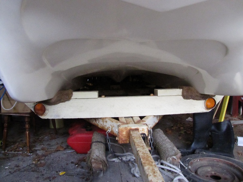

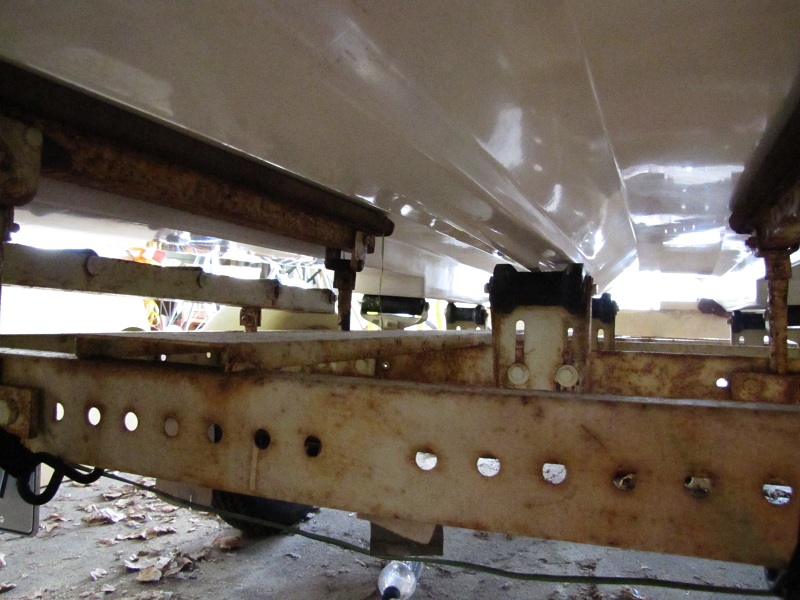

Here's a couple of pics

Re:Supporting a boat off the trailer 16 years 6 months ago #5520
Tudor, your trailer looks about like mine, rust wise. (I'm trying to hold off until this fall on the re-do.) Please keep us posted on your project. Gonna media blast or sand manually?
Re:Supporting a boat off the trailer 16 years 6 months ago #5526
  • thetudor
  • thetudor's Avatar Topic Author
  • Posts: 1206
  • Karma: 33
I plan on taking it apart and sandblasting. The fall would be nice, but I want to have it done for the CC reunion in September
