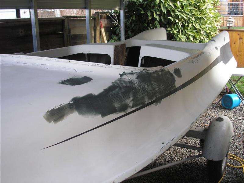

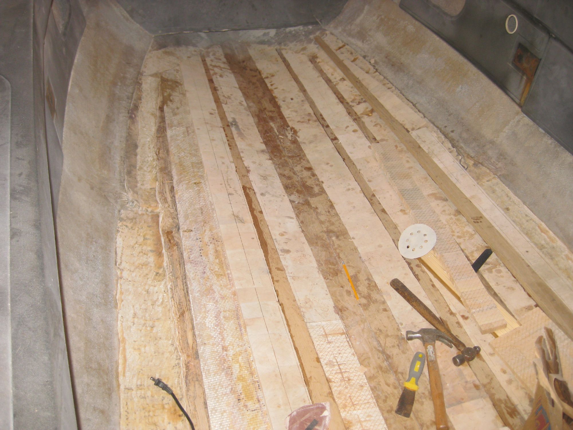

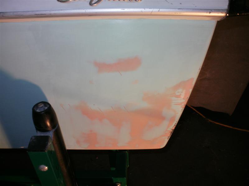

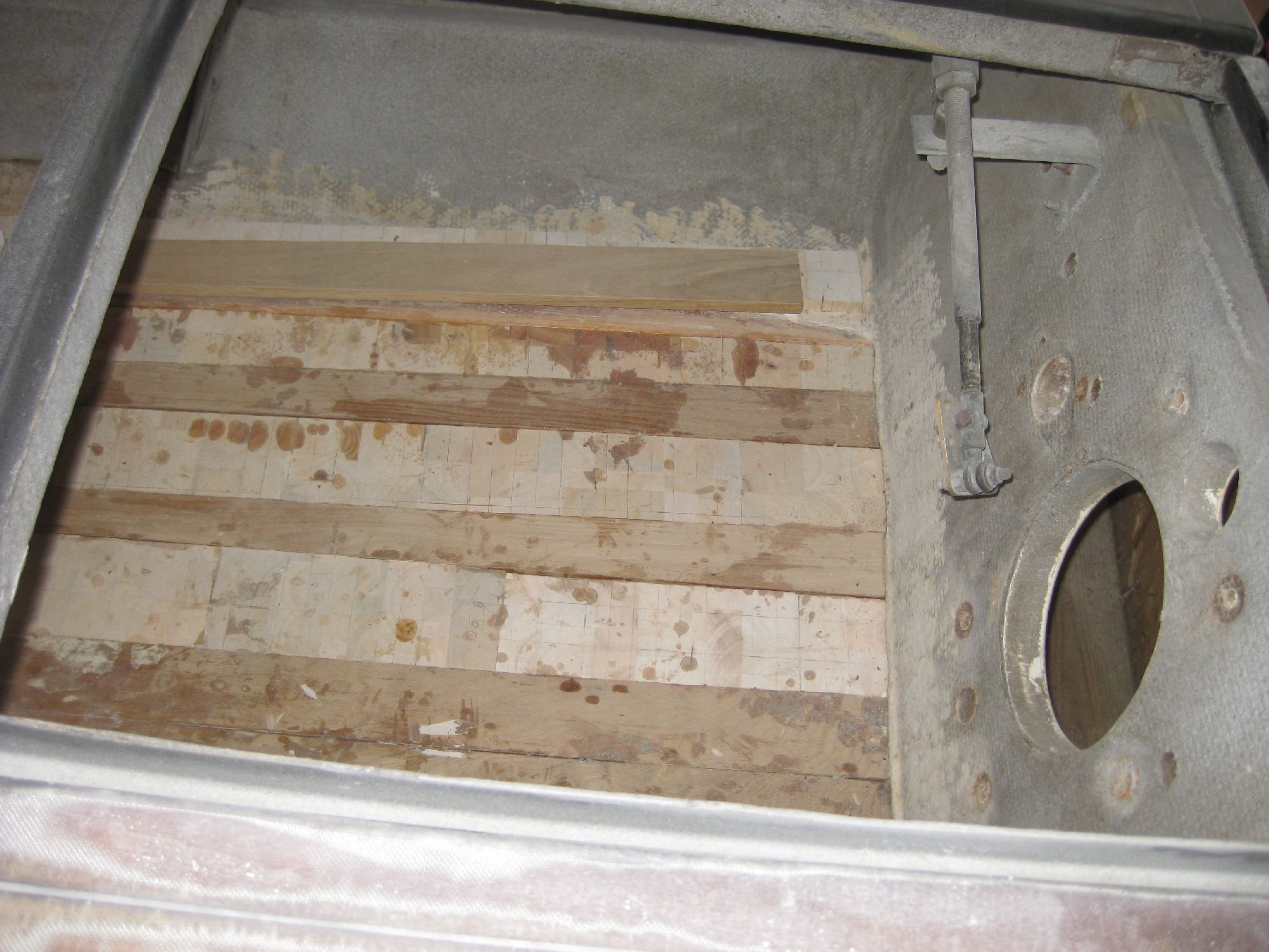

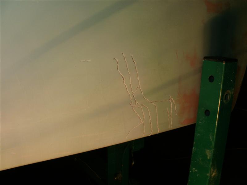

I started sanding the gelcoat on my '61 Hydrodyne. I began by using 40 grit orbital sander. It is slow, but will remove the black tint. Then I tried 80 grit belt sander and it rapidly took off the tint and quickly made it pass through the first layer of cloth down to the roving. I figure I should just keep using the orbital. However, does anyone think the spider cracks go down through the resin to the roving? After sanding, where some of the resin looks and feels smooth, there still seems to appear "lines". Should I just get down to the cloth and then rebuid with resin regardless of the look of the existing resin? Also, here are some pictures of my recore (almost finished)

Unless the fiberglass structure has be hit very hard (like bashing a dock ) the cracks likely are limited to the grlcoat. It looks like you are doing a lot of damage to the hull. The sanding is going to take a horrible amount of time to fill and fair. Not every spec of gelcoat needs to be removed. The best time to stop is when the gelcoat is approaching transparent - you don't want to get into the hull glass unless it is damaged. Once the top coat of paint is laid - all the imperfections - hifh & low areas - gouges - etc.... become glaringly obvious. Consider having the hull sandblasted or doing it yourself. Wear protective equipment no matter what. An inline "longboard sander will do the least amount of damage. This is a big job on any boat, but your work will pay off if you are careful in these stages of repair..

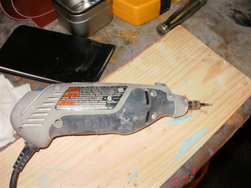

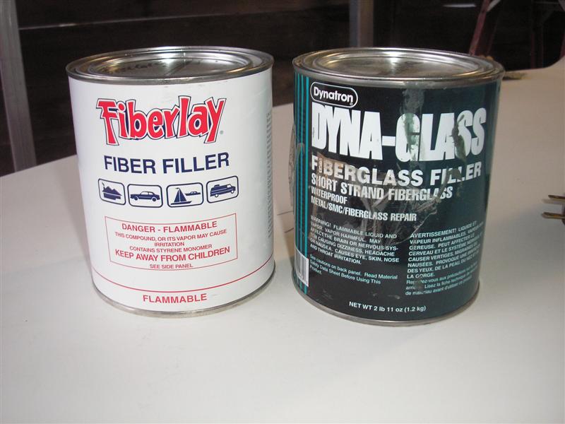

I would not go through the fiberglass mat. Where I had cracks I grind out with a dremel drill with a carbide tip just through the gel coat and verily into the mat and then fill with Dynaglass - its a marine grade bondo with fiberglass strands in it. Then I fill, sand and fill again and sand smooth. Like Bruce said you will have a hard time filling and faring to get it mirror finish . Especially on the outside where it will be seen. I use the fiberglass filler for faring. When you grind through the mat you also lose structural strength. That's what I do I'm sure there are other opinions.
