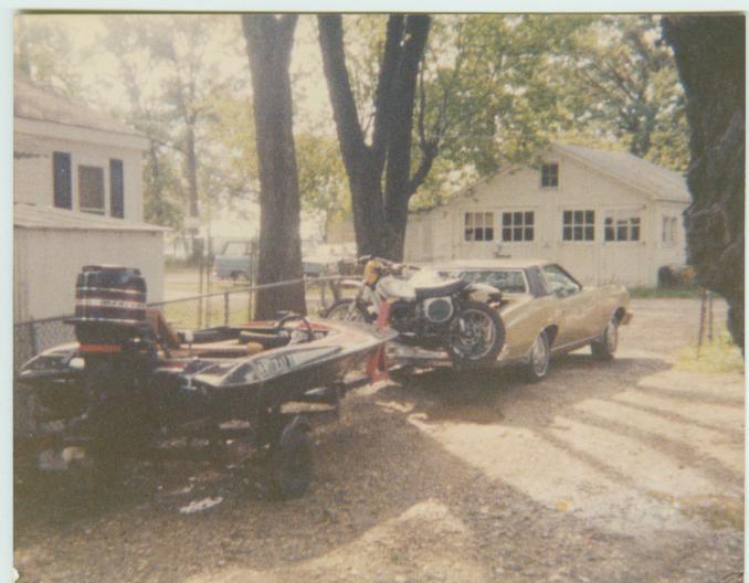

Robby321, Is that a real live 1974 Honda CR250M on the back?

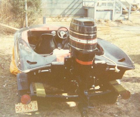

This is what my Dads Herter boat looks like with a long shaft.Used late model short shaft motors are very hard to find.Right up there with small hp remote control ones.
Cr250M's were not year specific,'73,'74 were the same except the very early ones that had billet cranks :)
