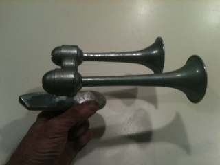

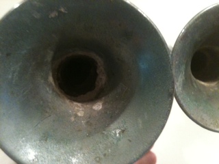

Why is it that some horns are single horns and others are double horns? I have seen a triple but what the hell, why not go to 10 or 20 and scare everybody all into next week. Just curious about that but also I am getting ready to refurbish the double that came with my Crosby and there is a bunch of what appears to be old Mud Daubers nests up inside the horn itself. If I jam a long piece of metal or whatever all the way into the Back of the horn to clean the nests out, do I run the risk of damaging something that will prevent the horn from ultimately working? Thanks in advance.

Sgl, Dual, or Triple trumpet is more styling and what kind of sound you're trying to make, IMO. Singles can make as many db, but duals add a two tone effect, etc... John G has more experience with air horns, I haven't seen a set like yours. Most have a metal diaphragm back in the mount area that generates the noise, a wire shouldn't hurt that unless you used a coat hanger and poked really hard! Like I said, not familiar with that style, though..... :unsure:

Do not poke with wire. Take air fittings off and wash out with hot water. Let dry out really good and the blow so air through inlet fitting to see if they work. Be carefull not to use to high of pressure or you will damage the diaphram. 20 lbs max should do it. Good luck, Ship.

skip is right in what he told you,also make sure they work before restoring them,i didnt once and after all that work they didnt work,they were kind of like yours,but you couldnt tear them down to fix them.if you need them restored in paint ship them to me,no charge,john
