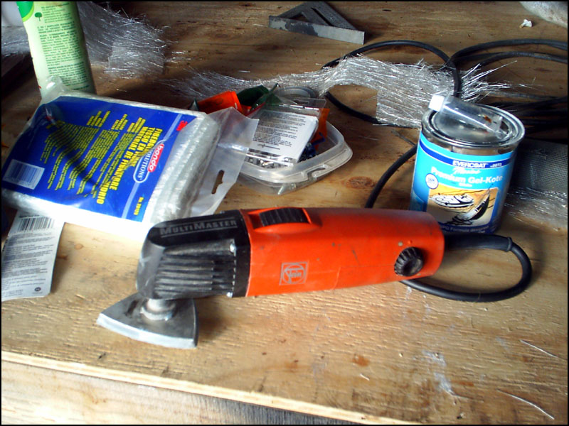

Oak,sealed in Epoxy not glass and a Fien Multimaster to remove em.

FEIN multimaster is a great tool. We use them for work to cut and remove very small joints in masonry and stone. The blades come in a variety of sizes and styles. Be aware however that they are not cheap. A search will show that they can be from 350 to 600 dollars depending on what you buy. A cheaper solution to cut with may be a handheld grinder, with a cutting wheel, or an air powered die grinder with a cutting wheel. Both will cut glass very well. The Fein knife is the cadillac of cutters however.

harbor freight sells a cheap model of a multimaster,2 models acually,my brother in law loves it ,im going to get one too,,one is called a multi function power tool for regular price 59.99 ,and a variable speed for 79.99, but they are on sale for 39.99 and 59.99,the cheaper one is about all i can afford,lol.plus i wont wear it out too quick,im kinda lazy,lol.

If it's a one shot deal the HF tool should do the job just fine.
I got the BOSCH version first then the Dramel. But I work the H*ll out of my tools.
I finely got the MultiMaster and it was worth every dime and then some. Words can't tell you the night and day results from the Fine over the knock off's.
