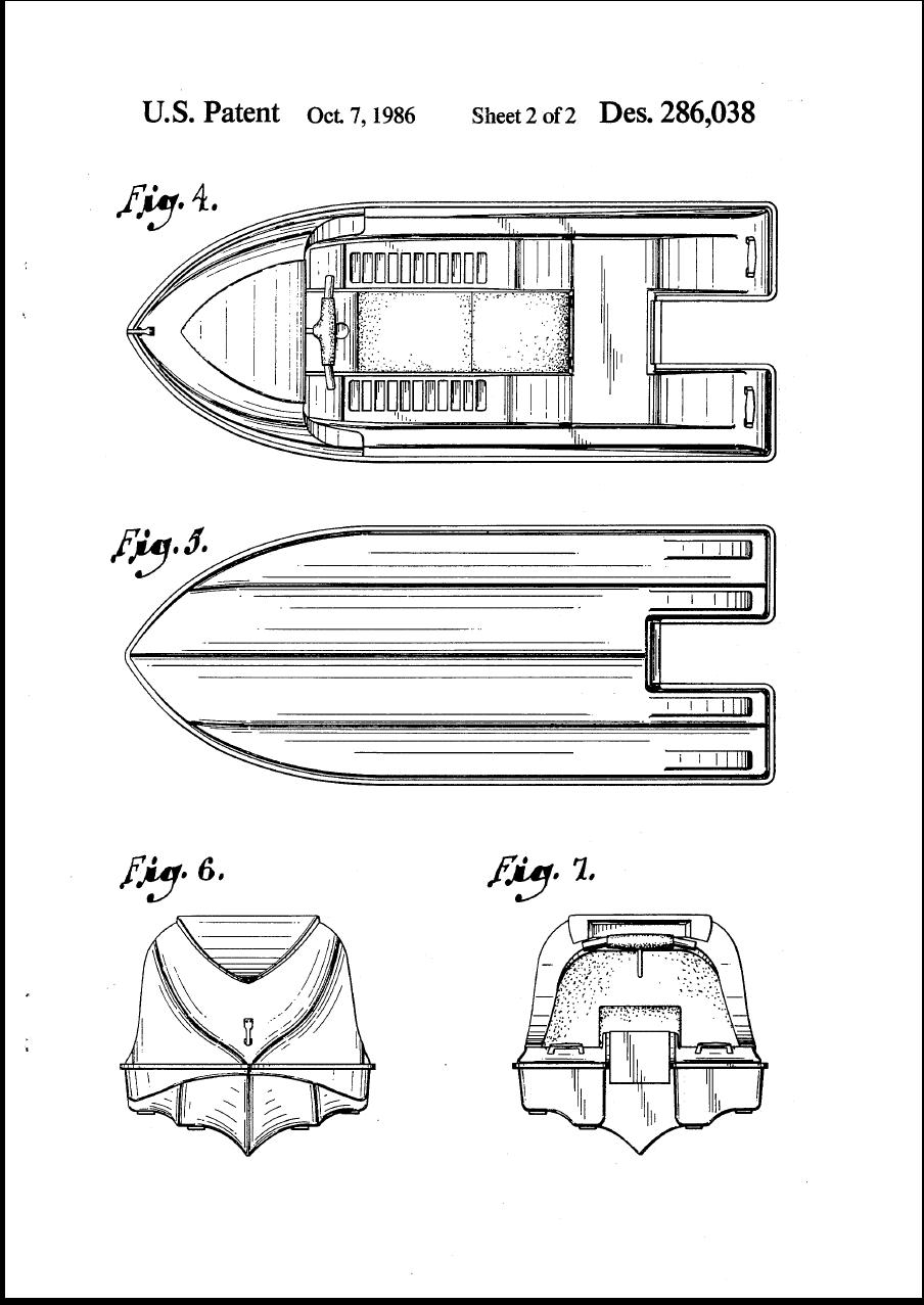

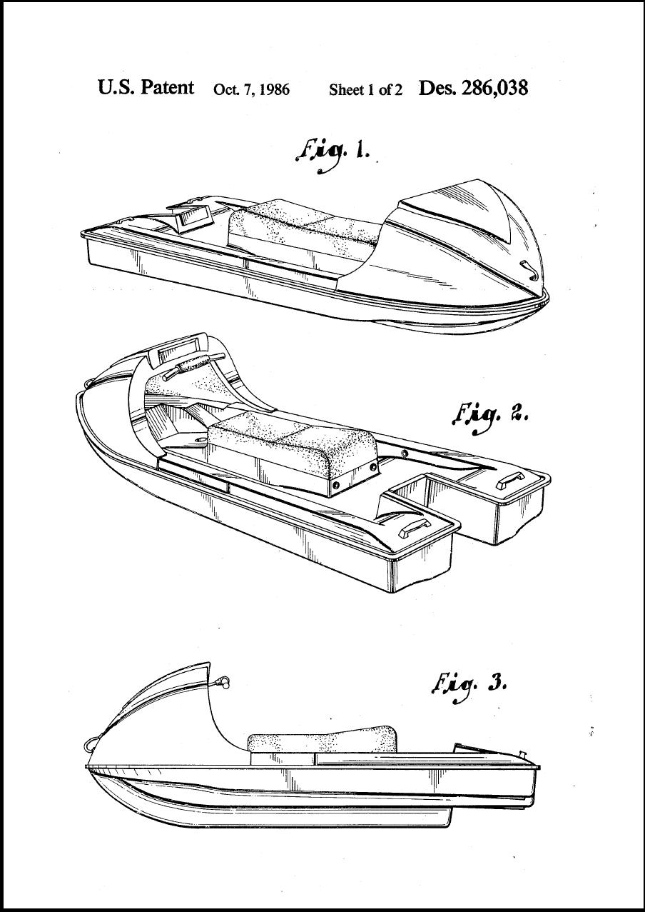

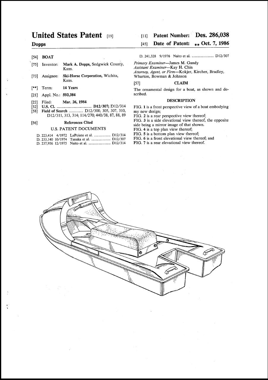

Re:Outboard pwc? 16 years 6 months ago #5229
Probably can replace the rivets with bolts of some form or another, depending on the accessibility of the inside of the hull.
Here's an old post about the Ski-Horse Corp.
archives.fiberglassics.com/forum818/showmessage.asp?fm=Forum1&messageID=29439
