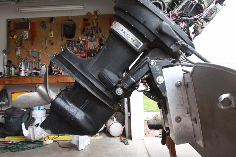

Well made my own jack plate out of 4x4/.25 angle aluminum and mounted the 1250 to the Carlson Contender.
Went out today and damn Thom you were right that 99 cube 1250 will flat out walk by my 93 cube 1100. The mid range punch is impressive.
Ok the question???
How to rebuild the transom swivel? It it the shaft or the bushing that wear?
This thing gets squirrly approaching 60 mph and its mostly due to the slop on the swivel area.
Conrad
Re:1250 Runs Nice 16 years 6 months ago #5077
Conrad, I replied to your post on Scream and Fly and I'm thinking about your 90 HP Merc shortshaft. I thought I had a deal on another motor but it looks like it could fall through. I may get in touch if it does.
Meanwhile, since I have a Contender on the way to me with no transom, I'd like to ask about your jack plate. Does the boat porpoise much at mid speeds? It looks like you have the motor clamp about 2-3 inches above the transom. On a short hull 5 inches of setback seems like a lot. I keep hearing that these boats like to sky the bow, did you run it without the plate?
I plan on running a shortshaft on the transom of mine and your experience may help me to decide how tall to make the new transom.
