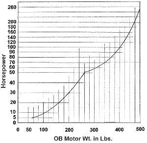

Chart 2
Weight of typical outboard
As an assist in determining gross weight Chart 2 indicates the weight of a typical outboard motor based on the horsepower. The weights are an average taken from several outboard motor manufactures and included four cycle types.

Great charts, thank you. Top speed is not my goal. I think my question was better answered with estimated weight of engines. I have no knowledge base on any of this. Including weights of engines, hp ratings, and construction of hulls and transoms.
Main reason for question is due to tiny budget for this project, I am looking for a $600 dollar type boat that runs. I found one with a Mercury 80 with that gorgeous ribbed chrome?metal cover.
BETTER QUESTION what is weight of a 59 ish Mercury 80?

Chart 2
But for what model year? As I said, when looking at the basic OMC V4 it had a huge range of horse powers over many years where weight changed very little. Even between 59 and 65 V4s went from 50 to 90 HP with basically the same hardware.

When rigging a motor on a boat, the weight of the motor is my primary concern. The transom supports the weight of it and other pressures on the motor, and when installed properly the transom will transfer those forces up the hull. The weight the transom feels can very as the motor bounces (trailer is more than in water), or the motor gets used for a step or seat, motor/prop torque, or the resistance of the water. The faster you go the more water pressure on the lower unit of the motor and thus to the transom.
