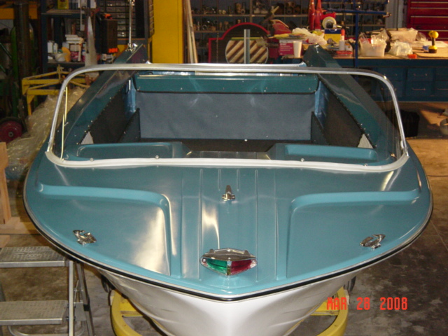

Hi, Im restoring a 14' alumacraft alpex fiberglass boat, where might i find the white rubber that goes at the bottom of the windshield?
Any tips on restoration would help too. Im 18 and this is my first boat restoration. Im finding it pretty easy tho, already got new transom in and started on the floor. Thanks

check wefcorubber.com, based in California. they have tons of rub rail, extruded rubber profiles, etc. there may be others who just specialize in the windshield strip. 2 critical things are the thickness and depth of the slot where the windshield sits, and whether your deck is flat or more of a tilt for the rubber to sit on.

Also check Ebay there is a guy there that sells it in bulk.

You can get the White Twin Flap Vinyl Deck Channel along with new ether hidden or external Hold Down Hardware from www.go2marine.com/search.do?q=windshield+hardware&x=20&y=18
Hidden Hold Down Fastener
Part# 154706 | Mfr. Taylor Made | Mfr# 1607
Hidden Hold Down Fasteners by Taylor Made come in packs of four (4) complete with nuts and rubber grommets...
$18.34
White Twin-Flap Vinyl Deck Channel
Part# 100743 | Mfr. Taylor Made | Mfr# 826500
Vinyl Deck Channel by Taylor Made Products is punched to accommodate hidden fasteners or external angles...
$35.44
External Hold Deck Angle, 4 pack, Go2Marine part #155755, Taylor Made part #1623
