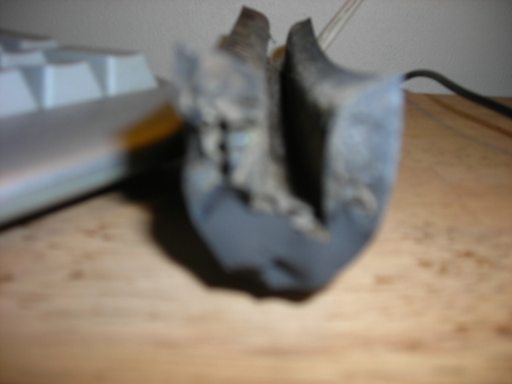

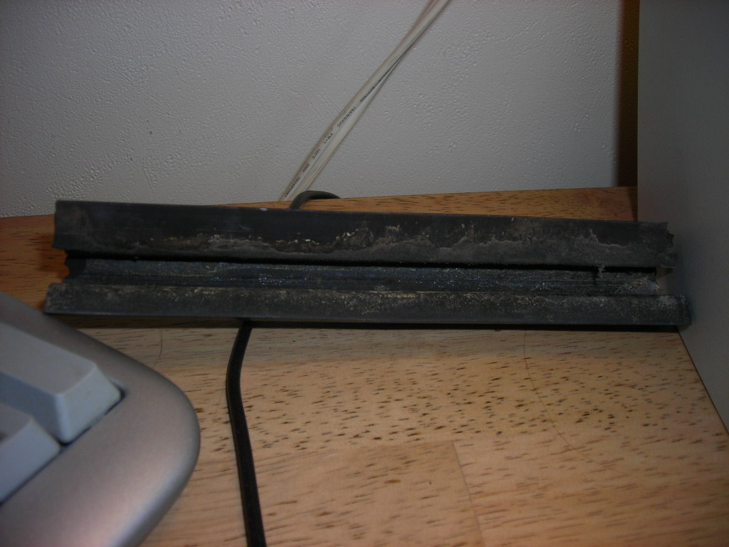

this is the rubrail from the 64 custom craft sunray,i tried every where and the closest match i can find is wefcos,but its hollow in side,does anyone know where i can find some like this,its 1 1/4 inch wide,1 inch thick,with the cutout at7/8 deep and3/8s high(sorry about the 1st pic,its blurry and i should have cut the rubrail off evenly,this how it looks where it broke off with ragged edges)

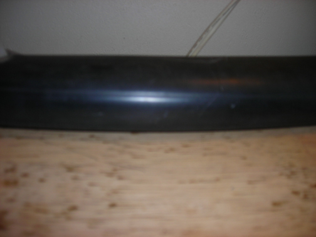

this is the closest ive found yet,wefcos profile 0400g,but its hollow,but the dementions are close. sorry i cant get the profile sheet from wefo to show up in a pic.

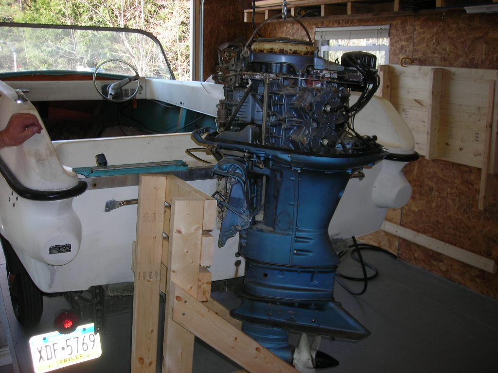

thanks frank,my rubrail screws on from under it,but im a little worried about the very tight curve at the back of the boat,im hoping a heat gun on low will work to curve it around,just need to paint it and get the rubrail,lol.you can see them in this pic,its on both sides,lol
Re:i need rubrail help 16 years 6 months ago #4779
A little heat to excite the molecules and she'll roll right around those corners. Not too much though!
