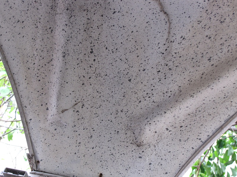

Any idea on how to reproduce something like this?

todd ,you can paint the bottom coat white,then take black paint,and dip a brush into it,then tap it on your hand ,the paint will splatter,but have a scrap peice of plywood or cardboard to do it on each time until you get the amount of black you want,it takes off the excess and gives you a little practice,john

I think you could get close using the methods described in this thread Todd;
www.fiberglassics.com/glassic-forums/2-main-forum/46882-interior-paint-and-rubrail-insert.html#47036
The "Zolatone"/splatter paint method could be adapted a little to produce just the dots, I believe. (Use less paint in the brush, maybe?)

The interior 'glass on my Glasspar was originally Zolatone... When I repainted it, I did it like this, which I call "Fauxlatone"-
Is that close to what you want? I can post instructions.... Whole job cost about $20.

Andrew - yes, please post instructions for your method when you get a chance - it looks exactly like what I want to do as well.

I did a fair amount of experimenting before I did mine- Just to make sure that I could figure out how to do it right... Since I'm an artist, too, I like to experiment...
In the end, the best method I found was essentially what John Gibson told you to do. But, I did some experimentation to figure out the best (and easiest!) way to get it on there.
I used industrial enamel, Rustoleum or similar would probably work fine, too. I used a quart of white, and a quart of black. You could, however, use pretty much whatever color you choose.
First, I painted a good coat of the base color on the primed fiberglass. While it was still tacky, I applied the speckles. They are the same paint, but thinned pretty heavily (probably about 30% or so). I mixed the two greys by adding black to the white. Careful- A little goes a LONG way!
I found that the key to getting consistent specks that didn't run was a combination of technique and tools. I used a 4" 'chip' brush- One of the cheapies from Home depot. They are absolutely horrid paint brushes, but perfect for this- The 'better' brushes don't work nearly as well.
I dipped only about 1/4" or so of the brush in the thinned paint, then tapped it on the side of an empty paint bucket until it was almost dry, then tapped the brush with a piece of scrap wood over the boat.
You want the brush to be ALMOST dry, so the spatter is relatively light- Otherwise it'll drip and run. Do it in different directions, and move all around the piece that you're working on to avoid getting a pattern.
Experiment a bit on some plywood or cardboard, there is a technique to be learned- but once you figure it out, it's easy! I think it looks pretty decent, too.
