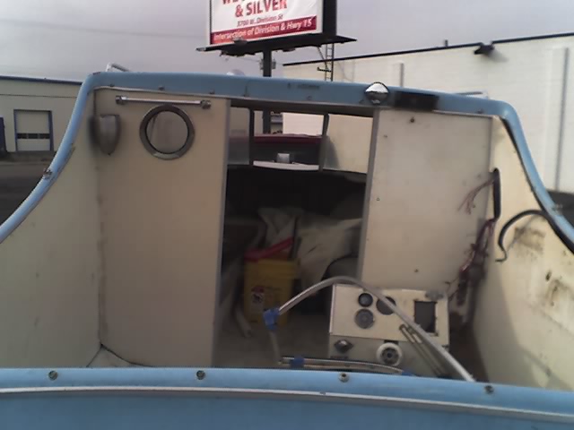

Well here it is my newest project that I don't need. I may have to front burner this one over the winter so it is not embarrassing to use next summer.
It isn't in all that bad of shape. There are a few broken spots where it got hit or something, but that is the beauty of fiberglass, easy to fix. I think I'll be using my Sea Lion Runabout as a parts boat to get this one in prime shape.
It will get a 61 Evinrude Starflite 75 for power.

There are about 5 spots where I need to do some structural repair. All on the deck half of the boat. The Hull is solid and defect free.
I even made it back home on trailer tires checked with cracks as deep as my thumb nails! New tires before any more street towing! Good thing It didn't have a motor on it. The guy had a 115 Yamaha on it. Too big for this boat in my opinion.

Jepster, From looking at the buildings in the background, Is this boat located in St Cloud? maybe near Lincoln Ave NE. Tom
Re:1960 Larson Sea Lion Cruiser or LOOK WHAT I HAVE!! 14 years 6 months ago #50854
  • jepstr67
  • jepstr67's Avatar Topic Author
  • Posts: 649
  • Karma: 13
Right city. Wrong location. Ickler Company parking lot. 1-1/2St South and 29th ave.

I have chopped a few car roofs in metal. I've never attempted to do what you are thinkin'. I know good bodymen that tried to with fiberglass cars...it just don't work. When doing a car roof you cut it into multi pieces, a '51 Chevy PU I helped a friend do was 13 pieces i think, but it looked good. The problem with doing it to a molded glass body is you cannot shape the edges of the pieces and get a smooth conture. It gets what we called the "Dome House" look. I think restoring the boat you've wanted for so many years would be easier with better end results. It may take more man hours but you'ld know it's sound. If it was a bolt on app you'ld be onto something. You already see the challange matching the edge cut. I think you would also end up relocating the helm station. Oh...those guys that got the good deal on a 2nd hand glass body and tried to chop...ended up with a roadster or Carson top. just my 2 cents.
Re:1960 Larson Sea Lion Cruiser or LOOK WHAT I HAVE!! 14 years 6 months ago #50870

The more I think about it, I don't think the graft is the right move. These Larsons are made in two castings and upper and lower. The way I'll do it is to fix the deck, cabin, and any problems with the upper part. After the top section is in good solid shape. I'll use it for a while and see how it goes. If I detect the hull is in bad shape, I can always work it over or divide both boats at the point where they were originally assembled and switch hulls.
Re:1960 Larson Sea Lion Cruiser or LOOK WHAT I HAVE!! 14 years 6 months ago #50873
Good thinking. Whatever you decide keep up in the loop.
And lots of pictures.

Here is why my idea won't work.
From the windshield back there is a gentle curvature of the gunnel all the way to the stern. On the cruiser, the side of the cabin is straight to allow the window to slide freely in the track. Even on the cruiser, the window binds up, so I will need to reinforce the cabin to allow the window to move easily. Since the whole cabin is weak and broken, it will be necessary reconstruction anyway.
