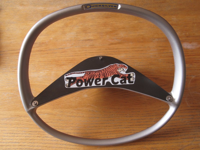

Mine was on with machine screws. The plastic was cracked, so I got some aluminum plate and made a new insert that is attached with machine screws.

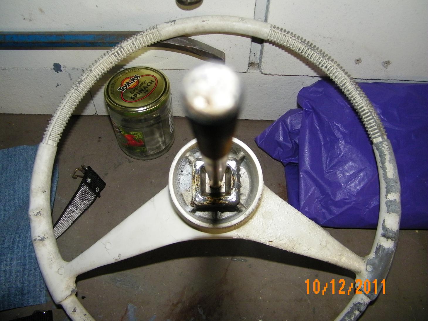

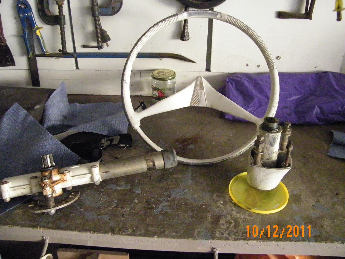

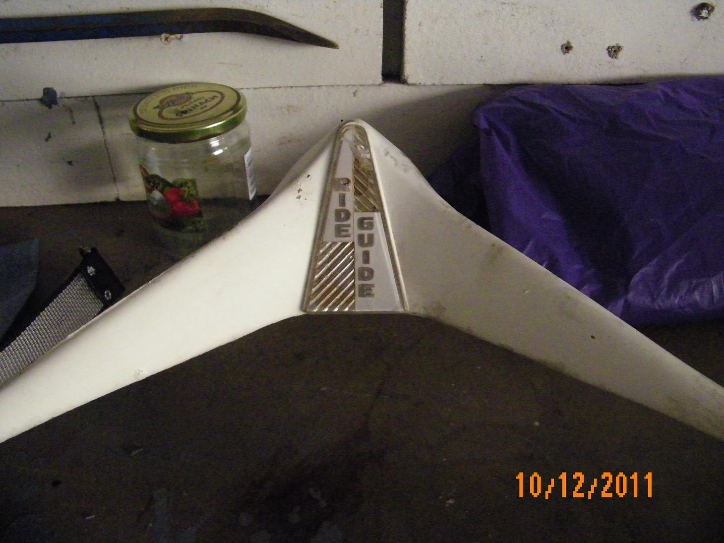

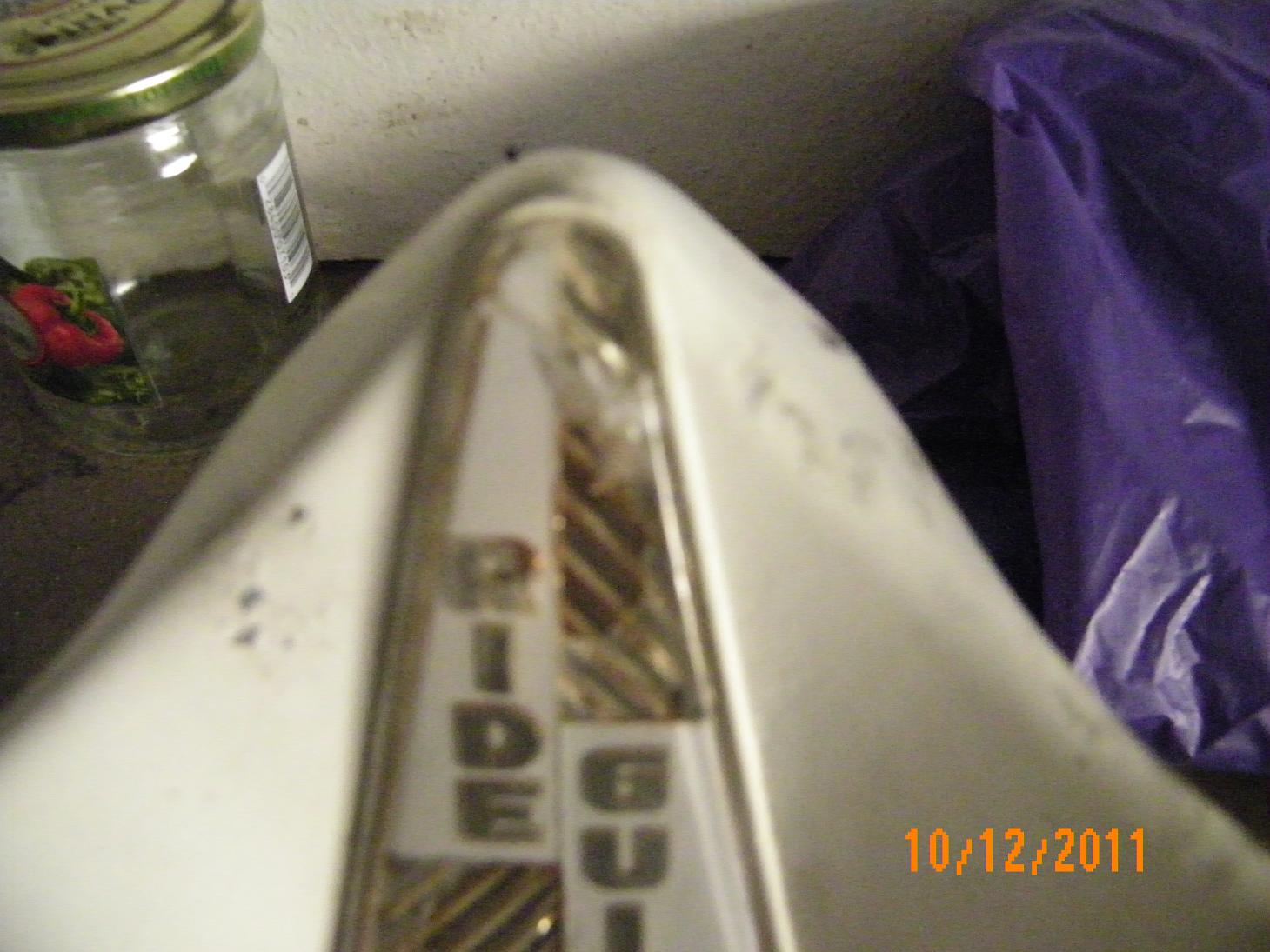

It's has a arrowhead shaped plastic insert. The insert already has a small upper portion that has been cracked, I don't want to do any more damage.

BE CAREFUL!!! The long bolt will push right through the emblem if you knock on it!!
OK so to remove the emblem, get a small fine flat head screw driver and it will pry out, work right at the bottom edge of the emblem. You might want to warm it up with a hair drier to make it more pliable as the older plastic gets brittle and might crack some more when it bends slightly for removal.
You will see under that is the bolt head for the long bolt.

I managed to pry the emblem off, came easy. I think the PO took it off way back when... It was stuck on with window putty and the bolt was flopping around. Unfortunatly the shiney stuff on the back of the emblem stuck to the glue when the plastic came off and the tip that you see in the picture was broken off. Looks like I'll be making a new center piece. I'm thinking some 1/4 clear acrylic cut to shape and rounded on the edges, polished up and with some sort of crazy emblem pasted on the inside then glue it back on. Or.... use the same cushy fabric from the seats to make a small pad like some old 50's steering wheels.
