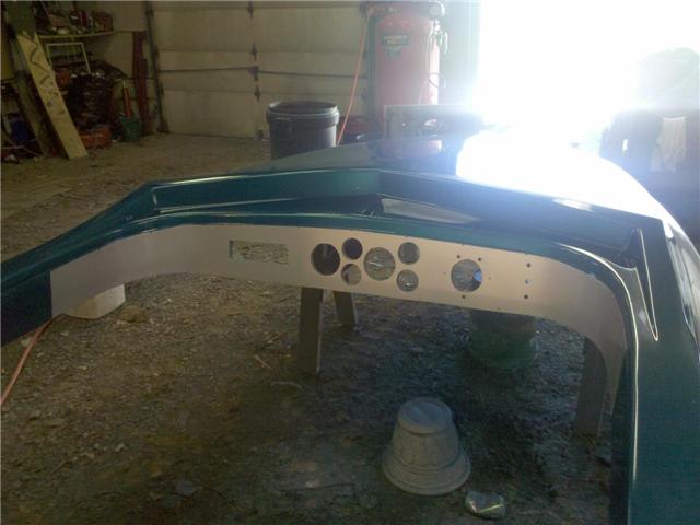

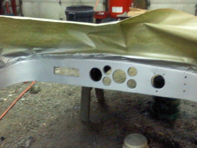

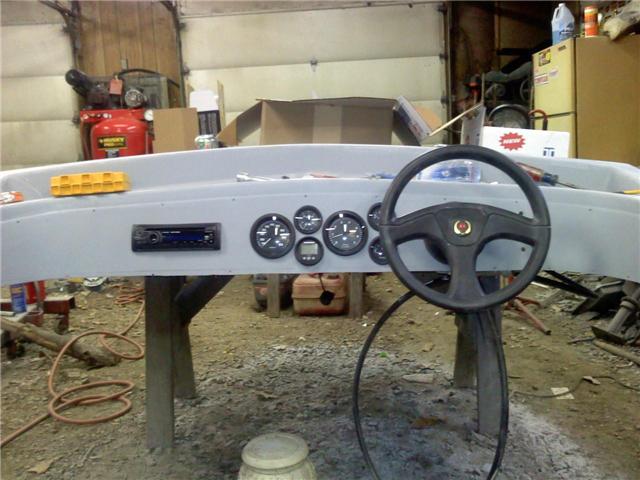

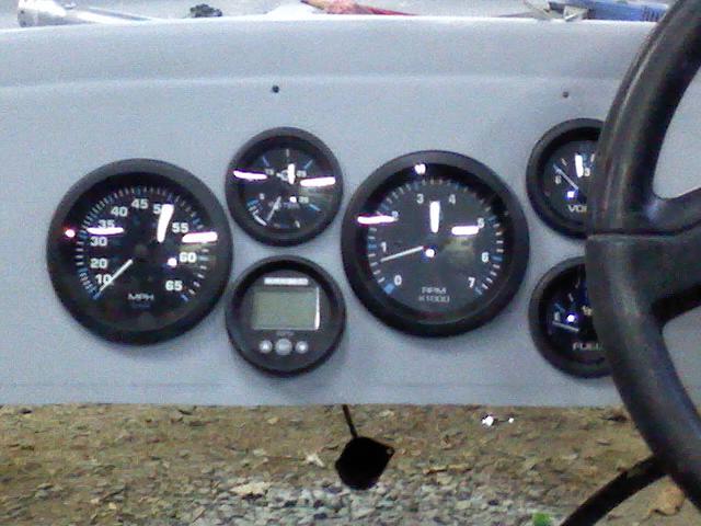

Well after five shots of primer and a ton of holes filled and fiberglass work I got to install the steering and the gauges for test fit see what ya think The old owner painted the boat with latex with a roller and a lot of it. So I made a mess of new holes. Dash is will be painted silver base clear

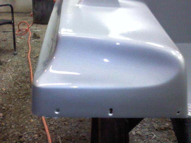

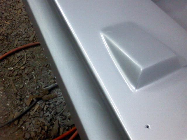

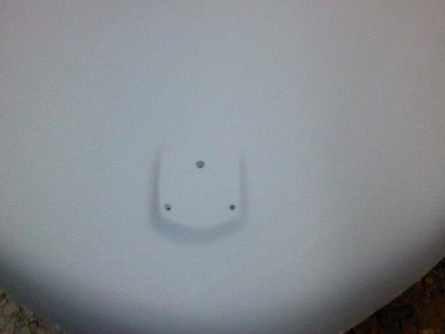

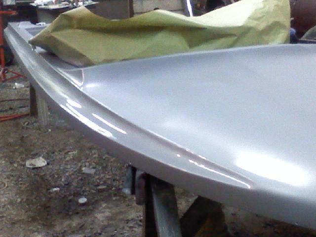

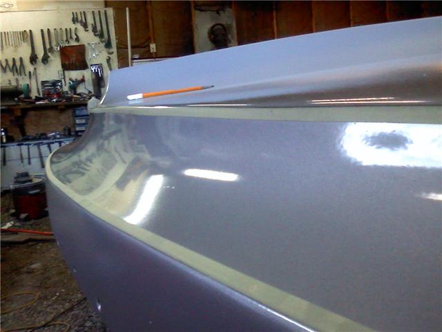

Got some pics of the paint work in lays are sprayed in silver the rest of the boat a blue green. After all this sanding and glass work it's nice to put some color to it. I am so tired of blocking. The pic of the hood is the raised bow light that I molded in. I know it's hard to see the difference in silver and gray primer.
Nice touch, I like it. Tastefully done. What's your background in, custom autobody? (The Custom Craft in your profile turned out beautiful as well.)

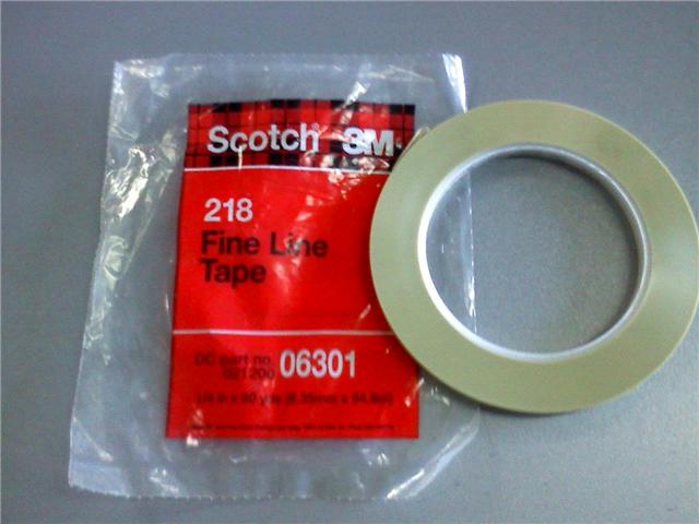

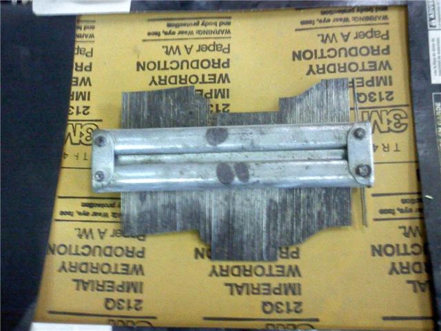

I do industrial maintenance for a living, mostly involves welding and electrical, and some mechanical. I used to drag race and still build a car here and there, so I learned a little about body work. some more tape lay out This is the tape I use This is the tool I used to profile the light makes it much easier to make both side the same

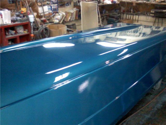

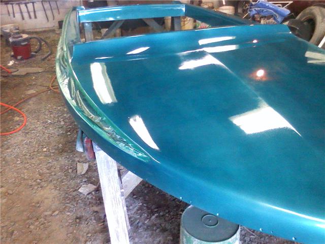

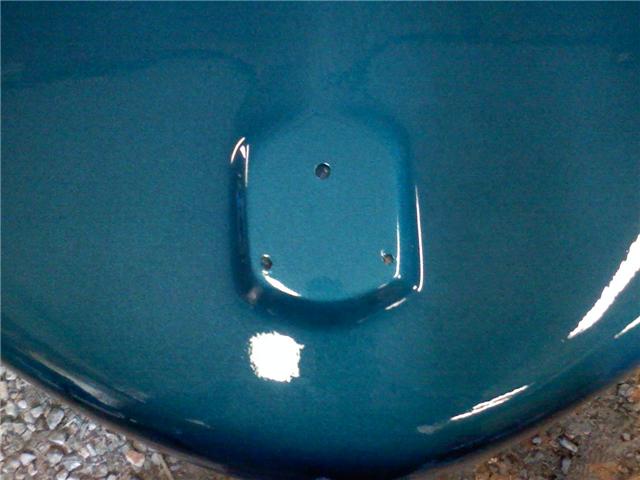

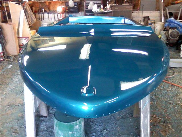

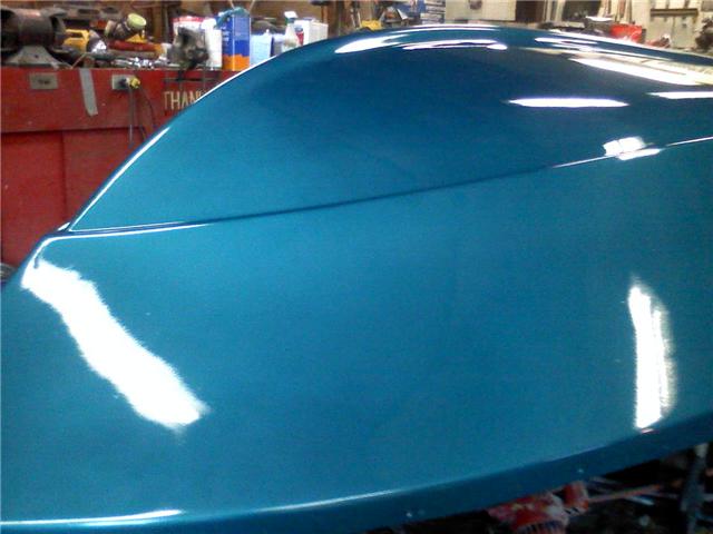

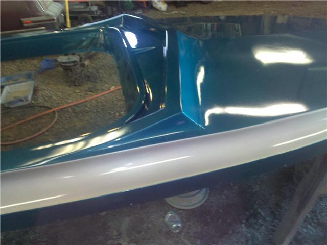

Today I am posting some pic of the color, would loved to have had worked all evening, but I have to wait to pull the stripe tape.
First coat
Second Coat
Final Coat and mist coat

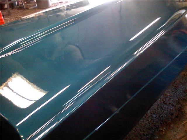

This is a close up
Re:some progress on a 67 Sears Elgin 16 years 6 months ago #5031
Man, that turned out beautiful. What are you shooting with (paint), if you don't mind my asking.
Re:some progress on a 67 Sears Elgin 16 years 6 months ago #5033
  • 67sears
  • 67sears's Avatar Topic Author
  • Junior Boarder
  • Junior Boarder
  • Posts: 108
  • Karma: 2
It's Summit Racing Brand 2k Urethane Color code Bright Aqua Pearl The base Prime was a 2k urethane gray as by Summit. I used a 1.4 tip size little small, but did the trick. The gun is just a 25 dollar Walmart special my GF got me for x mas Campbell Hosfield (works fine had to use it be cause it was a gift) miss my Devilbiss but after getting used to it I paints very nice little coarse

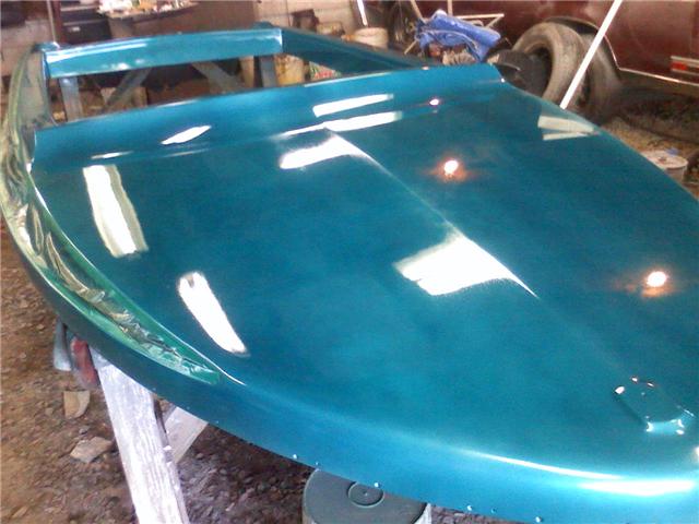

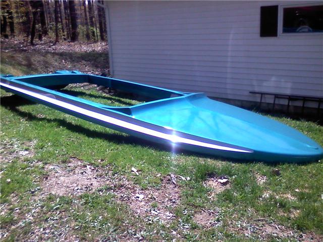

Well this is it with the paper off turned out good first time painting stripes and worked out great. I am very pleased see what ya think :) By the way thanks for all the comments
The sun makes all the difference

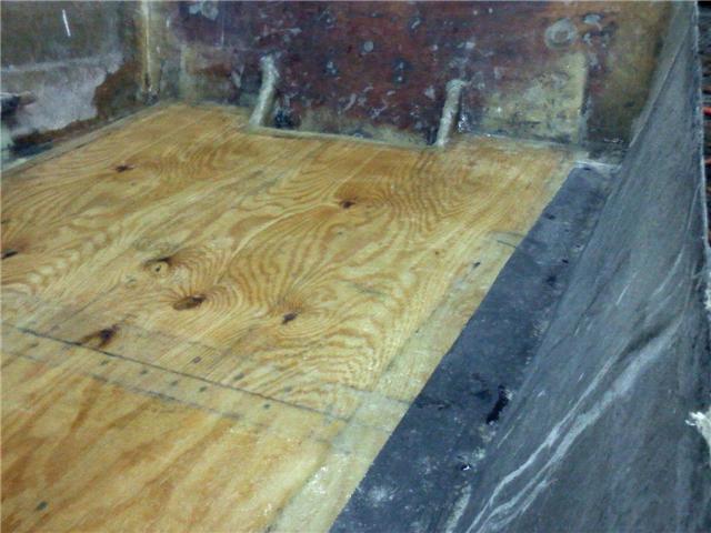

First off I wanted to say thanks to everyone on this site. THANK YOU!!!!! I have learned so much reading here and could never had did the work on my boat with out all the pics that are posted and explanations. I don't comment much cause I don't feel I know enough about the work you all do to have much to say. I did install the transom and stringers tonight after grinding for weeks all glassed with 1708. (self taught by this site so much good info here) By the way I had pics I thought but the camera says other wise get some tomorrow Good Luck to everyone else working on their projects and Hey Frank get that boat wet I am dying to see it in the water :laugh: :) Thanks again

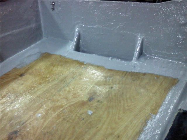

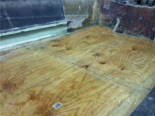

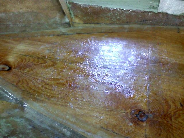

well I got it glassed stringers and transom. Some of the glass looks a bit dry between the two layers(1708 ans 1.5 mat but it was my first time. Sorry pics of the stringers fell trough but here is the deck.

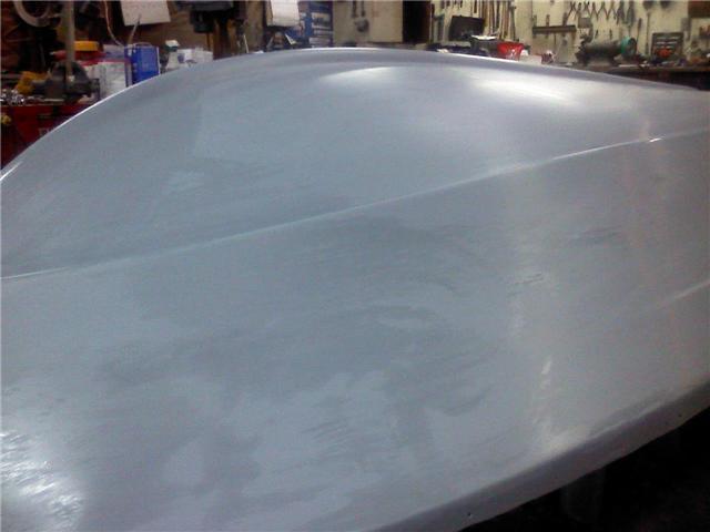

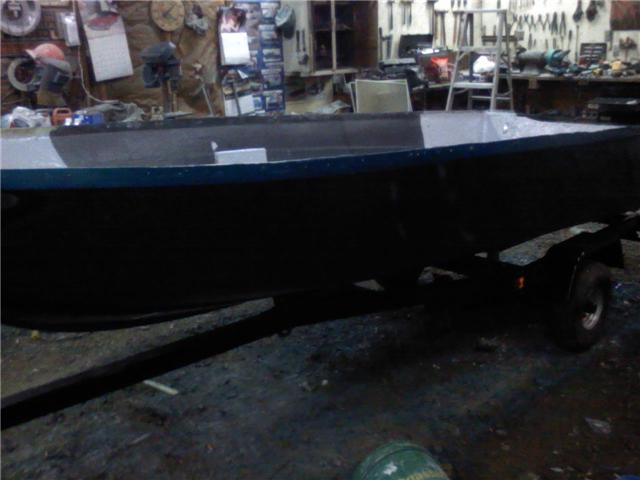

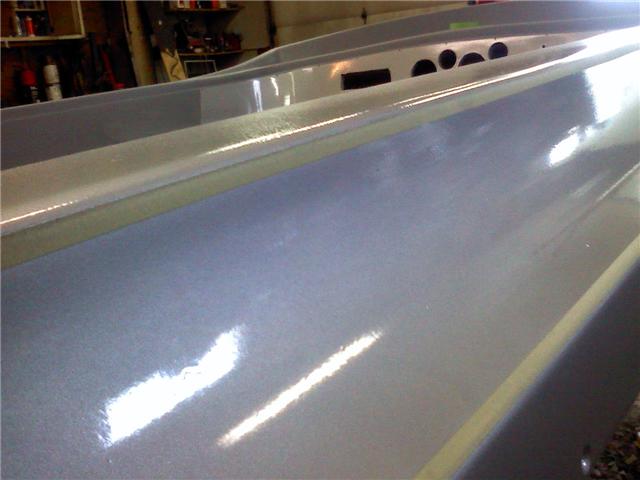

I am just up dating some progress. Here is the bottom in primer
After priming and sanding till 11am I needed some fun so this is what i did to get away and revibed to paint
Back to the grind I got the paint on the bottom shot got to bugs in it they might buff out or they will just be along for the ride So that is is where I am in progress working on the trailer here and there. If anyone wants to play boat in Western PA let me know could use a hand rolling this back over :)
