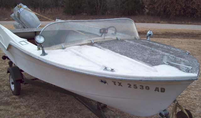

I recently bought a '59 FiberFlite with out much of an interior. I'll post pictures of what I have and what I plan to do, but if anyone has actual pictures or input, I would appreciate the in put.
This is the boat:
What I plan to do is to build two bench seats and make the boat as near original as I can imagine. That's why pictures would help. I have started building the bench seats and this is what I've designed:

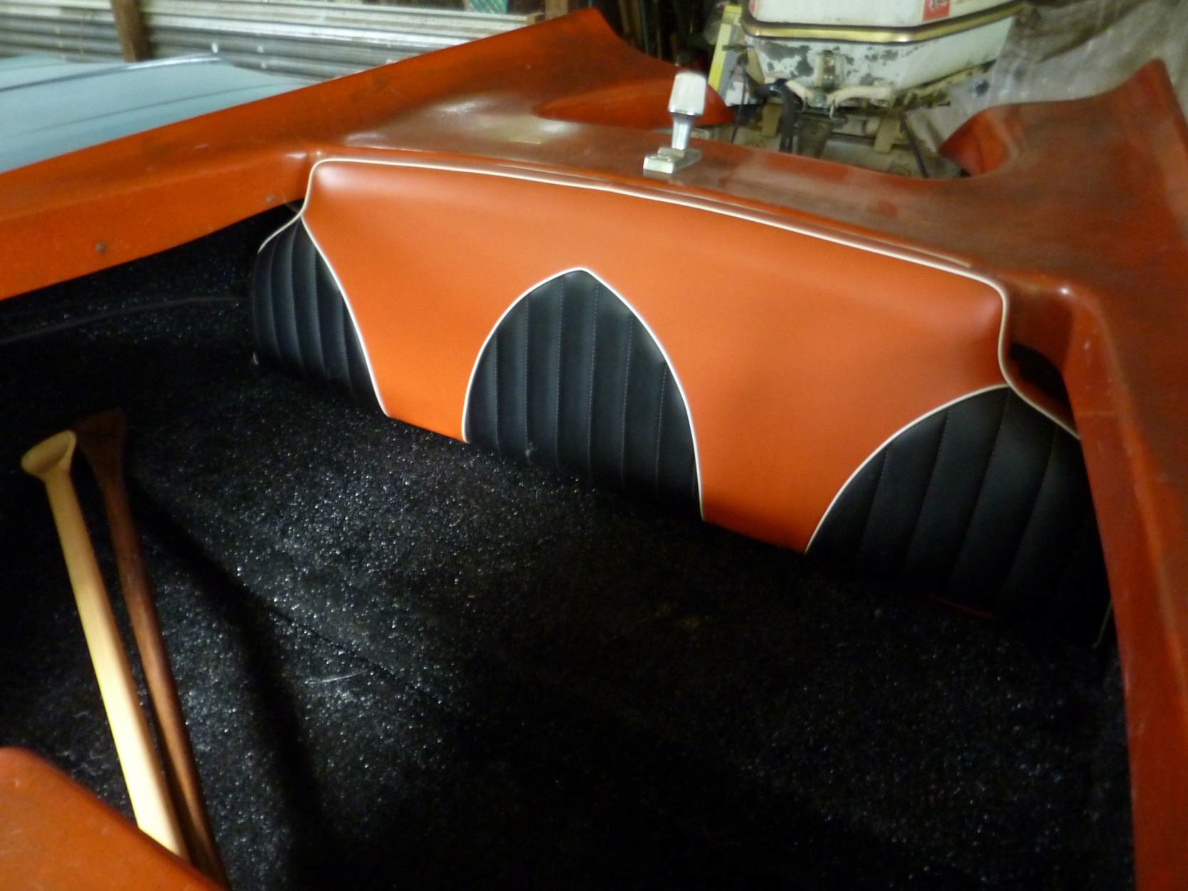

I've got the orange & white '57 pictured above. Not sure if it is accurate but somebody did a real nice job on the seats (despite what the rest of the rig looks like). I can't seem to get images posted here so PM me your address & I'll email you some pics.
Re:'59 FiberFlite Run About interior pictures. Help! 15 years 1 month ago #45872
Needed to re- size them

awesome pics. You don't know how long I myself have been looking for even a glimpse of the interior of a Fiberflite. I take it yours is a custom Deluxe model? Any other pics you can send my way would be greatly appreciated. Expecially the dash and the storage area in front.

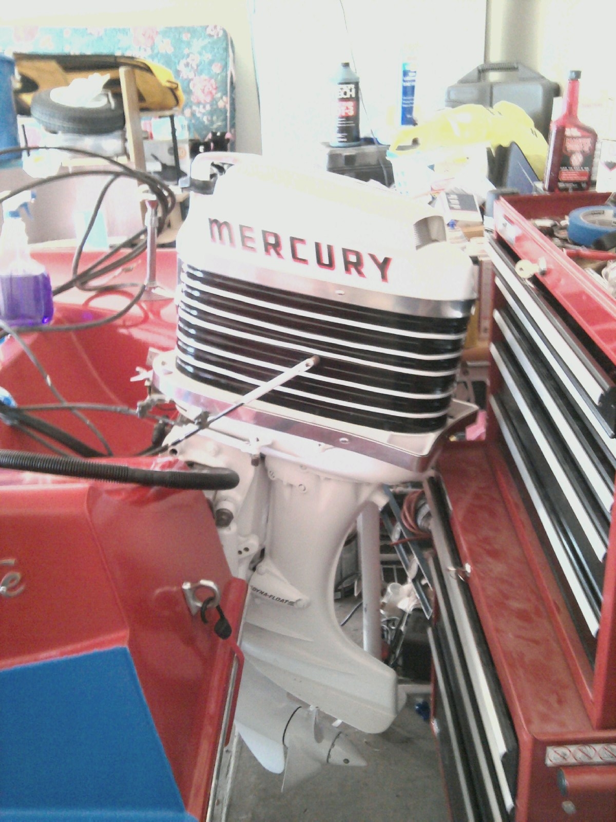

BTW, here is what is going to power this boat.
