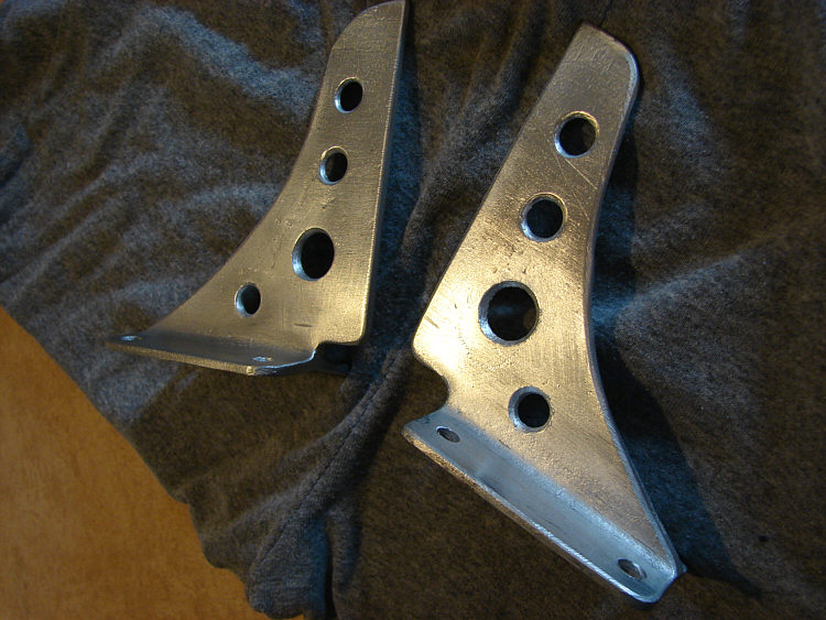

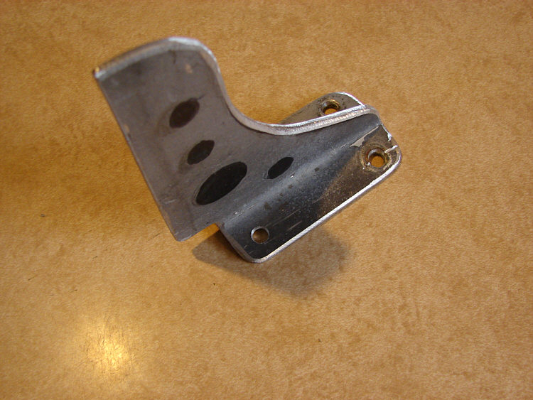

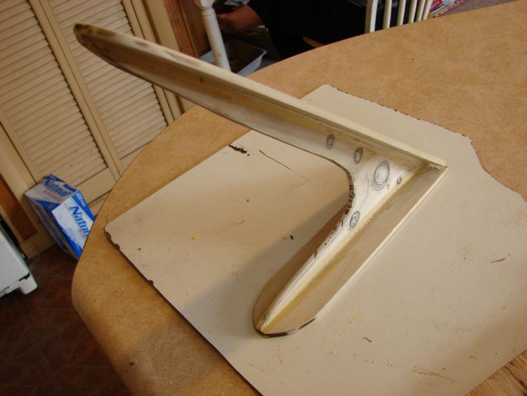

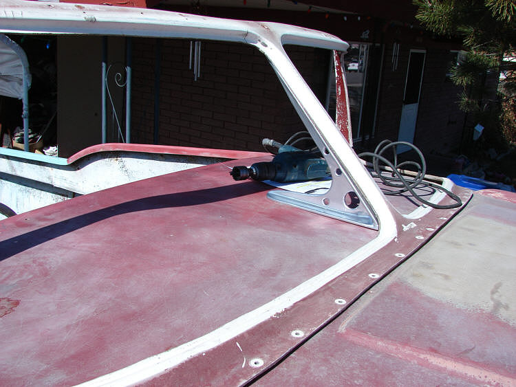

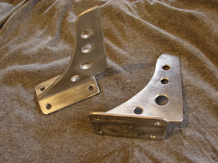

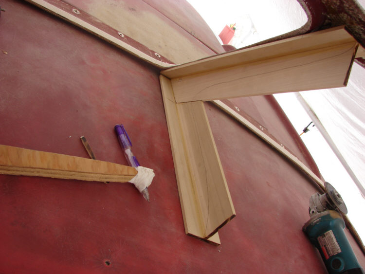

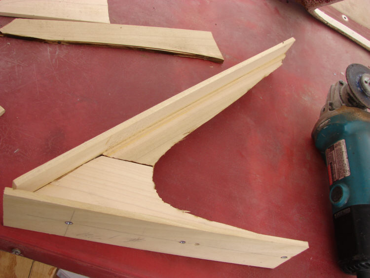

Anyone remember that special windshield brace I fabricated? Well, I got another idea today for the side ones.
The idea here: to show you that it's not all that hard to come up with a nice customized piece for your boat. If anyone wants more details, just chime in.

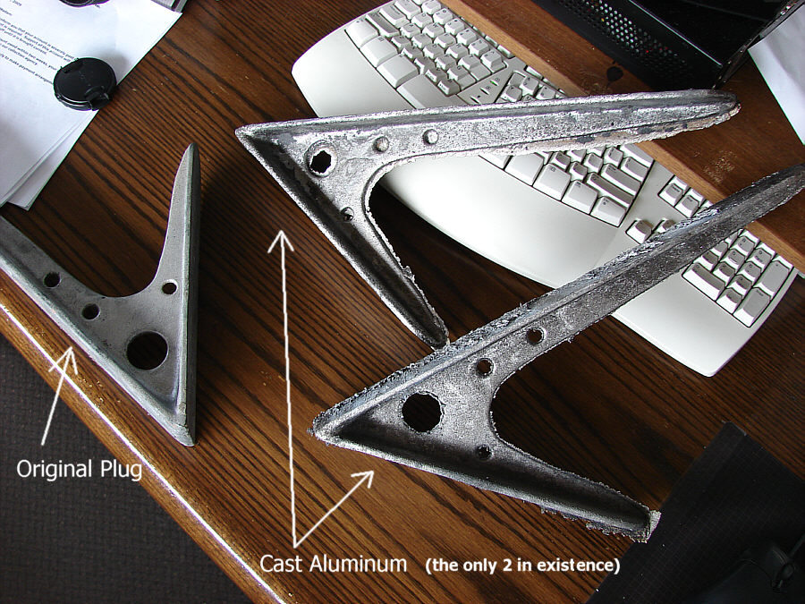

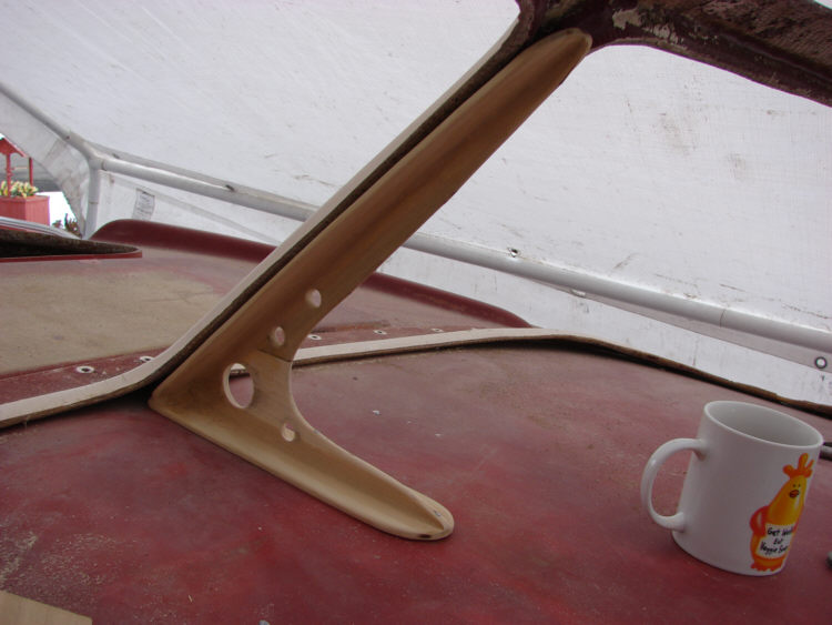

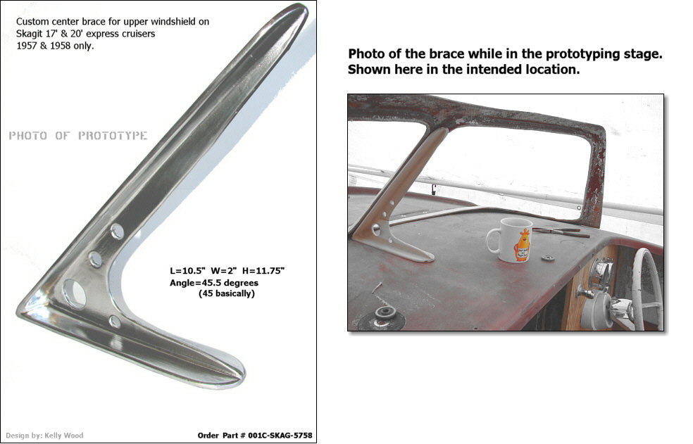

See the first 8 pics. They're of the 1st center windshield brace I made up. I made the wood plug (the original prototype), then took it to a foundry and had them cast it in aluminum.

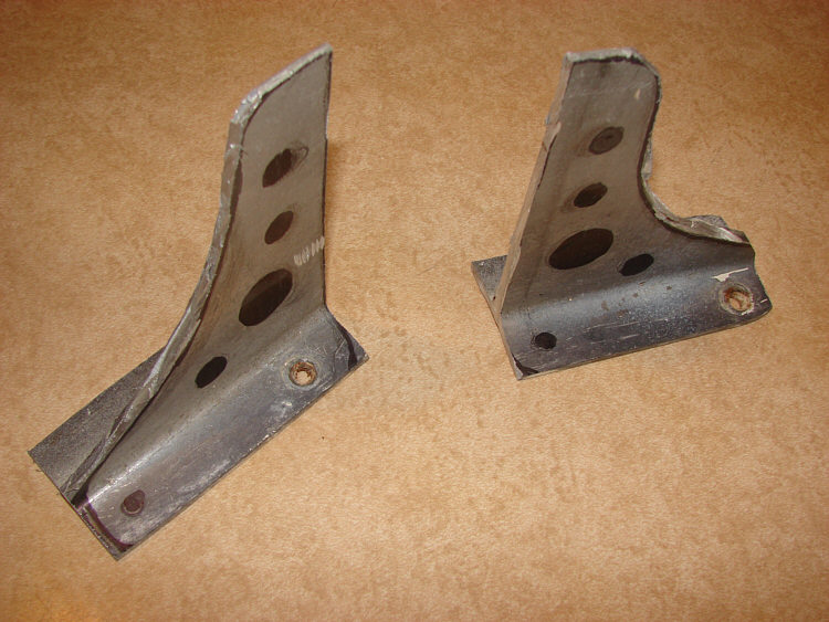

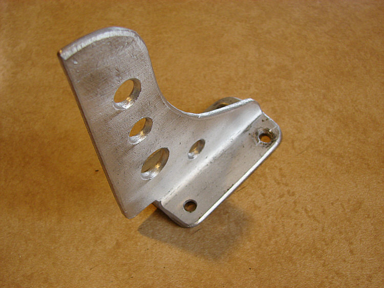

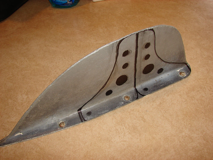

Next... the side braces I came up with using only 1 old discarded part. An aluminum skeg (fin) from an old boat. There was enough left over to make a small fin for my hydrycycle to boot@!

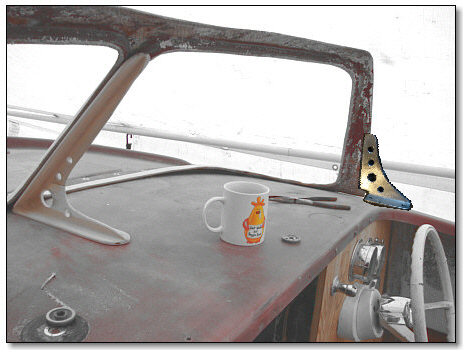

The last pic is a photoshopped placement of these side pieces.
Enjoy
And the lame photoshop job showing where they go.
or, I guess you could use them as bookends if you wanted too. I dunno.

You'd have to be more specific. The large center piece was a limited production run for the Skagit Owners. Only two were made and cost 150 each. The side pieces were just additions to the center piece and I was merely showing what I did to make them.
If you're interested in the center pieces, I'd have to get with my foundry to find out another pricing schedule for another run.
