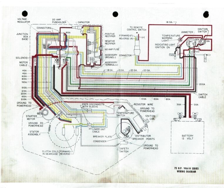

Re:Wiring diagram ? 15 years 1 month ago #45167
how's this.

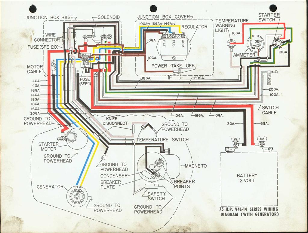

Re:Wiring diagram ? 15 years 1 month ago #45330
this is the diagram i meant to post,got them crossed up. one big difference is the ignition switch for mag and battery ignition are different. hope this helps
