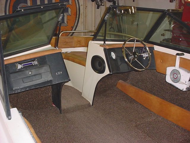

Re:1982 Ebbtide stringer construction? 16 years 4 months ago #4543
Nice looking boat Doug, what is she, about a 17 footer? Are those speakers in the passage to the bow section? Would like to see more pics when you get it back together, okay.

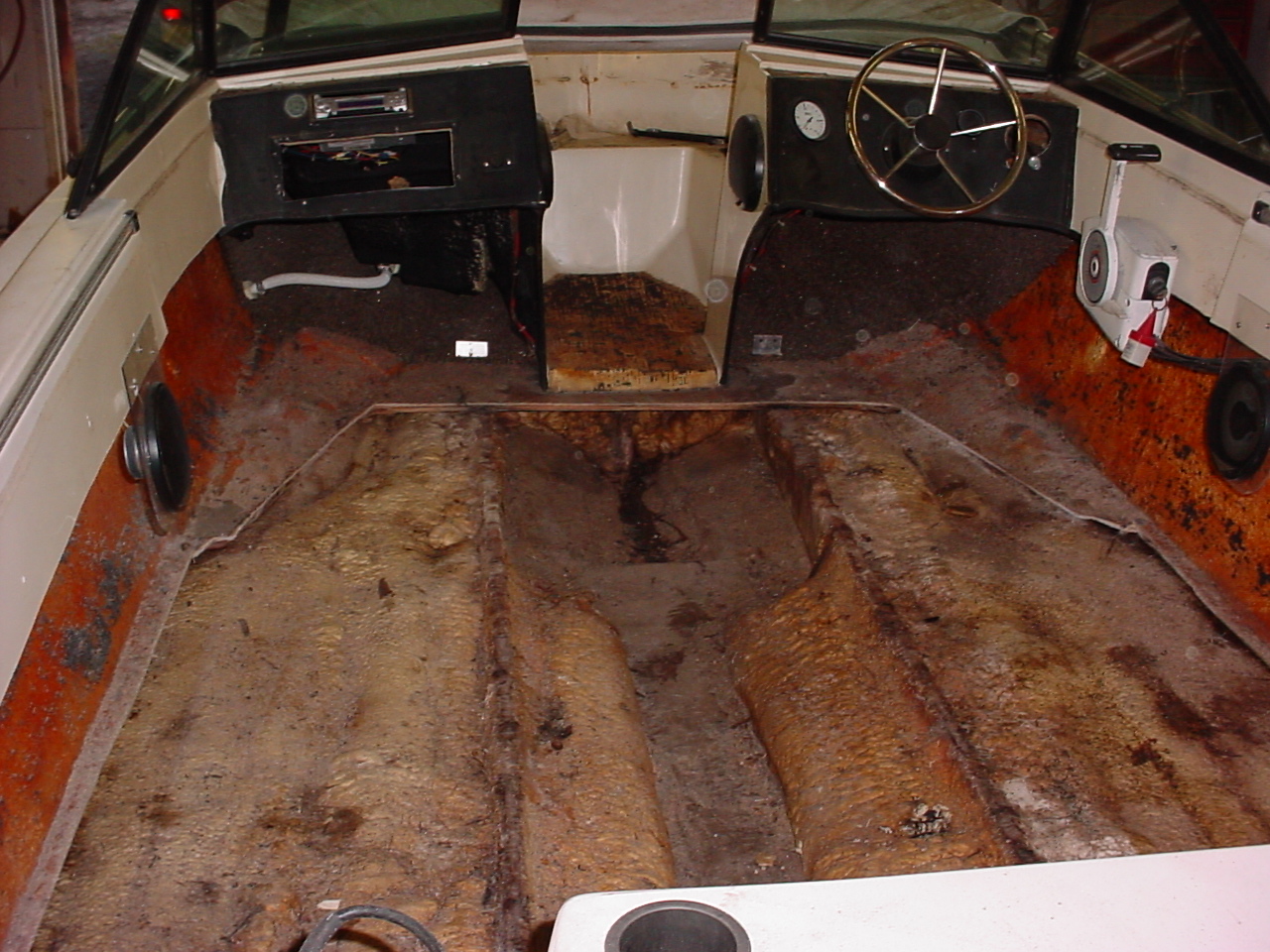

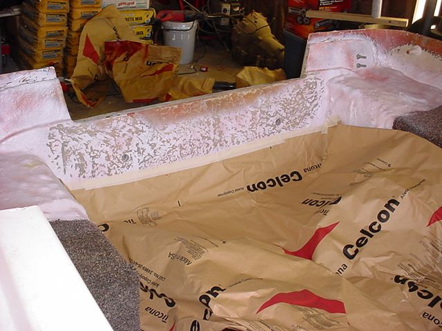

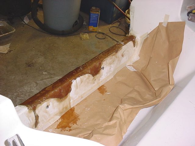

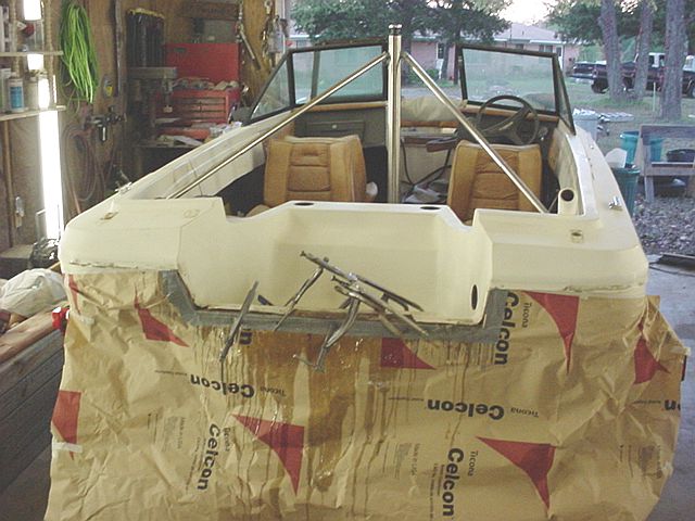

Tore into it this afternoon. Stringers are wood and encased in foam. Even better the foam is good and the stringers are rock solid. I got lucky on this one. Should be an easy fix. Probably going to repaint it and go all bright yellow instead of pale yellow/white scheme that is on it now.
Thanks Mark,

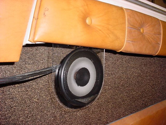

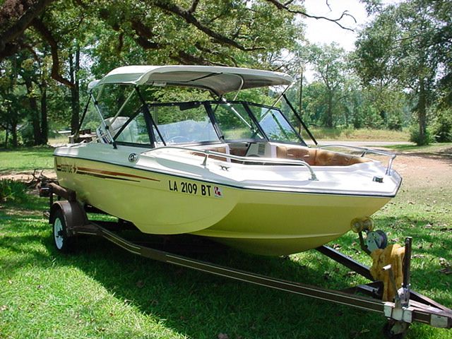

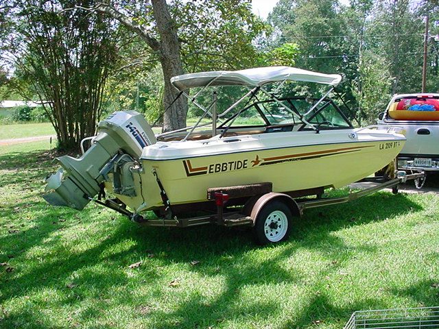

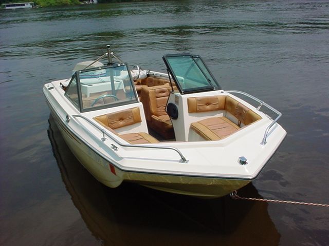

It is a 17 footer, I bought it about 3 years back without a motor. Put a transom in and and used it for a season then fried a cylinder or something in the 140 and parked it for the last 2 years. I'm not sure what happened, I think it lost fuel and starved a cylinder. Got it to fire back up on 3 and made it to the dock, loaded it up, and took it home. Never pulled the cover off of it till last night. lol We'll see.. I've got a 90 Merc, a 115 Merc, and a 105 Chrysler so I'm niot sure what I'll put on her just yet. It's rated for 105.
Those are speakers. Two 6x9 Pioneers up front, and two 6" round pioneers on the sides farther back, witha Pioneer am/fm/cd player and a power antenna. It's a nice old boat and I love the ride. It's a shallow V design, but almost looks like a tri-hull the way the sides droop down in the front. Really stable.
Here's some more pics.

Glad to hear your stringers and foam are in good shape, from what I've read on your projects you'll have this one back together in no time! The interior is laid out very similar to my 73 Starflite, guess that's one of the things that caught my eye. (From what I've read over on CGOA, the Glastrons were bad about floor and stringer rot too, guess I got lucky with mine!)
Love the padded backrests all the way around the inside, did you add those? I plan on doing an interior upgrade/redo this winter, always looking for ideas. B)
PS - LOVE the grin on the Li'l Captain's face standing at the helm!

Thanks Mark,
The side panels are original to the boat. I'm not sure how fast this one will get done. I'm unemployed right now so money is tight. I need two sheets of plywood and some resin. Donations anyone? LOL :lol:
