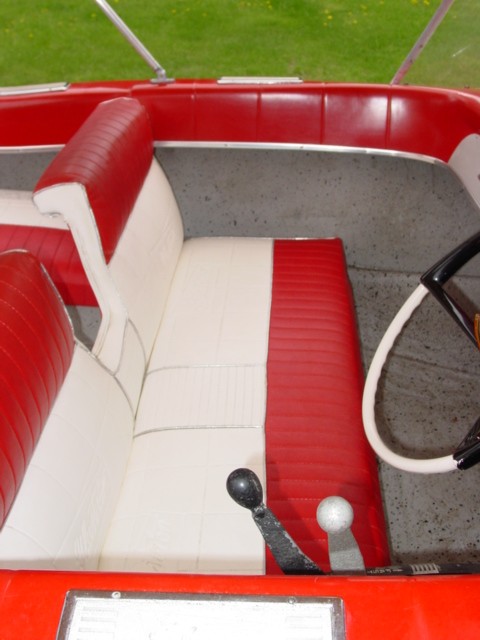

Mine needed extensive work. Here's a few pics ( not my boat)

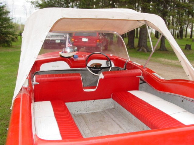

Couple in KY picked up a Fireflite friday & just posted on CGOA earlier today. Can't tell from the pic if the seats are origional but might be?

Here's a couple more of Bob's old Surflite. I could only load two pics last time
Bill
Re:59 Glastron Fireflite Seats 16 years 5 months ago #7032
Now it will only let me load one
OK I give up

Re:59 Glastron Fireflite Seats 16 years 5 months ago #7086
Thanks BB - that's a great shot - it will help along with some of the others I've found.

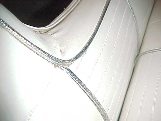

I'll try this one more time
OK just e-mail me & I'll send you the other pics
Bill

Re:59 Glastron Fireflite Seats 16 years 5 months ago #7161
Thanks - got both pictures and they are very helpful. You guys are awesome. Gonna post pictures of the restoration and finished product as I progress.

Great pictures - Now if anybody has good shots of the rear seat of a Fireflite - these are from a Surflite (side seats) - then I would be all set. My memory suggests that the Fireflite rear seat back had some curvature to the side to fit to the "gunwhale" and rear hull shape. Some of the recent redos don't seem to have done that. Wondering if anyone has any recollections of that rear seat and, of course, additional pics. I know I'm being picky but >>>>>>>>> hey gotta try !!!
