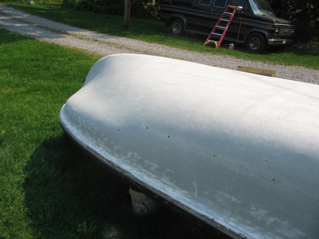

My 59 and 60 Crestliner Arabians are both origonally balsa core. The 59 core was water logged and the 60 is still water tight.
I removed all, including transom and used 1/4 ply sandwitched between glass and epoxy, 2 layers on the bottom. I had to shape the ply and curve it to fit the hull. It's very strong as was the origonal.
Key is to keep water out.
