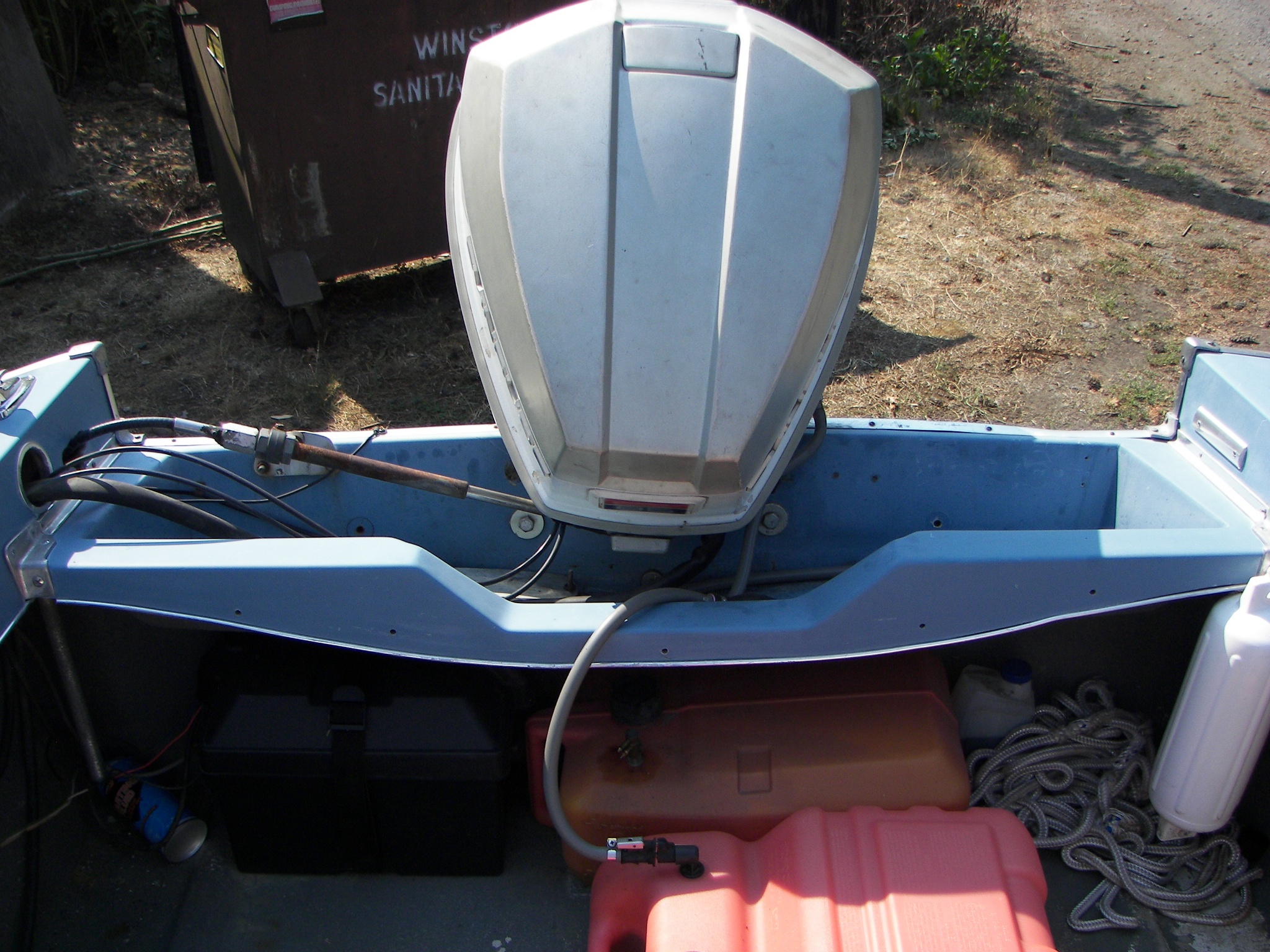

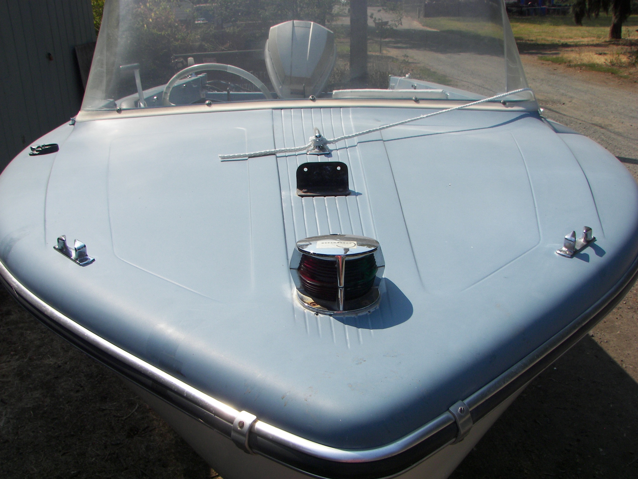

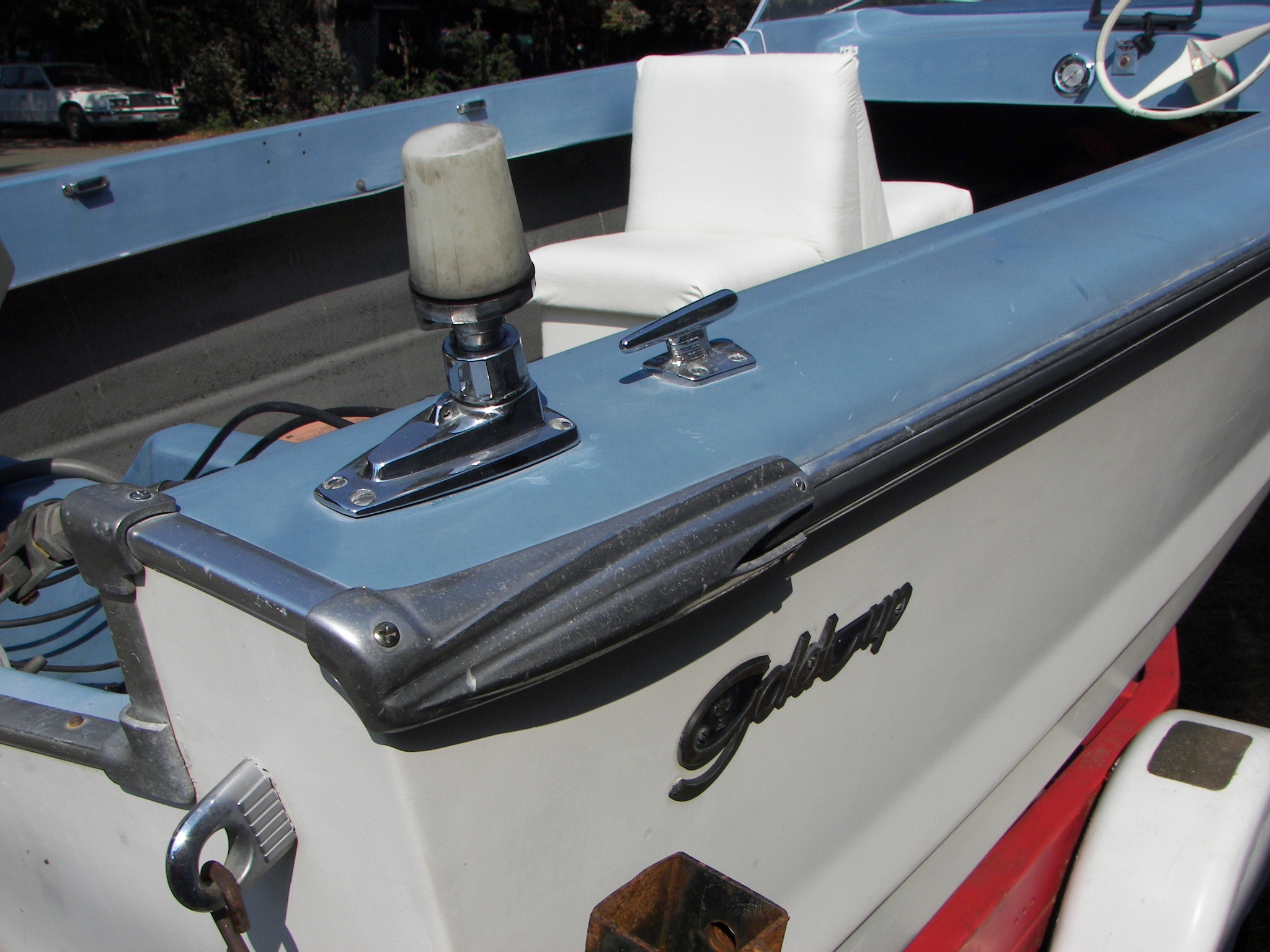

Got the pictures added. Hope someone can help me out. Also the motor is a 85hp Evinrude not sure of year and the length of the boat is 15.9' per title.

The boat is a Glasspar. The "Gold Cup" line of Glasspar was their entry level line.
"WAZ" is state of Washington assigned hull ID conforming with the US Coast Guard Manufacturer's Identificatiuon Code (MIC). It has NOTHING to do with the manufacturer of the boat.

Good (and QUICK!) job on the pics, nice looking boat too! Looks like a wet sanding and buff out may help considerably, plenty of time for that during the off season. ;)

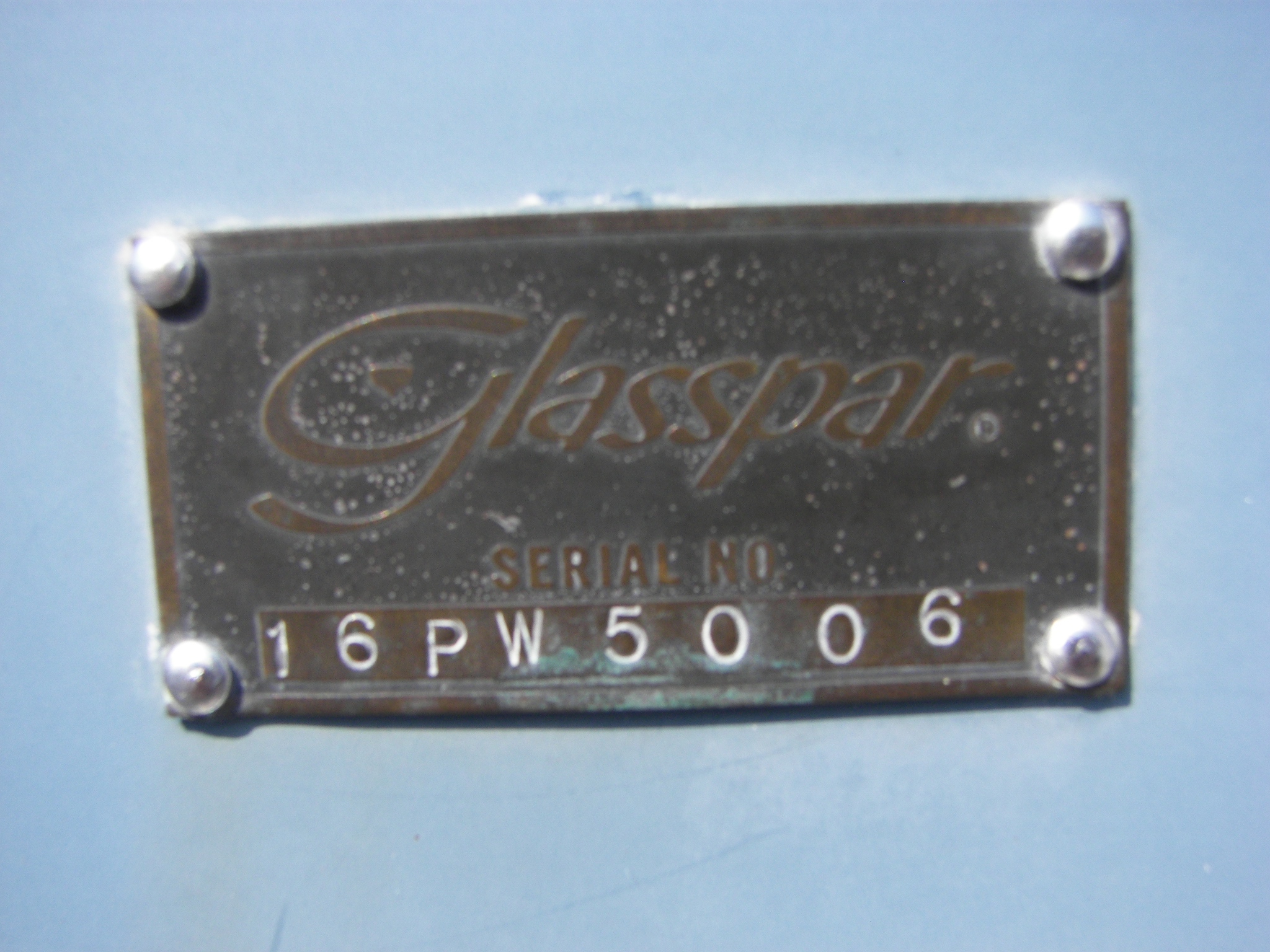

WELCOME CHARLENE. CONGRATs on a clean Glasspar . That light blue color was used by the truck load in early 60's ... As the small brass tag
states 1965 , "W" for made in Washington , serial # 004 .

Split thanks for color and the Glasspar club info. I'm still not sure how to read the serial number which is 16PW5006. Do you know if there is a website on serial numbers or how to read them?

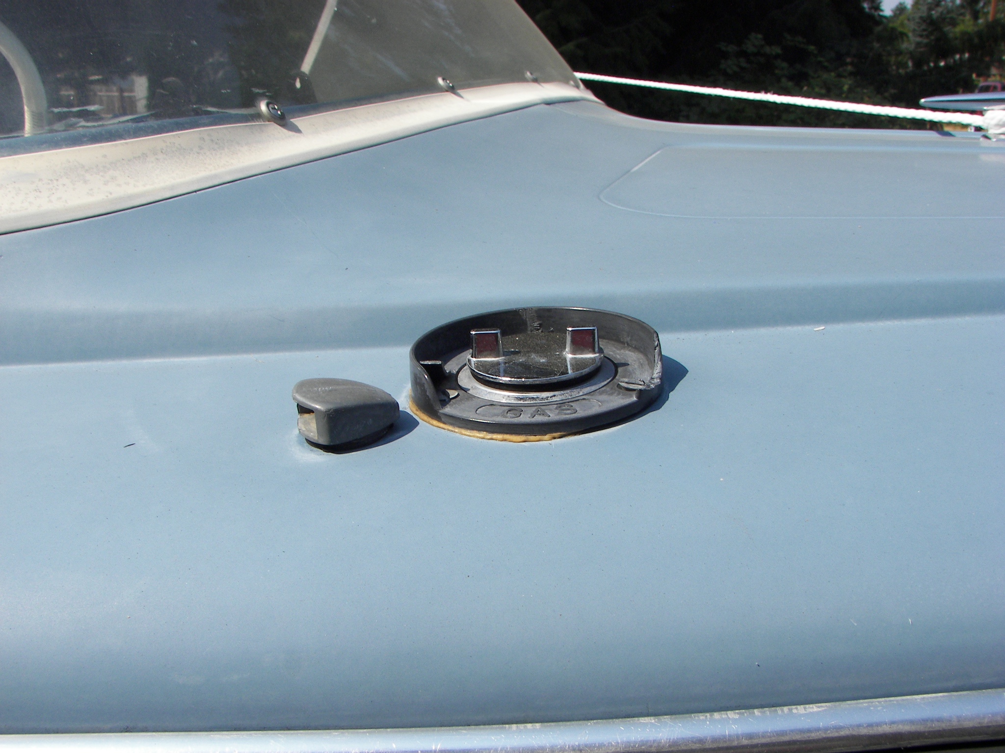

One more thing while looking thru the brochure I didn't see any that had a gas tank in the front. where mine was located. Just tying to figure out if it was added later by someone else. If I wanted to ever hook it back up are there cons about having the tank in the bow of the boat. Here is a picture of the gas cap and location.

I bet the bow fuel tank and filler were added by a dealer or owner.

Glasspar serial numbers during the early 1960's read out information as follows. First 2 positions indicate length (rounded off now and then). Next position indicates the model in one way or another....no Idea where the P standing for the Gold Cup model came from...sorry. Next position indicates the plant the boat was built in...W for the Olympia, WA plant. Next is the last digit of the year it was built. Glasspar did continue as a brand after Larson Industries bought them but the numbering system changed during the '65-'66 production runs so the 5 in yours is indicating that it was built in 1965. The rest of the number indicates build order....so that boat was the 6th Gold Cup built in the Olympia plant in 1965.

Charlene, usually Glasspar brass tag had a "X" next to the length of the model, IF only one name for that length. Like 13 ' was the G-3 . Your 16 also shared with Citation , Avalon, & we see other 16's in the brochure above. Again CONGRATS looks like your hull was 006, very early in the production year.

Rod-B Thank you for breaking down the SN numbers for me. You explain it perfectly for me.

I was thinking the same thing about the bow fuel tank and filler. I am still trying to figure out the pros and cons for have the fuel system in the bow. If it is not a good Idea or safe to have the fuel in bow of the boat then I will remove all the hoses that are still connected under the bow hood. It will be some time before I can start to restore her but figures I could remove the hoses and leave the cap until I start the project.

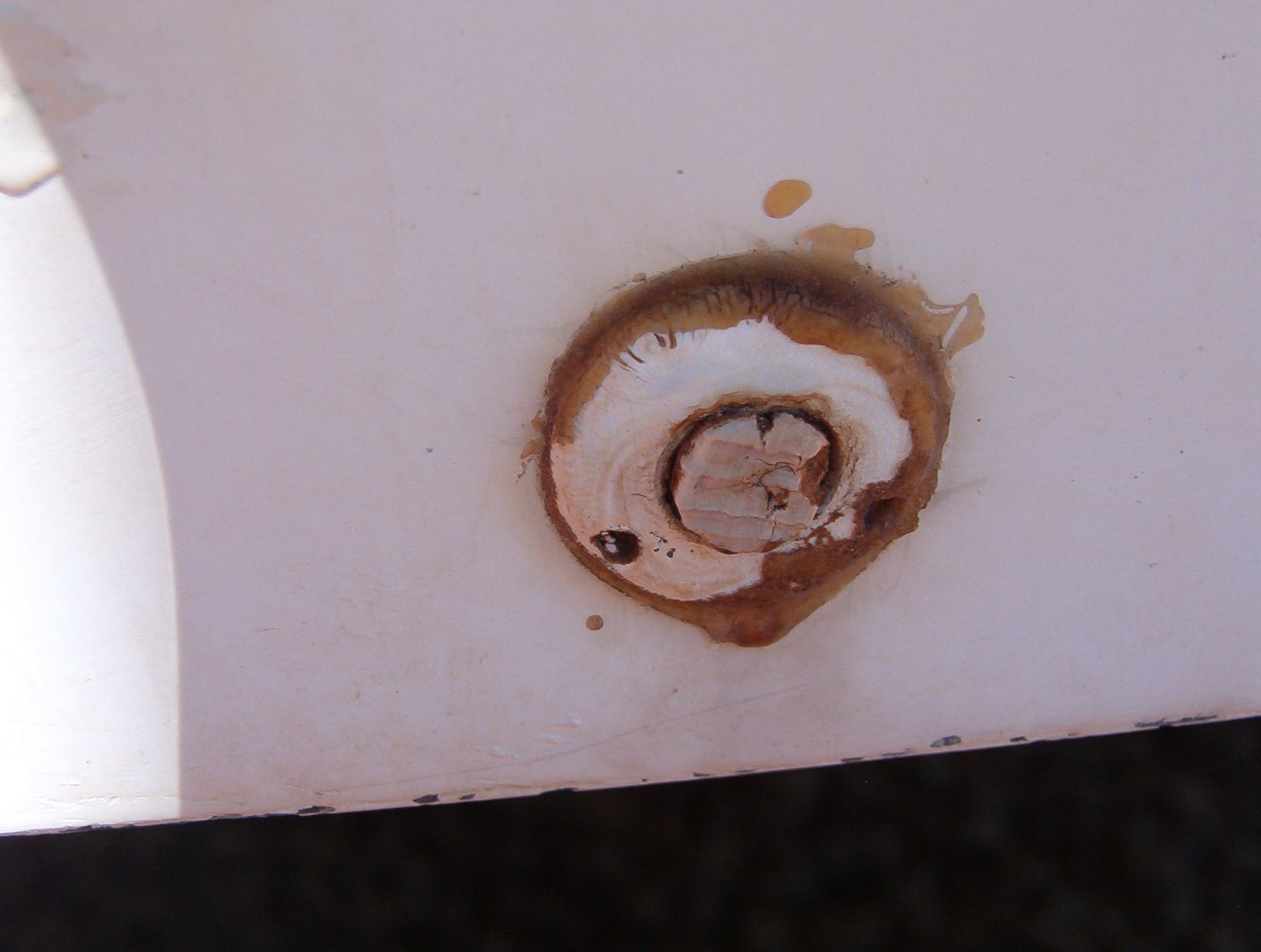

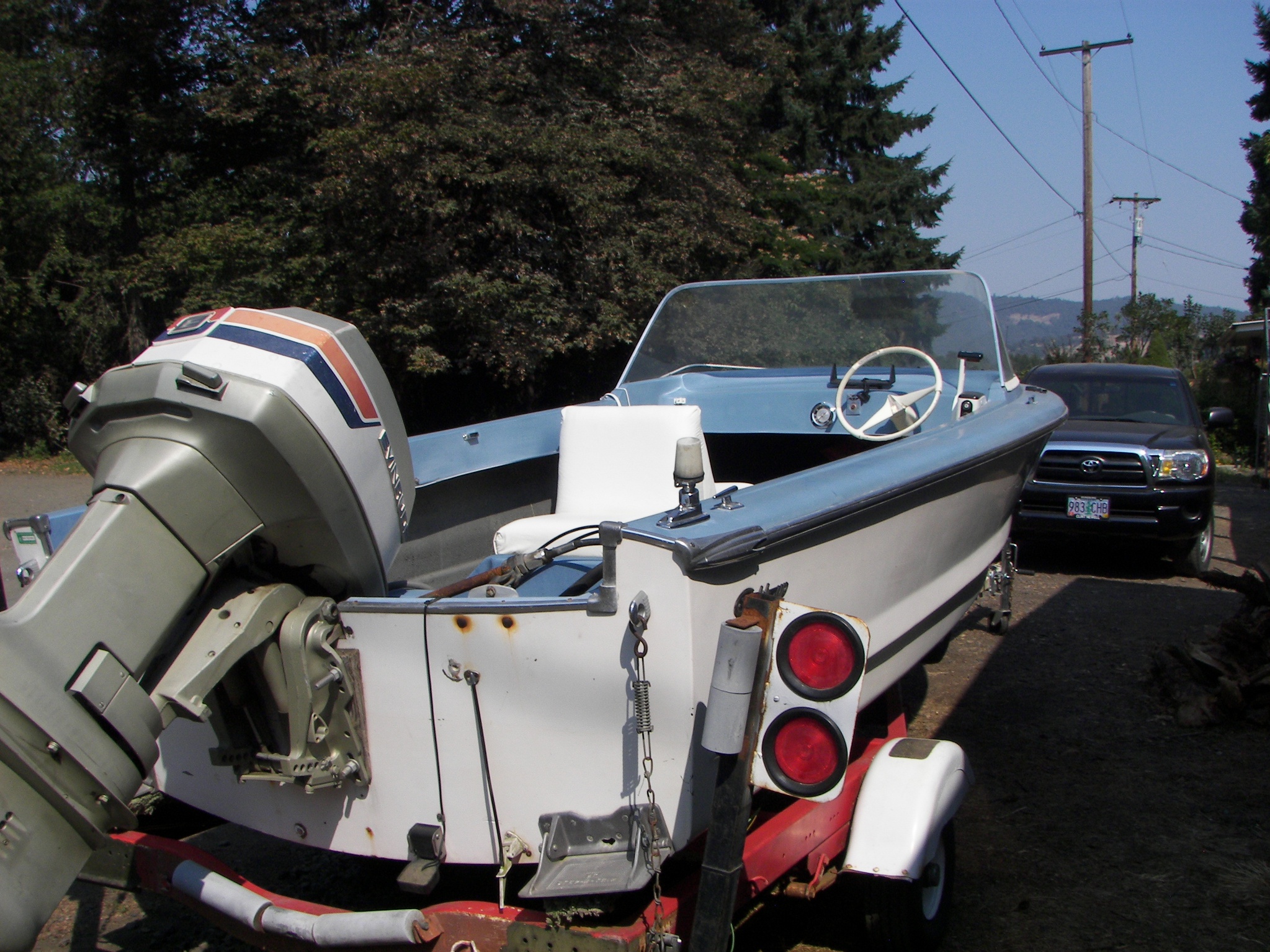

Question about the drain plug. I am not sure if this is the drain plug and someone sealed it up or if this style of boat doesn't have one.
Also, I have an Evinrude 85hp Model #85493-B SN#J0004131 can anyone tell me the year and maybe what it is worth. I think it is to big for this boat and thinking of getting a smaller one.

...YES, That very bottom round fitting should be a THreaded drain plug.... We had the same one on our 62 Glasspar Sedan model . My 67
Sedan has the smooth rubber plug for the brass tube... All boats will get rain in some day , so a drain outlet is necessary..
. Most likely the threads got striped & prior owner made a patch.
... Also my current wood transom went bad with a crack as the inside wood all wet from maybe top side seepage over the years.. I have the same TWO Bolt steering bracket on inside of splashwell. &
I found those bolts to be only 1/2 the diameter / thickness as new.
Actually one snapped in half when I put the two wrenches to unbolt.! ( Pic BELOW.)
... We see brown rust at all your metal rear fittings. Yes this 85 HP could be a tad heavy for your 16 ft. Maybe find a nice 17 1/2 ft Glasspar with a smaller 60 hp & swap motors.! . You really need
to find a trusted friend & tap / probe your transom for strenght, & or drill out fitting & make new brass flair pipe & caulk for leaks.. We see the top housing may have been Cut OUt for that motor riggging.? another source of water inlet.

I don't have anything around here new enough to get a year from the model number but judging by the hood it seems to be a 1974 model. Value? Real hard to say not knowing what kind of shape it's in. Pretty much have to check one over in person to get an idea of that. Weight should be right around 265 pounds or so...maybe a couple pounds over that. Sounds like a lot but not bad for the power rating compared to a new outboard. If you don't feel the need to go very fast you could stick a 2 cyl outboard of the same vintage as the boat on there at maybe 100 pounds lighter...would need to get matching controls for it. The 1960's Johnson or Evinrude 40hp might move it along in the mid to high 20's depending on how much of a load you stick in the boat and what prop works best for your needs. If you don't care about matching the years maybe a newer 55hp twin or even a 70hp 3cyl would be a nice match. Would use less fuel, too.
Re:1964 Glasspar Gold Cup 15 years 1 month ago #44985
Personally, I'd leave the 85 on there.
I've had two different motors on my Gold Cup... a 1957 Johnson 35 and a 1959 Evinrude "Fat 50". The 35 REALLY struggled to push this boat along. Low 20's top speed at full throttle, at best. When I stepped up to the 50, I gained a good bit more performance and at sea level, I can get 32 MPH with a light\moderate load. Sometimes, I still wish for something a little bigger though.
The 85 on there should push you along 35-40 MPH with a low 30's cruise. Perfect for that boat, in my opinion. 65-85 HP was the standard offerings with this boat. Not to mention, those particular series of V-4's are fairly easy on fuel if you run them prudently and are bullet proof if you maintain them. I'd leave it. ;)

Split I have a friend who is going to go thru the transom with me. Open up the drain plug and make sure the strength is there. After I read you your post I went and took a look at the back end and it does look to be cut out for the motor. That will be a definite fix.
I am going to have to think about the motor some more and decide just what size I want to put on her.
