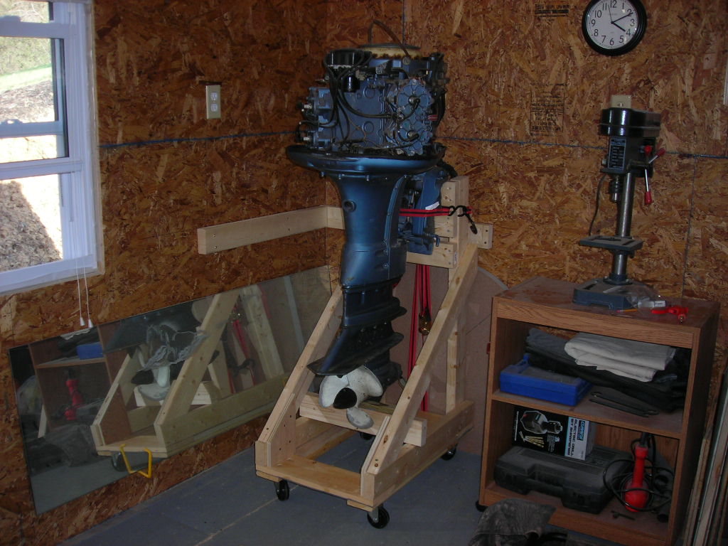

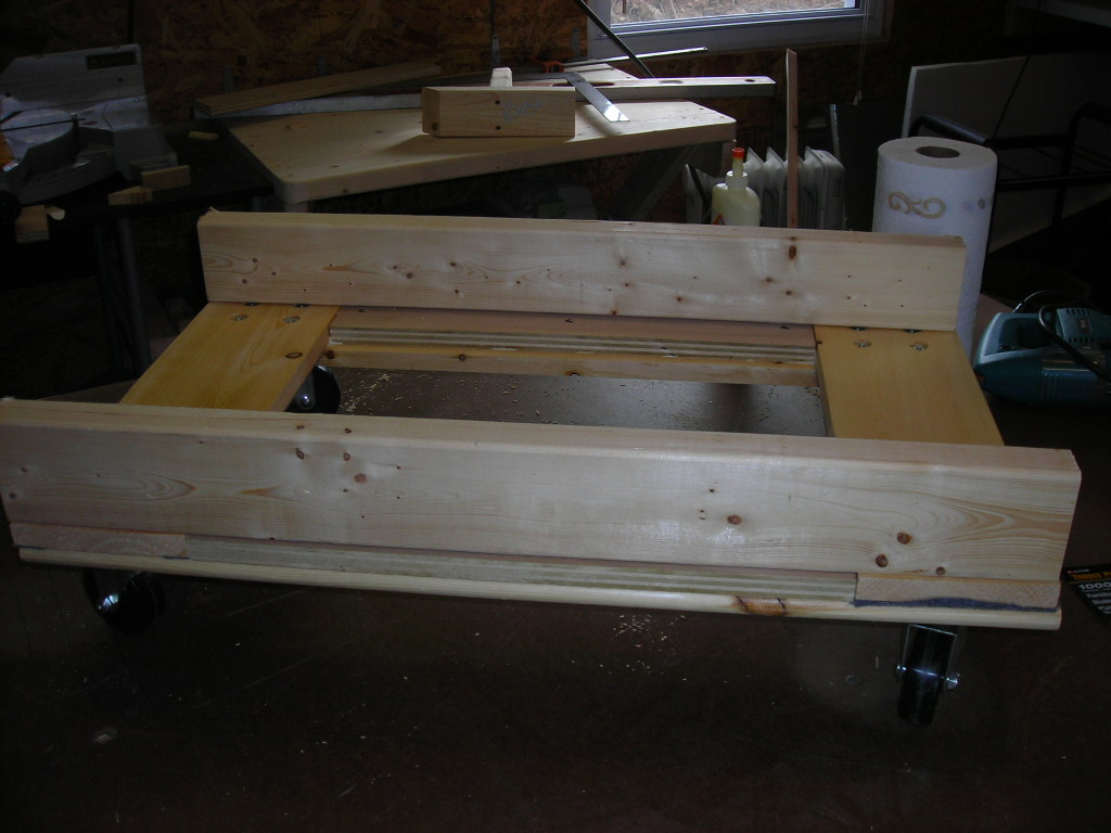

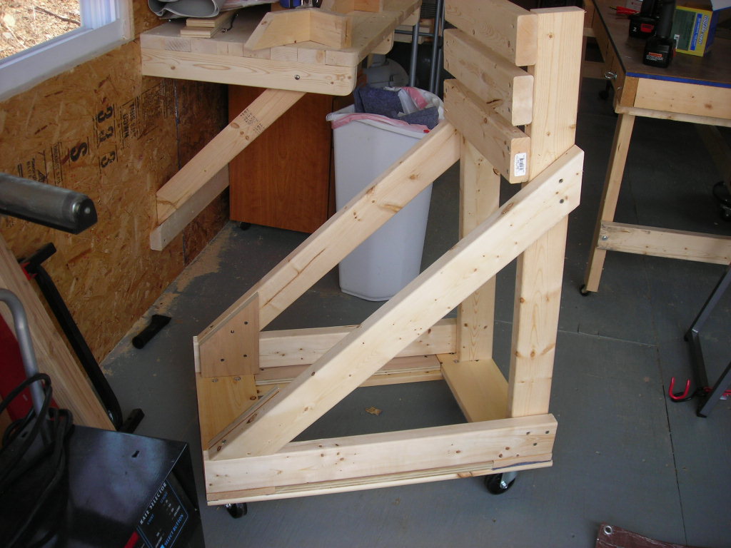

thats cool,heres the motor stand i made out of a 20 dollar ,1000lb ,movers dolly,i sloped the uprights by cutting a 5 degree angle on the bottoms of the 2x4s. i also added 3/4 plywood to the dolly,then glued and screwed it together,i made it a little higher then needed,but then i put a 2x4 under the motor and shimed it up to take some weight off of the uprights.please dont pay attion to the 2x4s on the wall in the last pic,they are for a corner table that i removed to make room for the motor,a 75 hp evinrude.
