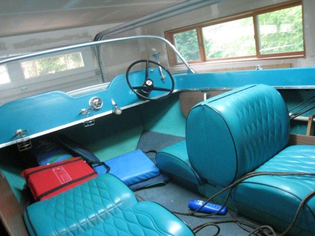

Here are a couple of pictures

Welcome Glen, good to have you aboard. Looks like you found a very nice example of a Glassic there, congrats on your new ownership. We'd love to see some more pics when you get a chance, we love pics around here.

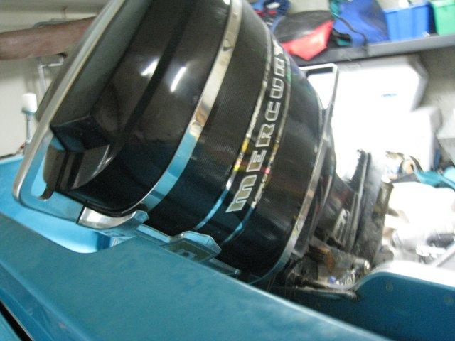

Re:My first boat - 1969 Fiberform Runabout 15 years 2 months ago #43024
Here's a shot of the motor.
I'll take some real shots at the river soon
