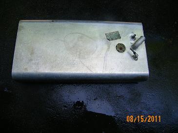

Another solution would be forget the portable tanks, install a permanent one and vent it. Just per chance I have two tanks for sale. One is listed in the glassifieds and the other is a 12 gallon plastic.
