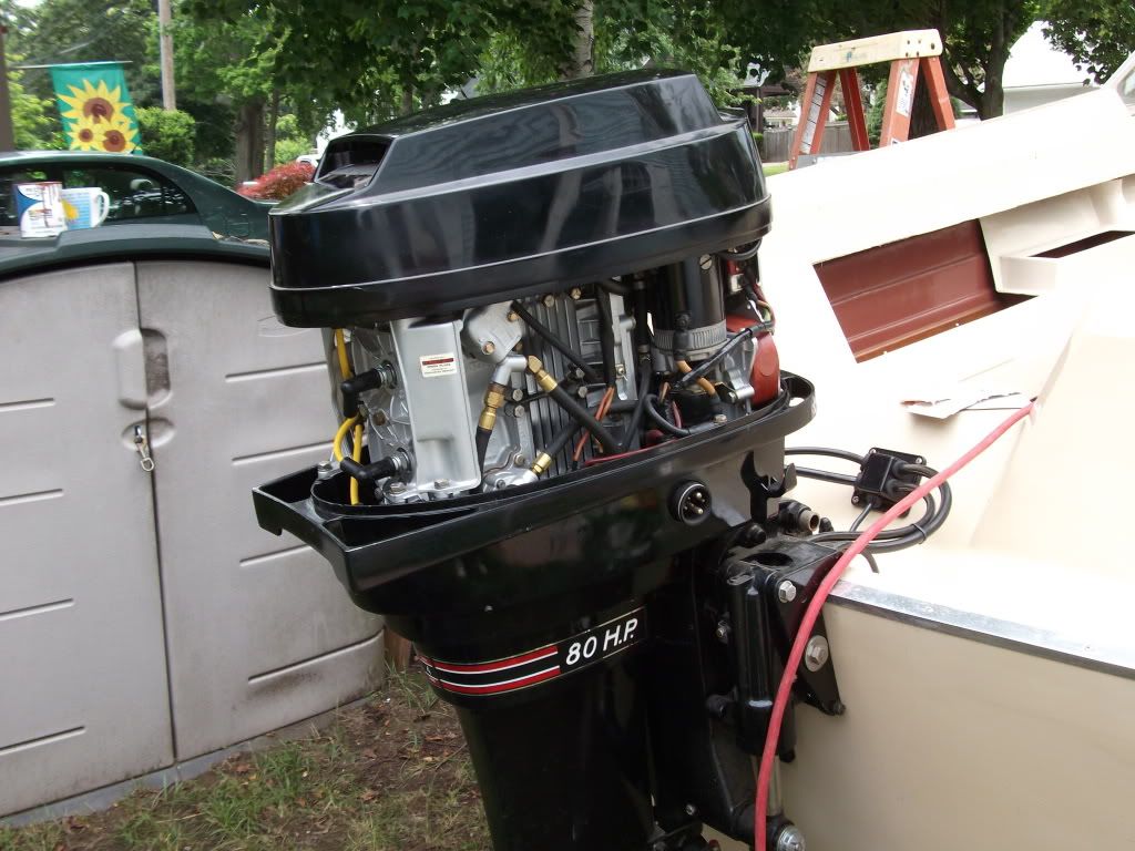

I think the underlying message here is "encouragement" Last year, I rebuilt a old Merc 80 H.P. When I started,I knew absolutely nothing about outboards Think of it this way...."Nothing ventured, nothing learned" If you're going to junk it, at least take it apart to see how things work. You might surprise yourself.
Here is a pic of what I learned!
