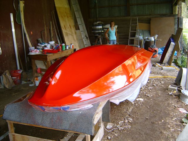

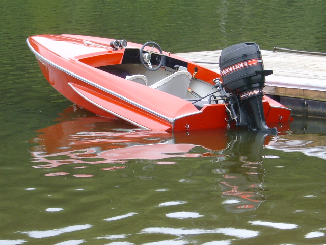

I used the interlux system on a 65 G3,red. Its lasted 6 years so far. I sprayed the primer,but I used a 4" roller for the top coat, The hull turnd out pretty nice,6 coats with wet sanding after each coat, it was in the upper 70s,by the time I got to the top it had warmed up into the low to mid 90s and it didnt level out as well but it still looks good, also the primer was 24.00 and the red was 28.95, thinner 22.00, so for 75.00 I got 6 years of heavy use out of it.
Re:Fiberglass/paint questions 16 years 6 months ago #4255
hull pic
Re:Fiberglass/paint questions 16 years 6 months ago #4256
#2
