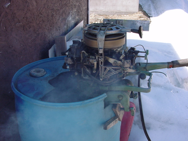

hey all

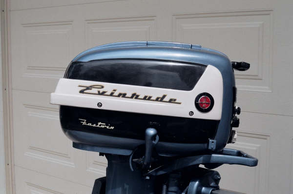

It's finally nice enough out to where I was able to try my 57 evinrude fastwin that I bought this winter. I've never started it before and had to figure out a lot about how it works.
Anyway I got it running and it starts just fine , however , it billows blue smoke. From my limited knowledge on motors I'm guessing its burning oil , and or buring gunk.
The metal gas tank had some really bad gas in it that I tried to empty out as best I can. The fuel lines also had bad gas in them that I cleared. But it's still blowing blue smoke.
The "fresher" gas I'm using is probably 2 or 3 years old from my old motor , maybe that's it? I also thought maybe it was too thick a mix so I added just regular non mix gas to it to thin it out but still smoke. Almost as if the motor isn't suppose to have mixed gas would be a good way to explain it.
any thoughts? I myself think either my gas it too old , still too thick , or isn't suppose to be mixed at all which would be really bad lol.

Actually I had to look up the original gas tank stickers to figure out what the problem was (mine was repainted).
I'm using 2 cycle outboard oil when the tank says to use just regular s.a.e 30 automotive oil. opps. lol . I hope I didn't wreck the motor.

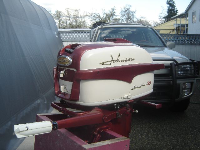

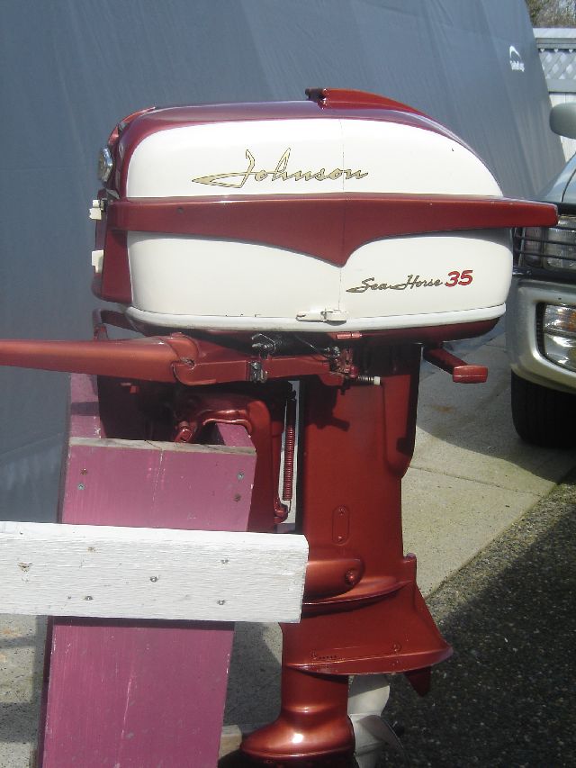

so today i finish wiping the dust off my Motor and she still look very shinny under all of those dry up dusts.I would like to get her fire up and see how she ran but i don,t know what the mix for this engine is . can you let me know. the leg does not have a place to put water to ran it so what is best put a big barrel under it with water?
Re:57 evinrude fastwin blue smoke 16 years 6 months ago #4157
HI; Before starting the motor I would do the following, check the ignition coils, wires, point gap and condition, and sparkplug gap and condition. Next would be to drop the lower unit and check that the impeller is nice and soft not stiff, cracked or broken. Once those items are OK mix up a fresh batch of 24:1 (ethanol free fuel if possible) fill a barrel up to the point where the impeller housing is completely submerged (I usually fill the barrel until the water is 2" above the rear bolt that holds the LU on) so the pump self primes. Hook up the tank and pump the button on the tank until resistance is felt to ensure that the carb bowl is full. Set the low and high speed needles in the following manner, turn both needles clockwise until the gently seat then turn the low speed out 1 1/2 and the high out 3/4 of a turn this should allow the motor to start. Pull the choke and pull the cord as soon as it starts and runs for a few seconds push the choke in. Once you get the motor running with the choke off adjust the low speed for best idle. To adjust the high speed you will need to run the motor on a boat at wide open throttle and adjust the high speed for best performance. After getting the high speed done return to idle and fine tune the low speed.
Al
Re:57 evinrude fastwin blue smoke 16 years 6 months ago #4158
when i bought this engine there was a receipt in the cowl show that they do a lot of work have done to it for the amount of $878.00.but that was in 06/13/2008.I know this is a dumb?How do i know where the impeller house is how far up from the metal plate that sit above the blade.thanks
Re:57 evinrude fastwin blue smoke 16 years 6 months ago #4159
HI;
The impeller housing is the bulge directly above (about 4") the anti cavitation plate. Can you list the details of the service order, if it was all gone over in 2008 it should be good to go with no work at all.
Al

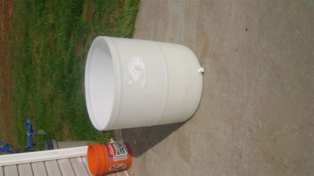

Here's a pic of a "run barrel" I just built with a drain valve in the bottom. The back pressure on the exhaust will effect the idle tuning if you run it without being submerged as you suggested, I'm told. ;)

Ok it finally stopped smoking with fresh gas and the tcw3 mix. I compared the gas I was using to the new gas , the gas I was using was slimey and greenish so the new stuff was much better.
Only problem now is the bucket I'm using it filling with grey colored slime from the motor. I think the lower unit is leaking :(
Re:57 evinrude fastwin blue smoke 16 years 6 months ago #4186
This is not uncommon, my '62 Merc700 did that when I first fired her up after sitting for 25+ years. I thought the same thing, but it turned out to be a combination of flushing out the cooling system and the oil in the gas we burn. It was a pretty heavily oiled mix of gas too, to make sure everything got lubed properly during start up, kinda like a break-in mix. I'd drain the barrel, check your gear lube level just to be safe, and put fresh water back in. You are getting water out the exhaust relief, right? (Not positive that motor has one, but think it does). GOTTA make sure she's pumping water, or it will become an expensive anchor. ;)
