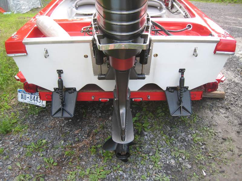

I used u-bolts just like this on my boat: www.lowes.com/pd_207772-34002-66263L3_4294925640_40_?productId=3085787&Ns=p_product_prd_lis_ord_nbr|0||p_product_quantity_sold|1&pl=1¤tURL=%2Fpl_Marine%2BSupplies_4294925640_40_%3FNs%3Dp_product_prd_lis_ord_nbr|0||p_product_quantity_sold|1
I drilled through the transom with a hole slightly bigger than needed. This allows sufficient room for the sealing compound (in this instance I would recommend 3M 5200) to seal completely around the studs going through the transom. Let this set for 48 hours, then just try and get them out! This will be more than sufficient for what you're planning on doing.
Mine came out looking like this:

[img]http://www.fiberglassics.com/media/kunena/attachments/legacy/images /FA_14t232L.jpg
From there just hook a harness as described above and go!
