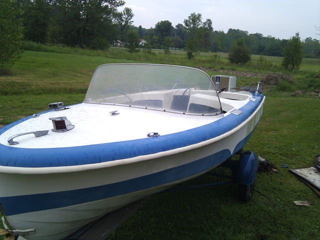

Hey, New here, New hobby and a new toy. As far as I know it's a 59 Larson Pla-Boy with a 55 chrysler on the back. Just needed a good cleaning, Tune up and a little seat work I think for now anyways.
I was told it runs but tries to stall as soon as you open it right up but when u slowly back down then it kicks up and flys.... What would fix that? A good carb cleaning or would it be something else?

Boy that looks nice! Try taking wet emory paper maybe 1500 or so and wet sanding that blue. I'll bet the color will pop right out. Just need to get rid of oxidation layer. My rule of thumb on any old motor I get before trying to start it:
- compression test
- carb rebuild with ethanol resistant gaskets
- lower unit service (remmove, check gears and clutch dog,reseal and a new impeller
- replace all fuel lines with alcohol resistant lines
Re:New Hobby 15 years 2 months ago #40907
Assuming your compression is good, I'd say start with a good carb cleaning\rebuilding replacing all the fuel lines\filters, a "by the book" linkage adjustment and clean up any stray or slightly questionable wiring. 9 times out of 10, that fixes any running oddities... not to mention, it's just good, preventative maintenance to do every few years to help keep your motor in tip-top running condition, at least, in my opinion.
An impeller wouldn't be a bad idea either, nor would some fresh gear oil.
A wise investment would be a shop manual first and foremost, to help familiarize yourself with that particular motor. I've spun wrenches on a couple Chryslers now and they have been a joy to work on.

Crosbyboat said a mouthful here. I can't tell you how much you need to update your fuel system. Mine was new enough not to use old rubber but the rubber primer bulb was torn up by ethanol. You don't want to get it all going just to have to replace those 50+ year old seals in the gearbox. I fixed an old Johnson up and it ran like a top. After running a hour or so it leaked oil out all over. Do it now and avoid trouble.

Nice find, Newman. (Welcome, by the way.) The old girl looks to be in pretty good shape. The gang is giving you great advice here, address the old rubber in the fuel system (and lower unit seals) before it "bites you" any more than it already has. A little tender loving care (tune up - refresh), and you're good to go riding for hours, hopefully! ;)

Nobody mentioned rebuilding the fuel pump. that should be done the same time as the carbs.

I guess we should say up-dating the whole fuel system. Fuel pump should not be forgotten.
