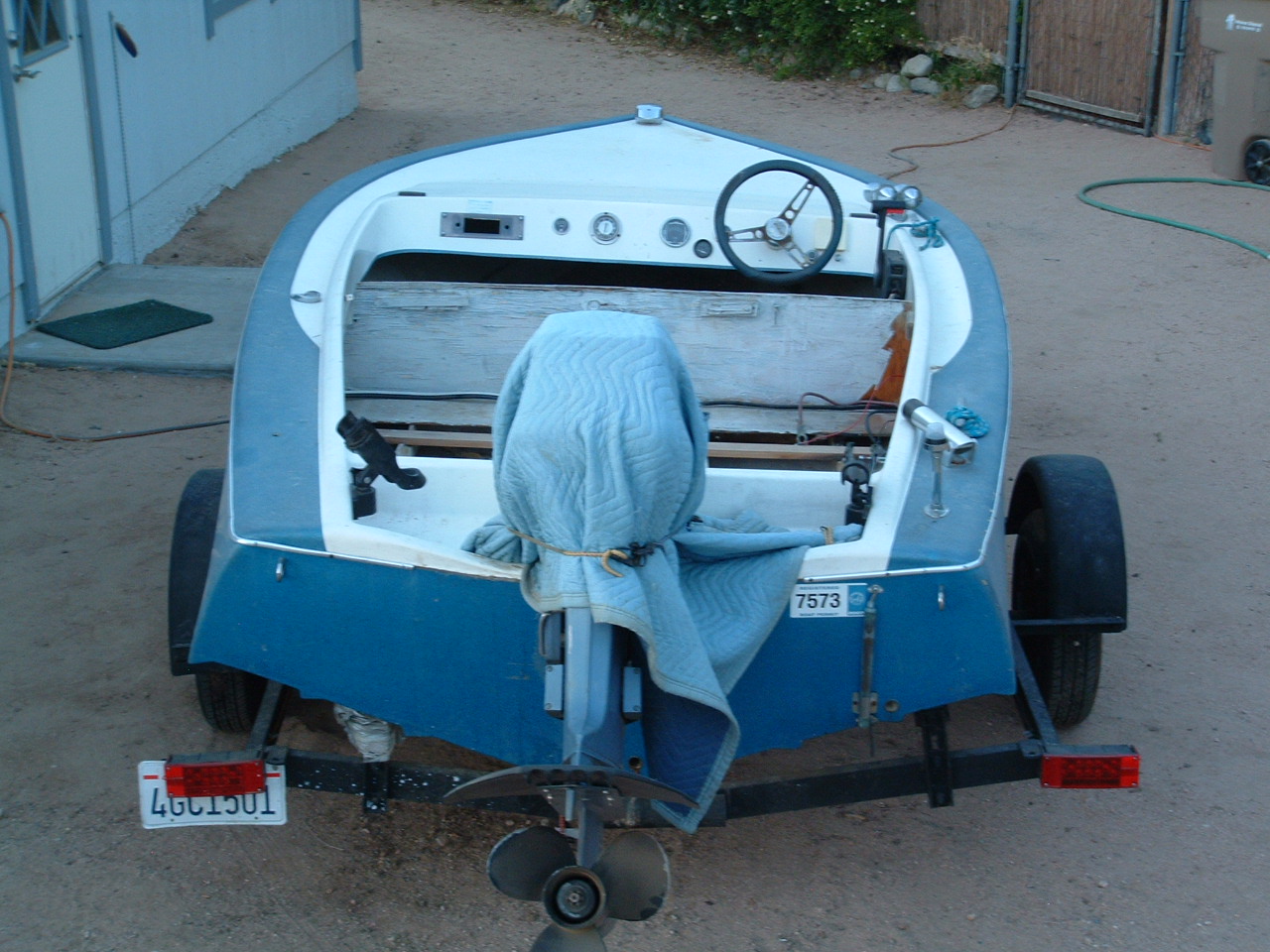

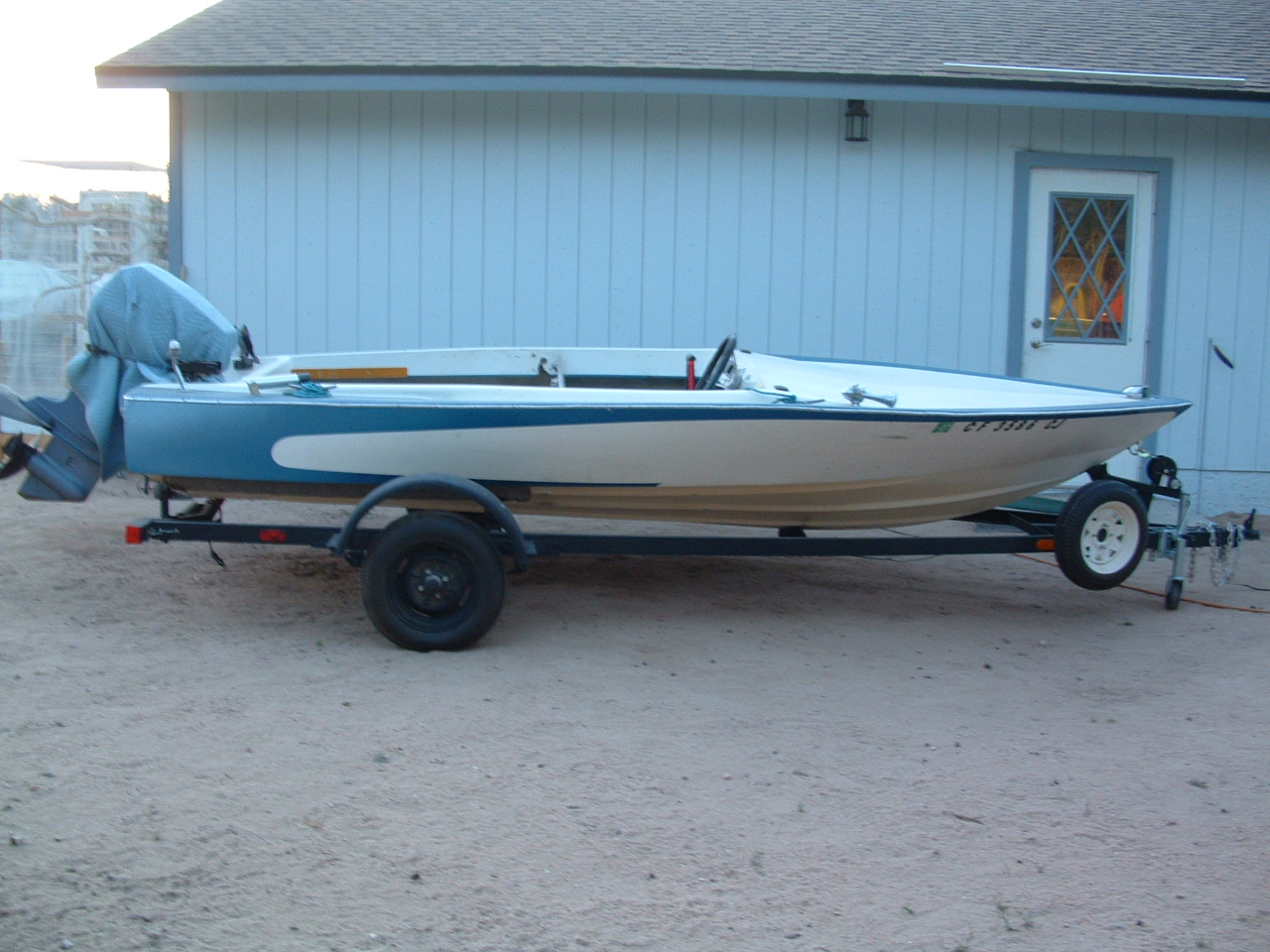

I have A 1966 Pittcraft 16' deep "V" ski boat that is in great over all shape. The rear 18" on the sides has a metallic finish that is a bit faded. In the past I oiled it to bring out the shine but now I just want it to shine and not fade off, the rest of the finish on the boat is fine. I wet sanded the area with 400 grit paper and its now smooth. Can I use an automotive clear coat on top to make it shiney. How can I bring out the blue color and shine it up? Were only talking 6 square feet total here. I taped part of the hull off so I can seal around the aluminum rub rail and when I removed the blue tape a little metallic stuck on the tape. Not even close enough to damage anything but it needs to be sealed. For fun I sprayed a few sguare inches with lacquer to see how that would look, it looks shiney but not the dark color shine im looking for. I know you cant use lacquer on a boat, Ill sand it off, no big deal but just wanted to see how it looks. I plan on keeping this hull for maby 1 more year then the motors coming off and going on my g3 and my friend has dibbs on this hull. Its built for speed. Ill post pics later on. Thanks for any comments, Mike

Mike, Rick here. I sell automotive refinishes and It
looks like your boat is heavy metal flake gelcoat.
even if it's not,and its a single stage metalic
without a clearcoat,if its faded or chocked out,
a coat of clear won,t bring out the color.Sanding the
metalic will only scratch it.If its chocked you must
repaint it bring back the factory fresh look. You
can use automotive urethane clears.Single stage urethane
is also a good choice.My Lake&Sea was done in BaseCoat
with urethane clear.
Good Luck
Rick

Mike once you have exposed the metalic in the gelcoat there is nothing you can do to bring it back. BUT this is a cheezy fix, get some blue tinting clear and put 2 coats on then 2 coats of clear and it will look close to what you had. Gelcoat replacement is the proper fix but the tinting clear will get you a couple of years atleast.
Re:QUESTION How to shine up a faded metallic finish? 16 years 7 months ago #4096
Suggest using a tinted clear urethane such as PPG Deltron or matrix urethane from www.matrixsystem.com/
We color tintcoat over faded metalflake frequently with excellent results.

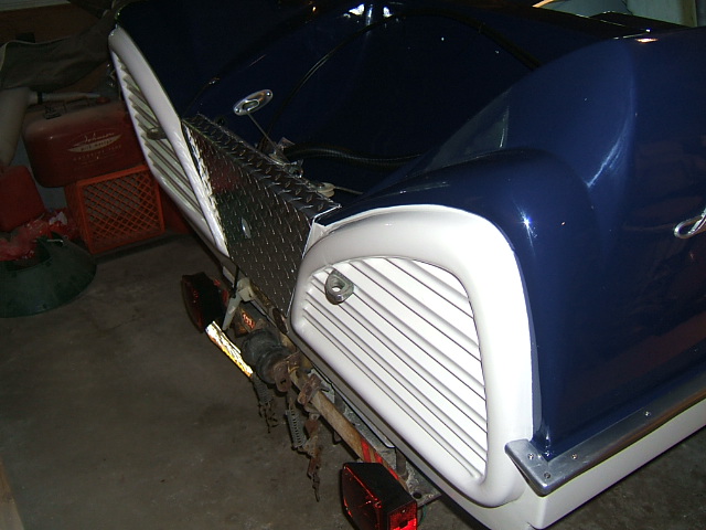

Devilbis,Sharpe,Sata $50 to $500.I shot my Lake&Sea with a
hvlp gravity feed.Hull was shot while laying on a creeper with
no drips.The key is just practice.

by the way thats a beautiful lake and sea.
