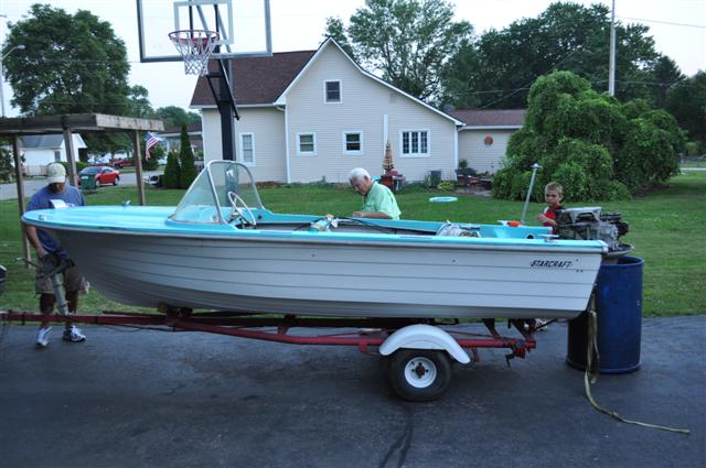

I have a new starcraft that I am cleaning up and I will be installing new interior. It has a good wood floor with fiberglass over it and I am kicking around ideas for seating. One thought was pedestal seats.
Has anyone ever used pedestal seats? Are the floors heavy enough to use them, any special care that need to be done when bolting them down to the floor?
