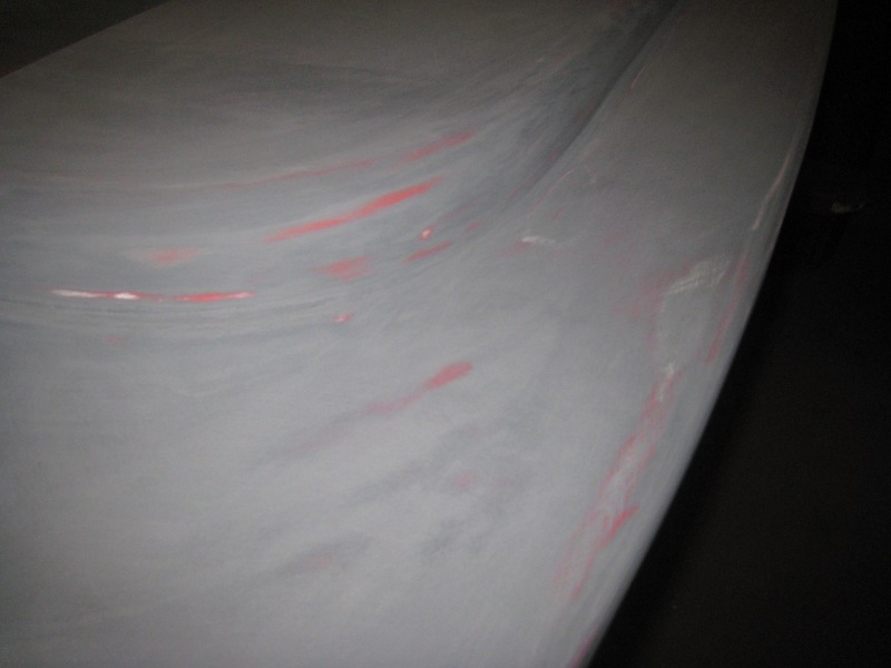

I put on Rustoleum Marine coatings (primer and top coat) first time around, and because I did not sand between coats, it came out crummy. Hey, I'm new at this stuff! In retrospect I should have sanded it smooth and re-coated with the same product, but was convinced to switch to Interlux. That caused compatibilty problems and I had sand everything off. I have started again with Interlux Pre-Kote primer, and have just sanded the third coat.
Now, after an amazing amount of wasted time, I have a few questions. I am assuming because of the previous incompatibility problem I better have a full coverage of Pre-Kote before applying Interlux Brightsides. I have sanded the last coat with 120 and it's baby cheek smooth. As you can see, I have areas where color shows through. Can I just prime those areas, and when dry, fair it into the surrounding primer? Or should I just do the whole thing again?
Never having done this before, I am open to suggestions. I just don't want to have to do everything over again! Thanks.
Frank

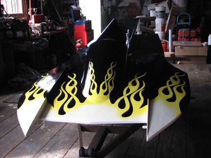

although I have the room for a permenant booth, I only use disposable spray booths from 2x4's and 3 mil plastic painters drop cloths,I even do custom stripes & grafics. for an exhaust fan I use a standard box fan which evacuates the space for me fine,
If you end up with any dust or dry spots in your paint remember that you can buff it out in 30 days when you wax to protect your new paint
the PickleFork below was painted last year in a dispoable booth,Im currently painting one of my other race boats in a plastic booth I built, Ill show you pics when its done, one can still produce nice work without all the professional equipment

That pickle fork looks beautiful!

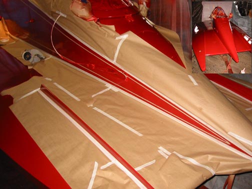

here is the current project my carbon fiber Tunnel boat painted red first in a disposable booth & then today Im laying out silver & black grafics and Ill finish those edges with white pinstripe
when the grafics are completed and 2-3 days dry I will wet sand the entire hull again with 600 grit wet/dry to prep it for clear coat

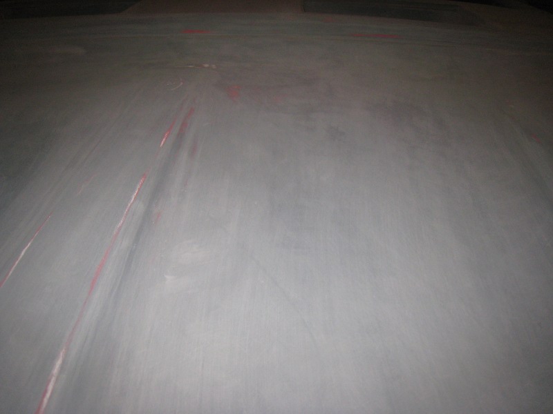

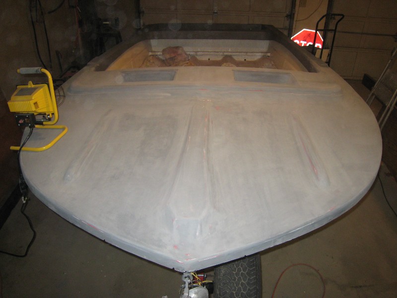

It takes too much time to sand after each coat, but I'm doing it. That was my mistake with the Rustoleum, and after everything I've gone through since I've learned my lesson.
I've got at least 3 hours of sanding on it, and at least two to go.
Frank

Once I sand the brush marks off the last coat I did, I may experiment with some new ideas. I think the last coat gave me problems because I did it outside. Next one I'll do inside and see if it's different. I am using Brian's process, but he's done more than 20 boats and this is my 1st. And no doubt last.
My advice to anyone who has problems with coatings is to read the cans and do it over if need be. When I did the first coatings (NOT Interlux), I didn't sand between coats and should have. Then I changed to another system thinking it would be better, and ran into major compatibility problems. If I had just sanded smooth the original coating and re-applied, sanding between coats, the boat would be done and I would be installing the rub rail, motor and controls, and the rest of the rigging. Instead I'm doing everything over, and am a long ways away. Heck of a lesson, and not fun.
Someone wondered how soon I could re-apply the primer (Interlux Pre-Kote). At 75 degrees, after 16 hours you can sand, clean, then re-coat. Sand between coats with 120, before top coat with 220. That's all the can says.

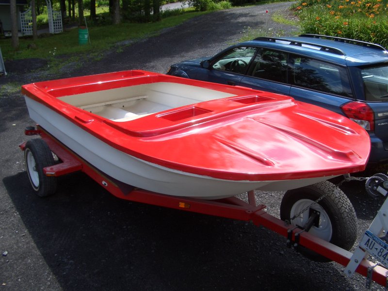

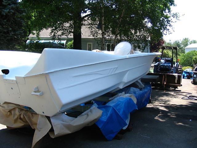

This is how she looked last year before I sanded off 2-3 coats of primer and 2-3 top coats...
Frank
