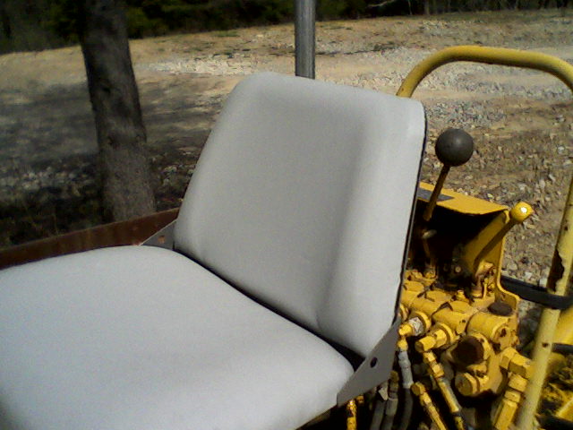

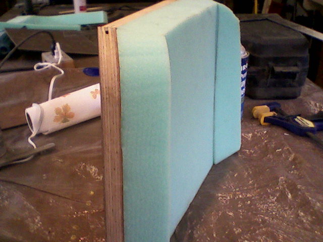

i just finished working on my tractor(mini hoe)seat,but it can also be used on boat seats,1st when cutting foam i found that using a electric carving knife,(like you use to carve your ham,lol)makes cutting foam easy and you can carve the shapes you need to.
then after that and you staple your vinyl to the back of the seat,you will get wrinkles in it,especially around round corners.
to take out small wrinkles use a heat gun on low setting and taking great care not to get it too hot,the wrinkles will start to vanish as the yinyl starts to shrink,but warning if you get too close it gets too hot and your job will melt.so take care,john

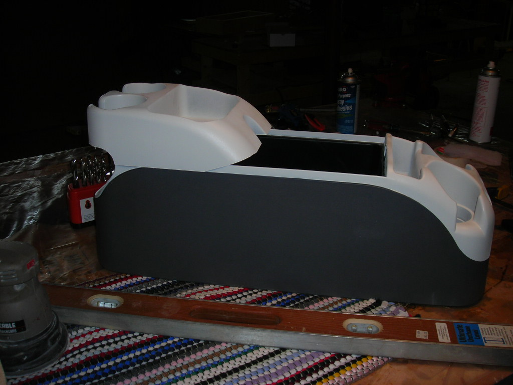

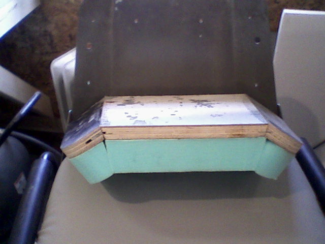

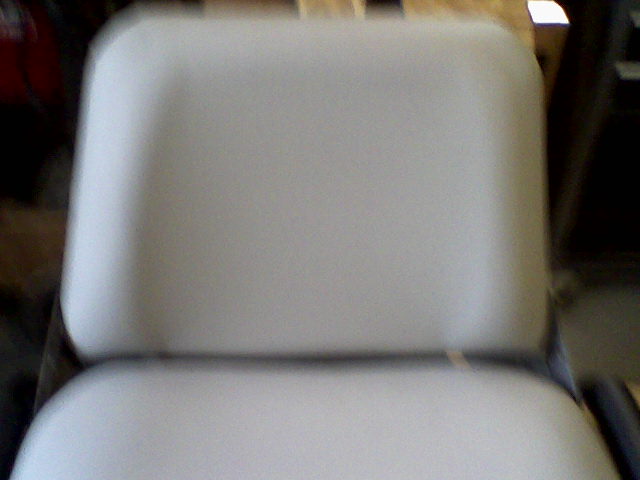

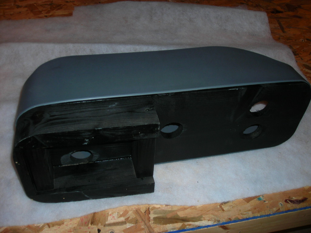

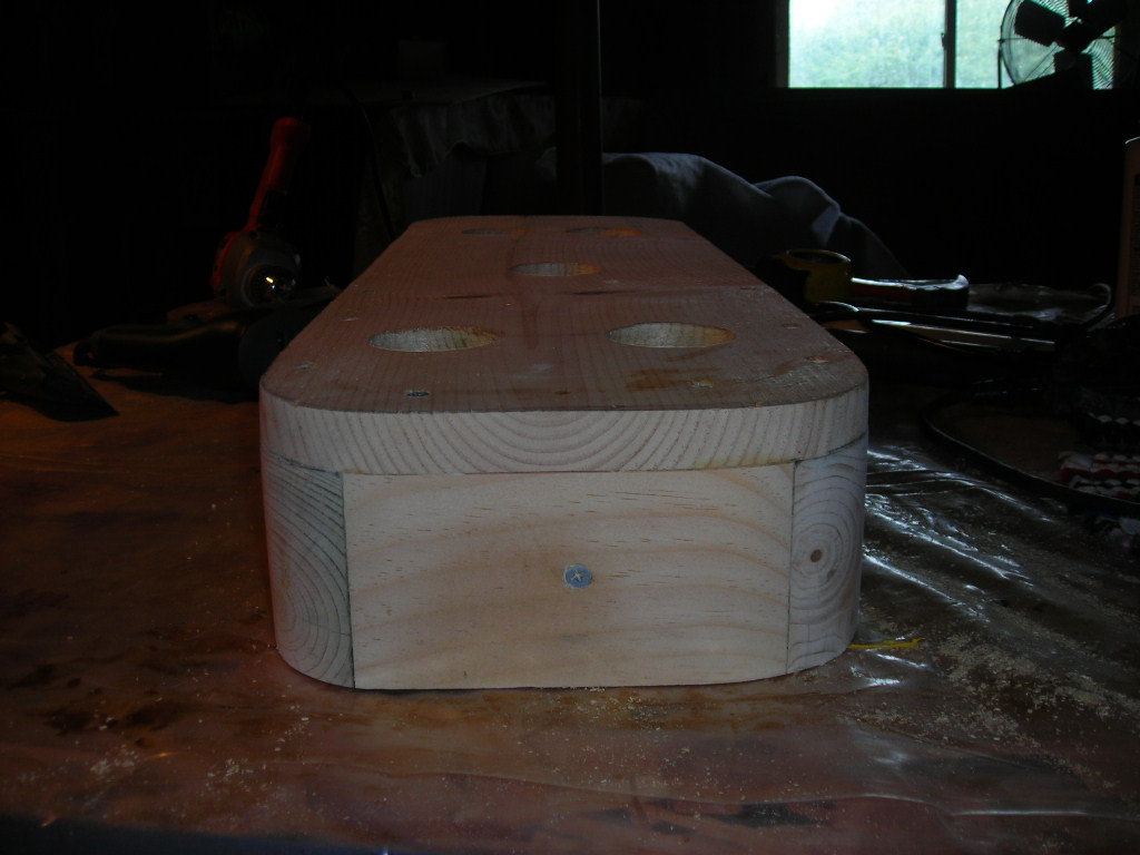

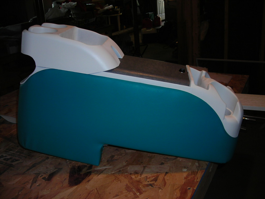

thanks adventurer,and thanks jerrfylube,thats a great tip ,where were ya when i was reupholstering the sun ray,lol,lol,those are great tips,i never thought of the steamer.heres a couple of pics of it.this is a console i bought ,then i made the rounded base to fit the floor ,(it has a cutout to form over the "ladder"that the seats sit on)the 2nd pic is with the custom base and the last is with the upholstery,the big holes in the bottom were to spray foam in ,and also as the sprayfoam expands it had a place to go,without blowing it apart,it made it stronger and also now its a cooler,lol.sorry i have the last 2 pics out of order the teal upholstered one is the finished one

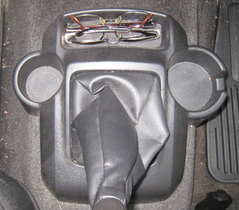

John, did you fab that console? Just wondering. While I love my new GMC, the cup holders are stupid. It's like GMC engineers don't take coffee with them when they travel. The one nearest the driver is sized for a soda can, and not much else, while the one of the passenger side is overly large and short, so anything you sit in there falls out soon as you make any kind of turn. I can't find either a decent sized coffee cup that fits the driver's side, and the passenger side one is just useless. Any ideas?

frank i bought that console at wally world and refabbed it to make it fit the sunray.

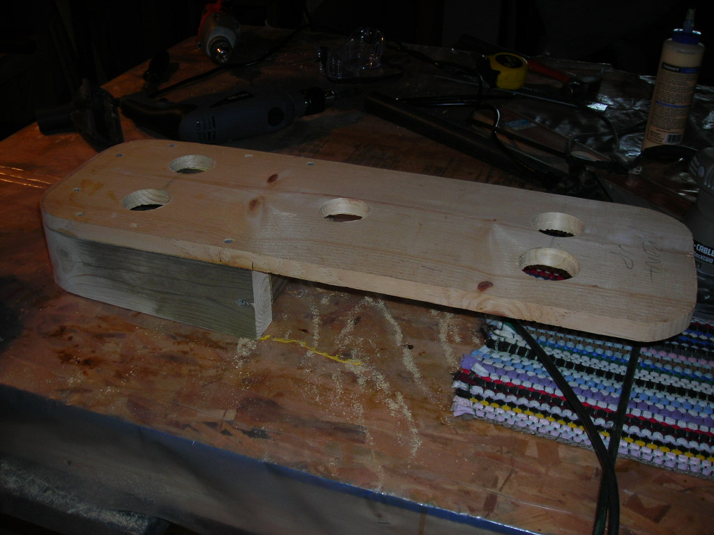

as for yours do you have hole saws,that fit into the holders?if you do cut out a couple of round circles with it and glue them together(stacked)until its even with the top of your holder(make them for both sides),then make oval or rectangle boards that fits over both of the plugs you just made.then make more just the same but cut out the 2 holes(the size you want for your cups) in the next ones then stack them,and glue them together and sand it all when its finished,so it looks like one piece,kind of like i did with the seat base,then stain or paint.if theres not enough room to make it a double holder just make 2 seperate ones ,sorry it didnt scan right,i hope i helped,and if this doesnt work ,ive seen your work frank i know you can figure out another way,this was just a thought its hard to make something up with out seeing the cupholders in a pic,john
Re:2 upholstery tricks i learned the hard way 16 years 7 months ago #3899
Here's a pic John. That's an excellent idea John, I'm gonna give it a try unless you have a better idea, lol!
The left one is about 2 1/4" on the bottom, the right one about 3 1/4". Both are about 1 7/8" high.
Thanks!
Frank

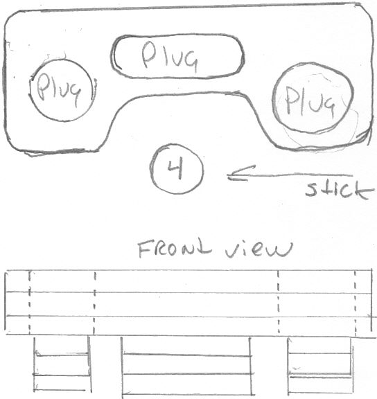

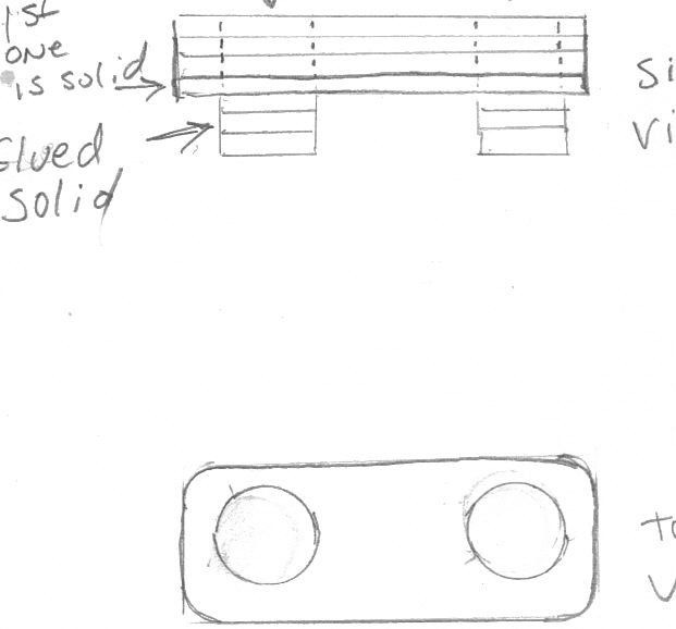

great frank ,it looks like the idea will work,if you make the two plugs the same size as the holes in the holder,plus if you use oak 3/4 x 6 or 8,and use a table sanding disk,it will look cool from the sides too, with the layered look,once you get the top together just sand the whole sides together,like i did the base of the console,only you will have more layers,but look really cool,john.ps you will probably have to cut a curve in it so you can still use your 4 whell drive.also put in a plug for the place your glasses are sitting,it will make it more stable,kind of like this...
Re:2 upholstery tricks i learned the hard way 16 years 7 months ago #3904
Yes, I think it will work also John, but that is my gear shift. 4WD is a button on the dash. I sure appreciate the idea, because I didn't want to build anything that looked home-made. We'll see when I get time to do it, been working on the boat a lot, and have a slew of other projects. Thanks again!
