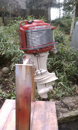

Re:Antique and Classic Outboard Motor Paint & Decals 15 years 3 months ago #37280
thank you headley,and that red cowl is fantastic,very nice ,i would love to see the whole motor,john

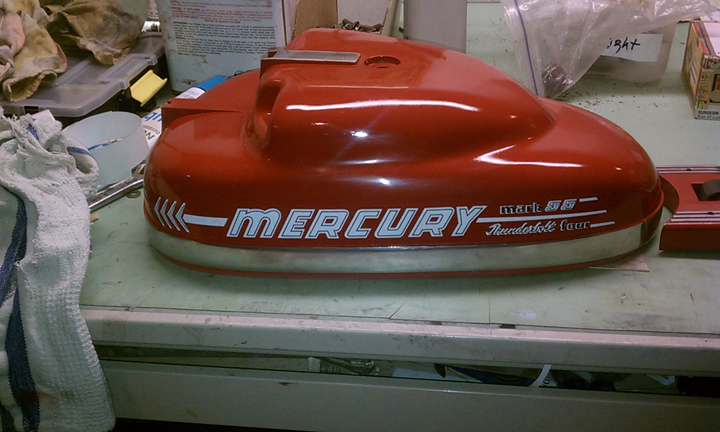

This is a Mercury Mark 30H I restored close to 20 years ago. Back then, NO ONE was making correct repop decals for the old Mercs, so I HAND PAINTED mine. Still looks good 20 years later!
