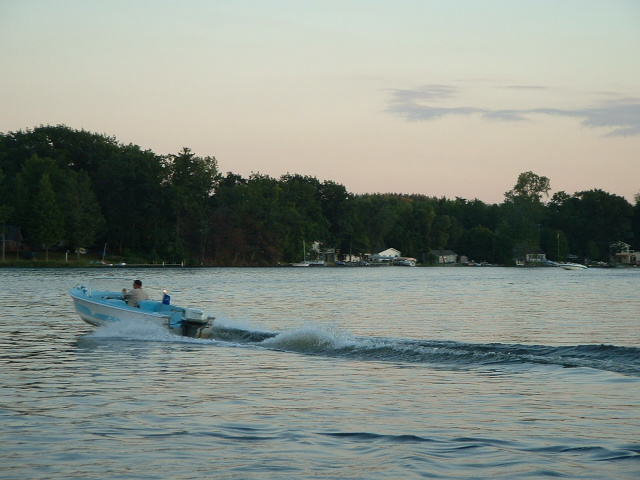

A nice 59 35hp Evinrude would look nice on that boat.
Here is my 59 Fat Fifty on my 60 Larson All-American. She's not fast but cruises along nicely.
