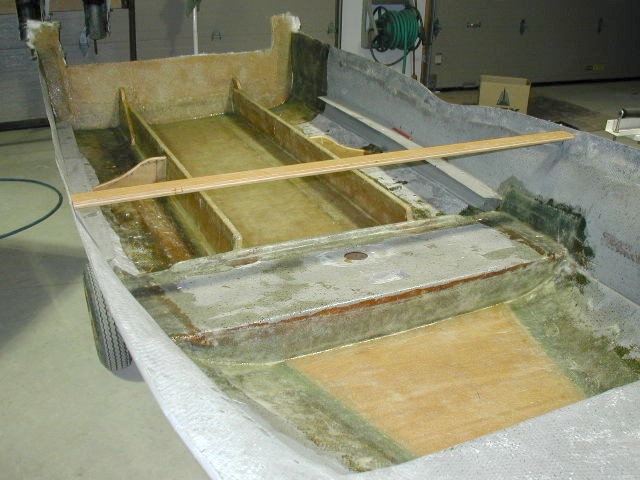

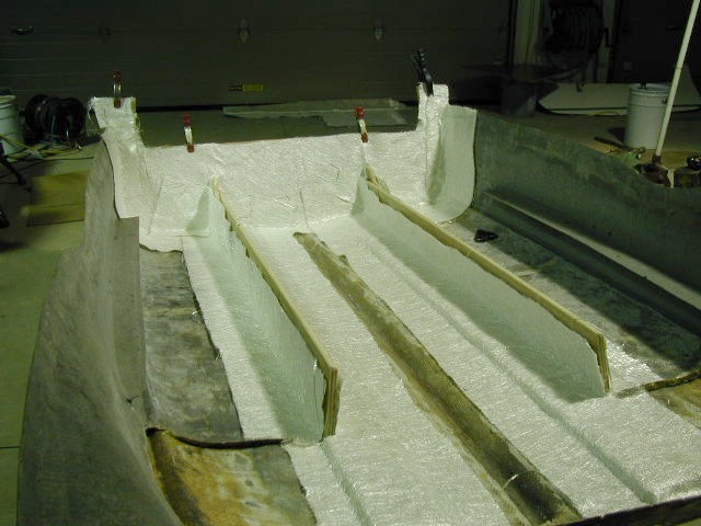

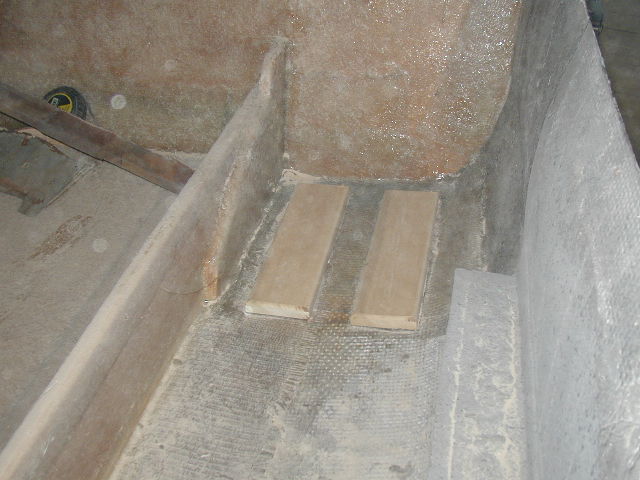

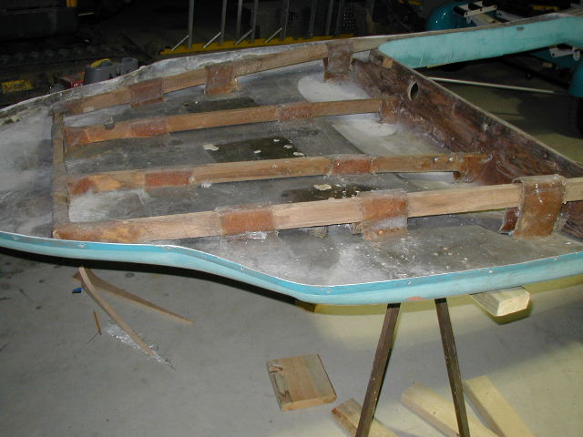

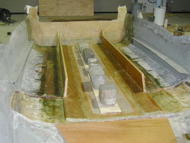

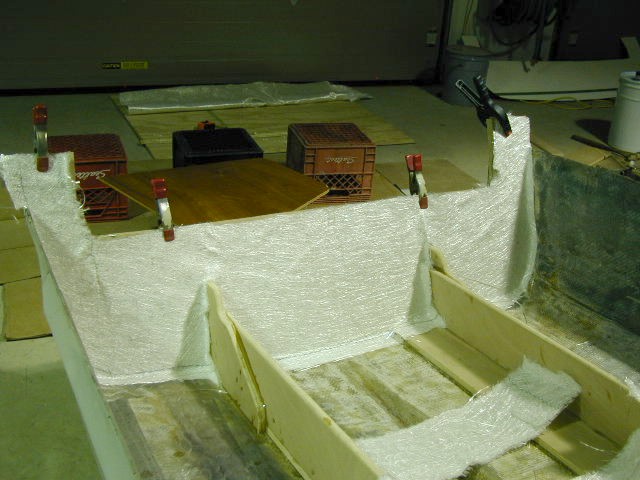

Transom, floors & seat base are all glassed back in. A little more glass work to be done around battery hold down & the "ears" of the transom now that the deck is fitted. Then it's ready for gel coat on the inside. Now it's time to tackle the underside of the deck, which has quite the sag.

Re:Glastron update 16 years 7 months ago #3694
What kind of resin did you use?
Re:Glastron update 16 years 7 months ago #3698
I used structural epoxy for bonding the wood to glass, & polyester resin ( Isophathalic, unwaxed) for the cloth. Also called tooling resin.

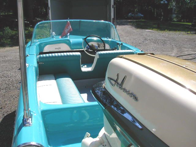

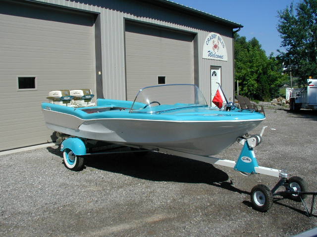

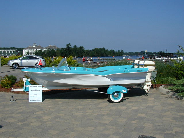

Been a while since I've posted, the Glastron is almost completed.
Here's a few pics [img]http://www.fiberglassics.com/media/kunena/attachments/legacy] [img]http://www.fiberglassics.com/media/kunena/attachments/legacy/images/P1010824.JPG
Re:Glastron update 16 years 3 months ago #11208
All I can say is WOW. Great job! Very classy.
Re:Glastron update 16 years 3 months ago #11225
BB, it looks like it just rolled out of the dealer's showroom, maybe even better. Great job!
Re:Glastron update 16 years 3 months ago #11226
WOW is right!! Outstanding!
Re:Glastron update 16 years 3 months ago #11238
  • tey1967
  • tey1967's Avatar
  • Posts: 161
  • Karma: 7
Woah. Sweet.
Re:Glastron update 16 years 3 months ago #11243
What a Beauty!!!!!Love the color combination....

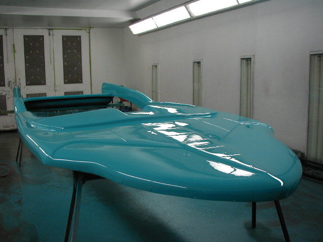

great job..very nice!.....what kind of paint did you use? spray or roll/tip?
Re:Glastron update 16 years 3 months ago #11411
I used Awlgrip & sprayed it

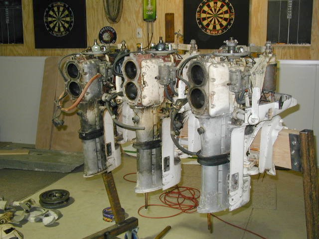

Re:Glastron update 16 years 3 months ago #11442

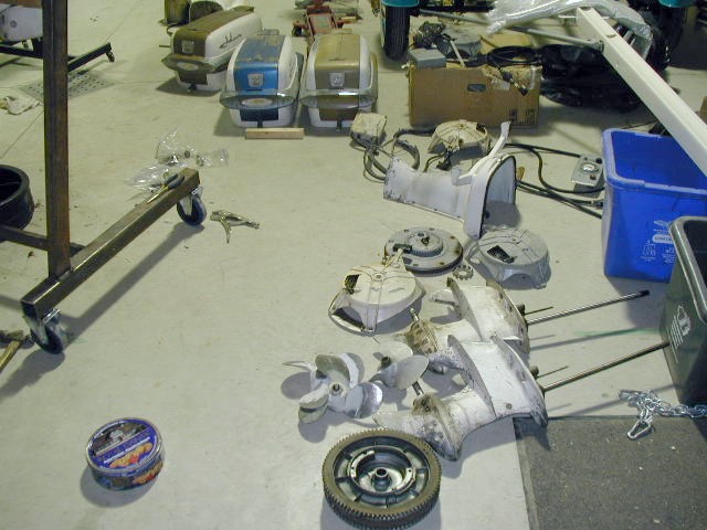

Motors look sweet too! Did you have to restore them?
Re:Glastron update 16 years 3 months ago #11452

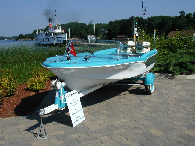

I saw this boat at the Gravenhurst boat show, simply spectacular !! Bill sorry we didn't get to chat I went looking for you but no luck. I thought your boat was the best Glassic there, you just gotta love twins :woohoo: Very nice resto !!

Re:Glastron update 16 years 3 months ago #11488
Yes I restored them, took 3 to make two good ones
