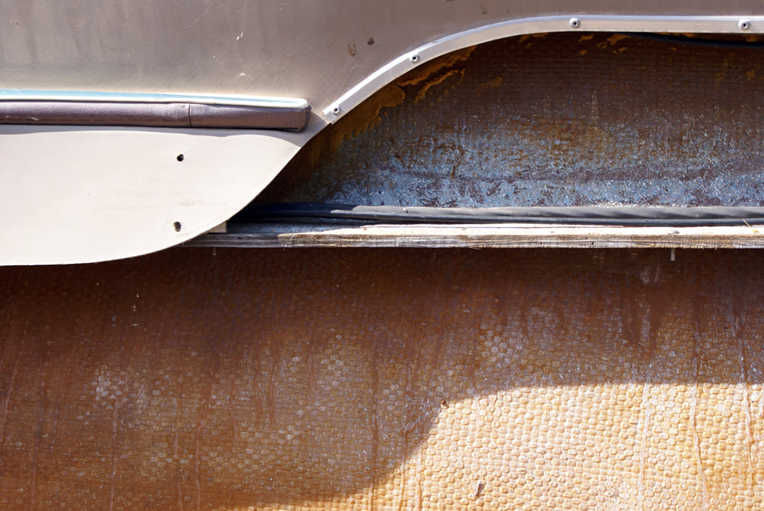

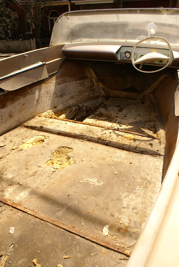

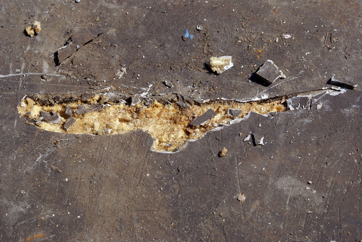

The attached photo’s will outline a fibreglass and aluminum stringer construction (that still seems reasonably well intact) and it appears as if they used little or no wood sub-deck. They then foam packed everything in between the stringers with foam. Now here is where it departs for me… (and no, I did not use a circular saw -damage shown in the photo's - someone else did that...)
It appears as if they then laid down an epoxy (grey, brittle, non-fibre filled) substance to seal the foam and stringer construction. They then laid steel surface bars on top of this epoxy (?) to mount the lounge chairs etc to the deck. These surface bars were screwed to the aluminum/glass covered stringers beneath the epoxy surface.
Now, the epoxy has cracked over time and water has entered however in a test “dig” I found that the water did not permeate the entire foam structure. I will however likely take everything up to fully investiagate, however I need some assistance on how this might be rebuilt – either as original or, some better wy if there are suggestions to this option.
Anyone seen this style of floor/stringer construction before – any suggestions will be gratefully appreciated.

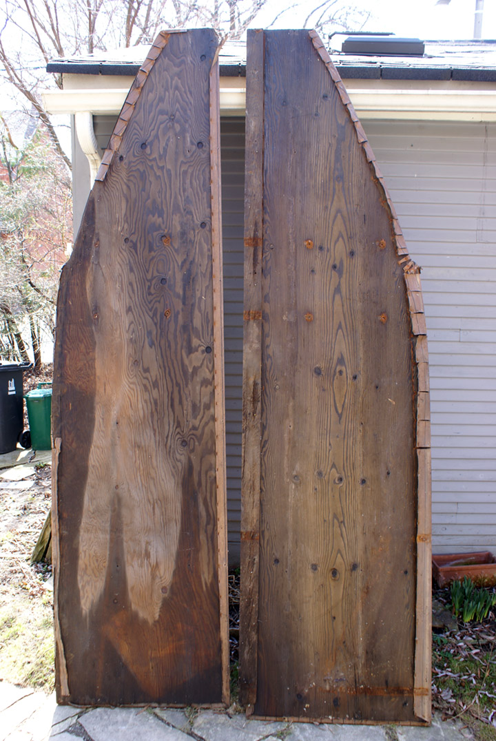

And some more photo's of the construction - here are some shots of the floor that was laid on top of this "Epoxy over Foam" sub-floor. Marine grade plywood with a faux TeakWood Vinyl Hardwood decking.
It appears that the sub-floor epoxy over foam was to provide the water tight seal to the underdecking and stringers and the plywood sat on top of this,

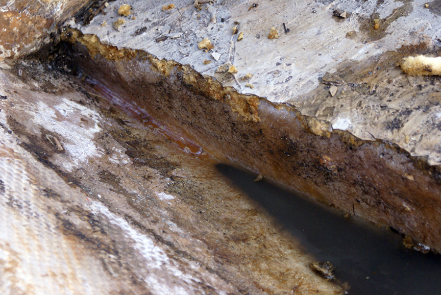

Also, an image of the interior hull - I note that there seems to be remnants of a foam over the surface - is this carpet backing? Would this boat have originally had carpet installed or some other material as a sound insulator or?
Reconstruction advice more than welcome - in fact needed...

I'm not an expert on the 62 year Crestliner, but my 1960 and 1961 had no foam at all. My construction in both is balsa core encased with fiberglass cloth over the hull. So from the out side it is fiberglass hull, balsa core, about 5/8 inch, then fiberglass over that. No stringers at all.
If I were to guess, I'd say that someone added all that stuff later.
Check what is under the foam. If you find a layer of wood, balsa, that's probably it.
