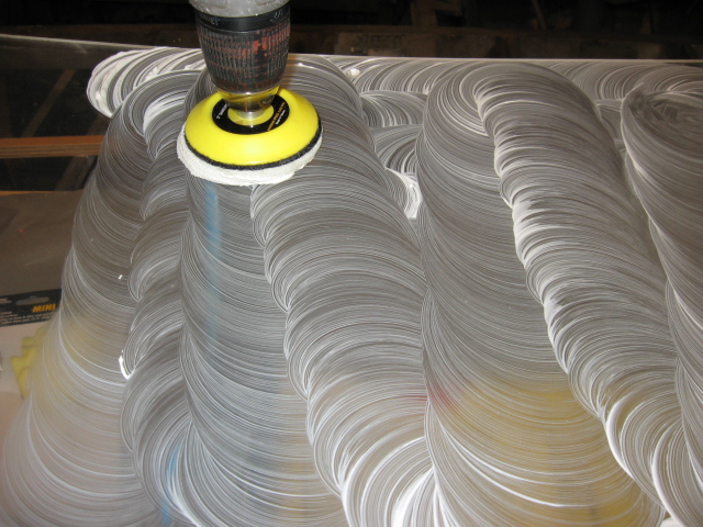

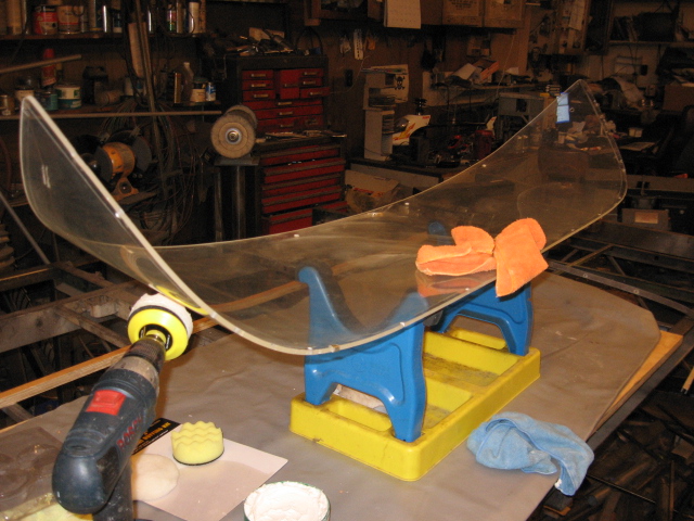

Well i started on my windshield today it is in bad shape it is like looking threw a kaleidoscope. went to the parts store and got every polishing thing on the shelf and went to work on it. after 4 hr i was making a little progress then i found a mini buffing kit i got to buff out sum headlight covers on my van. I put it to work on the windshield and WOW it works grate i did more in min. than in 4 hr buy hand

We use Brasso and a car buffer..We then go back over with a car head light buffer kit as to remove the buffer rings...Then if you really want to get down to you can get a kit that is used to buff and wax airplanes wind screens SSSS
