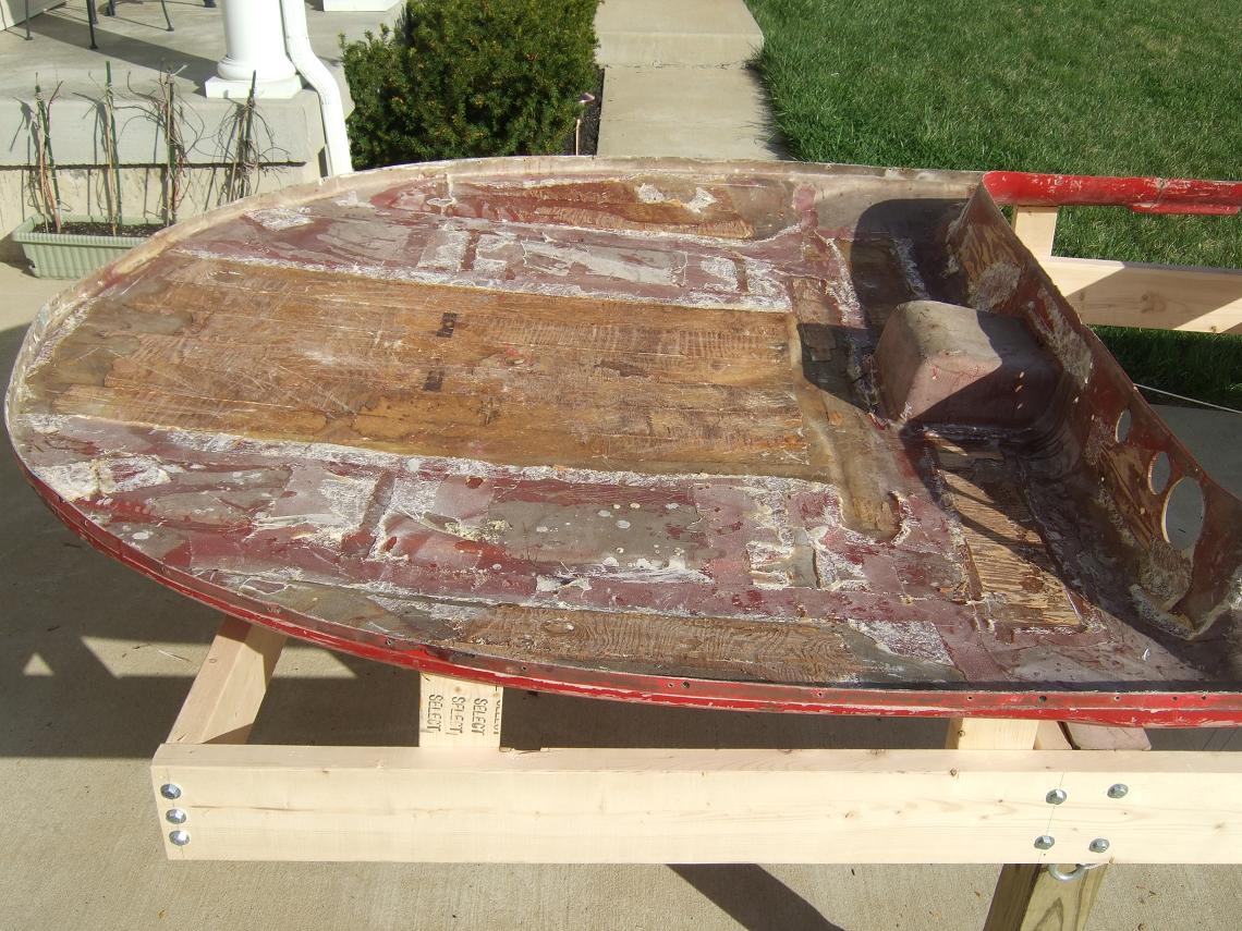

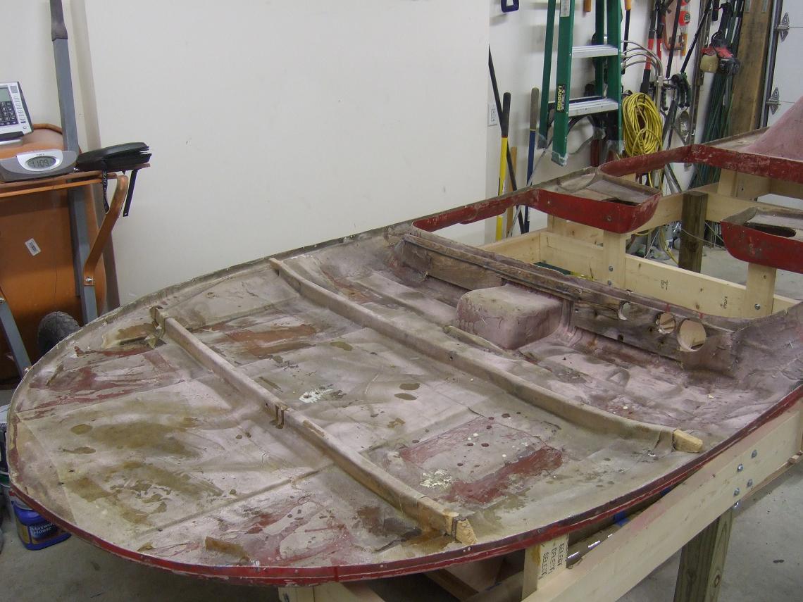

Here are today’s updates… Removed blushing from yesterdays glass work. Removed all of the old wood under the deck. The wood was really dry & brittle! Most of the wood & tape/cloth was barely adhered to each other. So after that I started chiseling off all of the wood that was still hanging on. Then on to some grinding & there is going to be quite a bit of that to be done!!!! It seems that when this boat was made resin was free! The resin is close to ¼” thick on most of the places the wood was attached to. I have like 4 hours of grinding in just ½ of the bow portion. No pic's of that.

Re:1960 Sea King restoration 16 years 7 months ago #4015
Here is a small update from Saturdays work. I finished grinding/sanding excess resin on the bow portion under the deck. As I said in my last post… There was So much resin used in this area! It was about ¼” thick under all of the wood. Is that common on these old boats? So about 8-10 hours of grinding/sanding was done there. Next I’m off to the rest of the underside of the deck.
