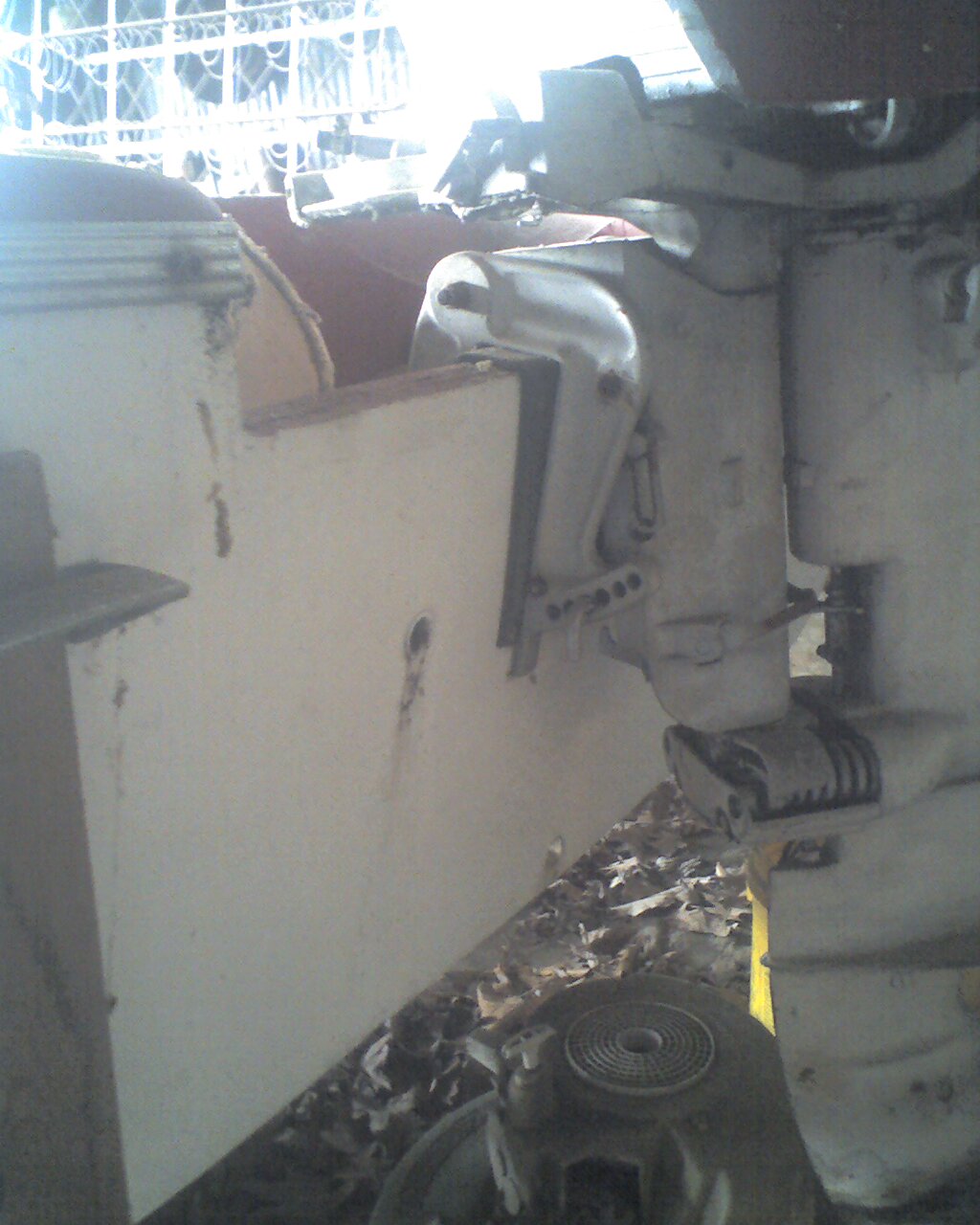

Jeremy, if the boat has a floor in it (as opposed to the hull being the floor), and has had any standing water in it, it is no doubt wood and rotted out. You can tell by standing in it - if it's springy and/or mushy feeling, it's not good. If it's solid, no problem. Also, if there is flotation foam under the floor, it is probably waterlogged, very heavy, and would steal substantial performance from the boat. If the transom ever had any way for water to infiltrate, it is probably bad. You can lightly tap a transom in different places and tell by the sound you get whether it's solid (like rapping a piece of oak) or not. Most old boats have these kind of problems normally.

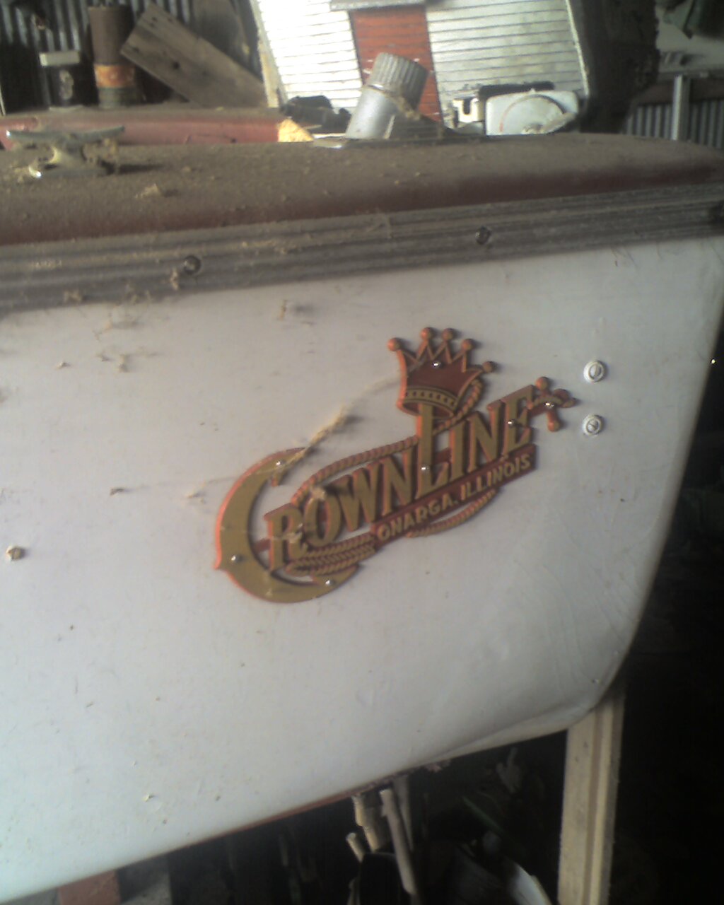

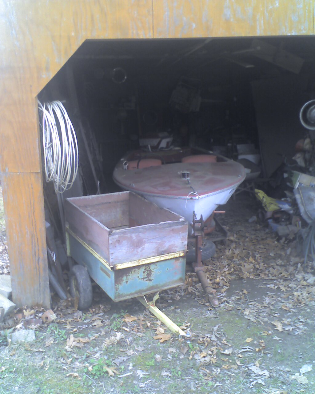

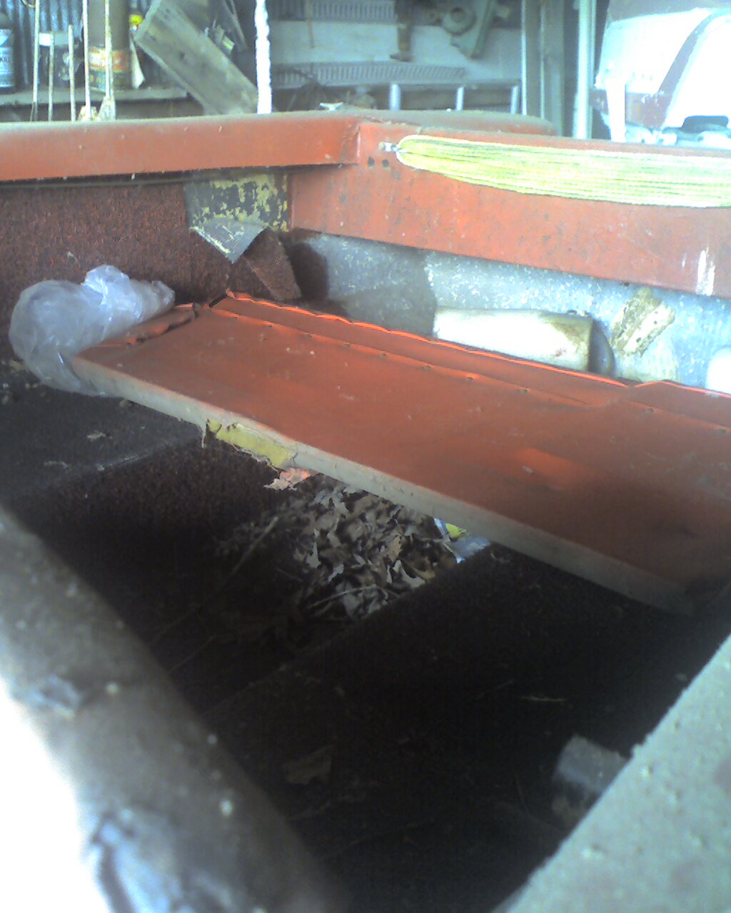

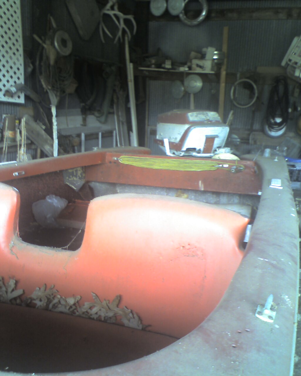

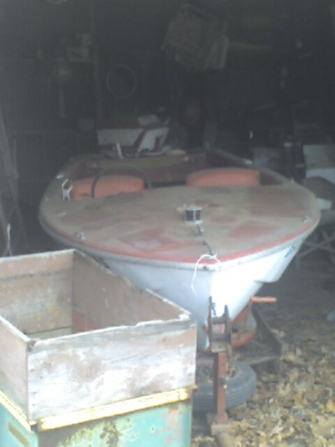

got to see it today. boat is a 1958 crownline. it was no ways near in bad of shape as i thought it would be. no critters, no standing water. the barn seemed pretty solid but did not have a door so it was open, she also said that someone had been over there recently to empty the stuff out of it. and oh yeah, she said I CAN HAVE IT! so, i need your help fellas, cause im towing this jewel home in a few weeks. ANY AND ALL ADVICE IS APPRECIATED! i need onfo, on outboards, parts, titles anything. there is no windshield on this, and come to find out, my dad apparently had some trouble with it back in the day and its gone. i banged on the transome (sp?) a bit and it seemed solid but i really dont know how to tell. the cables are no longer attached to the outboard, but i was pretty tickled that the wheel even turned and that cables were moving in the rear. the trailer looks like hell though. i dont know what they used back at that time but it basically looked like bent and welded pipe. lets see what else, she didnt know where the title was, is this a problem? i couldnt find a HIN number on the boat but she did have an old registration from my dad that had that and a serial number off of the trailer. the HIN was four digits, is this correct? ok guys, thats enough for now, ill get some pics up when i get back in town, happy easter and thanks

Some 1957/1958 literature is posted in the Crownline section:
www.fiberglassics.com/library/Crownline
Depending on your state, an old registration in hand goes over well when registering. Be sure to check out your state's rules as not all require titles for small boats.
