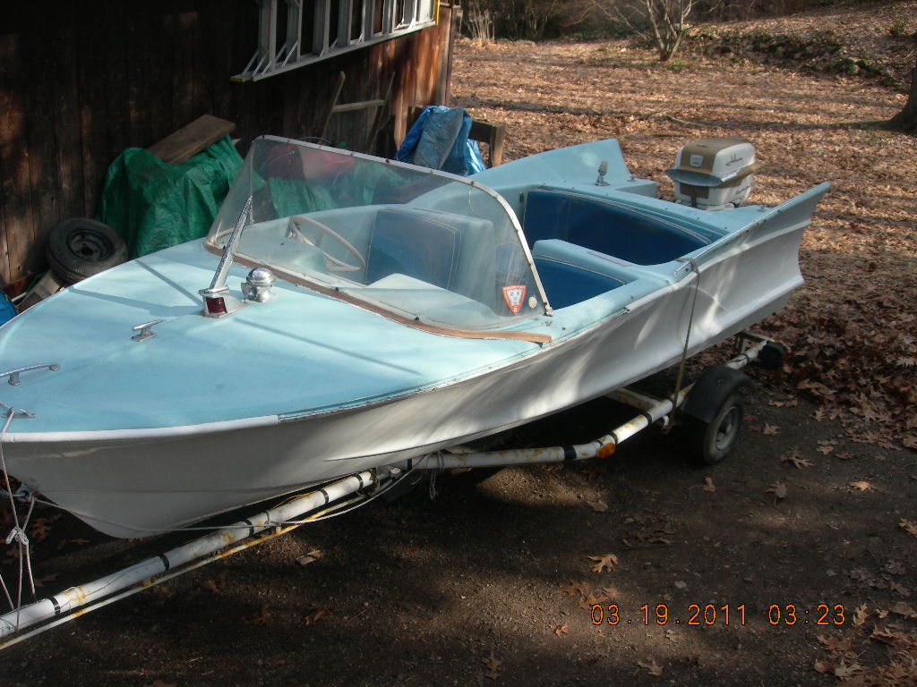

I like the color on there now, is that original gel coat?
Dave in sunny Buffalo

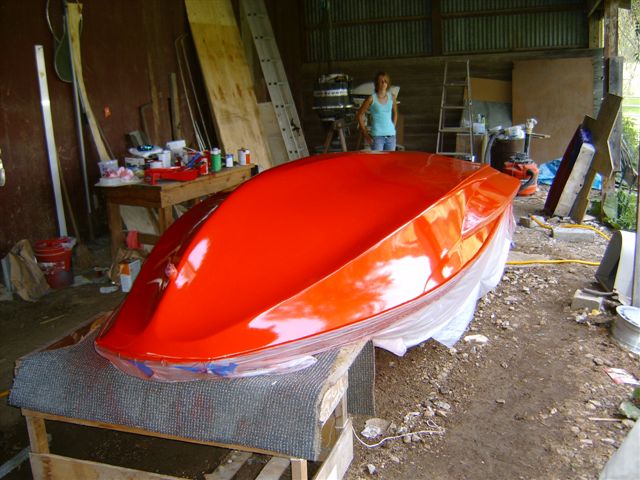

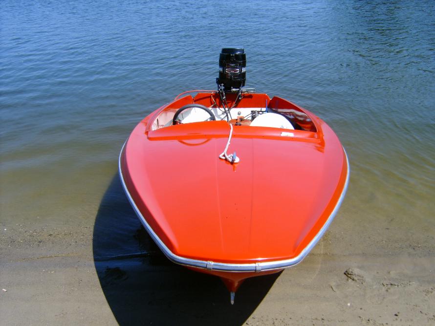

I use Brightside. You can find it for as low as $28 per quart online. $78 per gallon also. Here is how line turned out. I rolled and tipped it.

Yea Dave that is the original gel coat...its all original but certainly not saveable. Way too many cover snaps and other intrusions that needed to be filled.
I too am leaning towards original robins egg or whatever blue that is. I'll probably go that route but it's just a hassle to order and wait online...BUT I might as well do it right if I am going to spend this much time preparing.

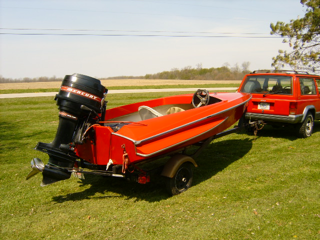

paint, Though I have not tryed the rustoleum yet I have used brightside interlux with great sucsess, I painted this 65 g3 8 years ago, been to fla 2 times from centeral IN Beloit WI several times and just 2 road rash scraches. it looks like I spray'd it on but I used a 4" foam roller made for cabnits. 7 cotes on the hull-wet sanding 24 hrs between each and 5 cotes on top. Now it did take about 3 months to realy settle down, it seemed to move-flatten down all that time. I need to re do the top because I used a cheep cover and stored it in my barn and the BAT crap soaked through and left small purple spots, Ive never used soap to clean it or wax, i did not sand the final coat,or buff it .
Re:CC Paint Color Choice - Poll 15 years 4 months ago #34487
Oh and I like the org seafoam color, It fits the era. the red g3 was org. seafoam green,or blue as some call it
