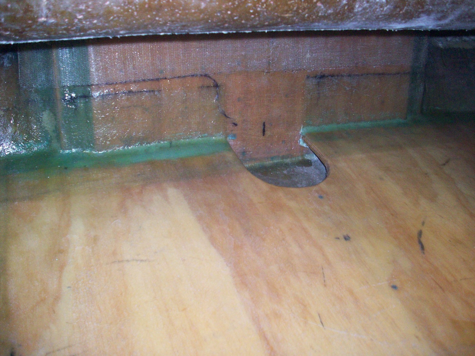

We have the new floor in here, I don't have pics of the stringers but they originally went from side to side we decided to go from front to back.

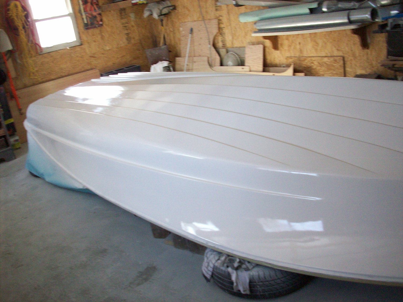

The boat is now MUCH stronger than original so it's time to start the body work. Flipped over and clean 50 years of gunk off the bottom

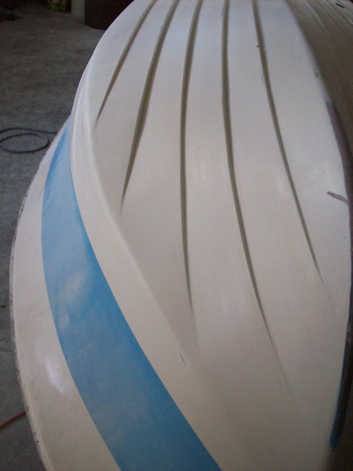

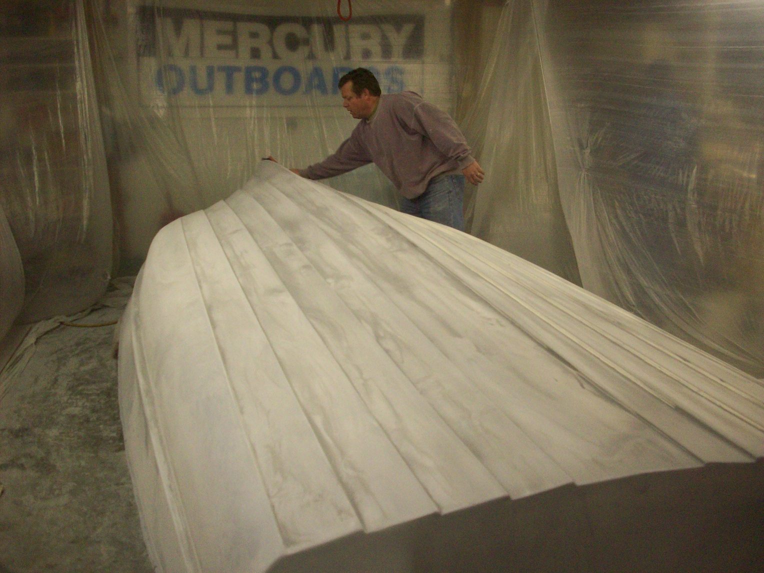

it's now sanded and ready to paint, 100's of hours of sanding but we got through the crazed gel.
Re:59 Thunderhawk restoration pics 16 years 7 months ago #3379
  • bogman
  • bogman's Avatar Topic Author
  • Junior Boarder
  • Junior Boarder
  • Posts: 77
  • Karma: 1
now primed and more sanding...

and painted...

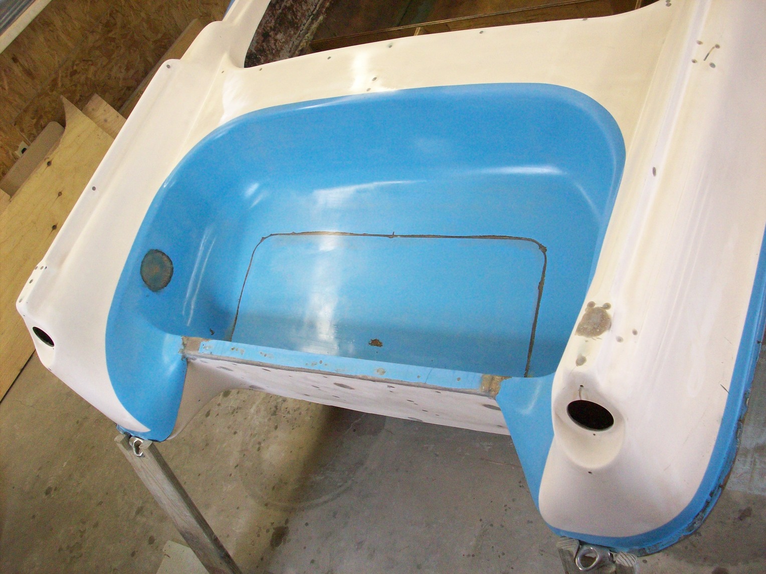

now she's flipped over, you can see where the well is back in which was out to gain access to replace transom. We filled over 400 holes in the top side..

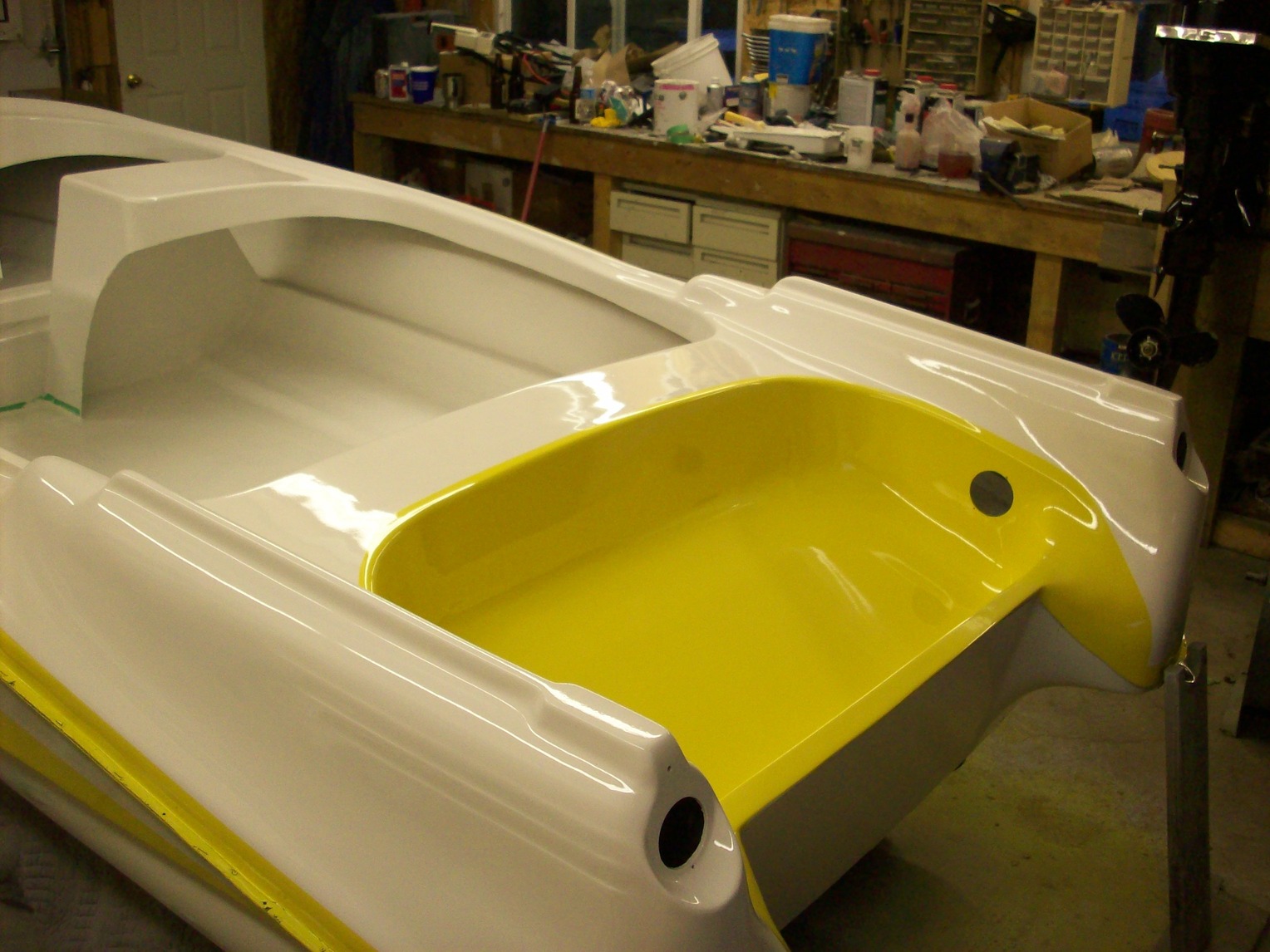

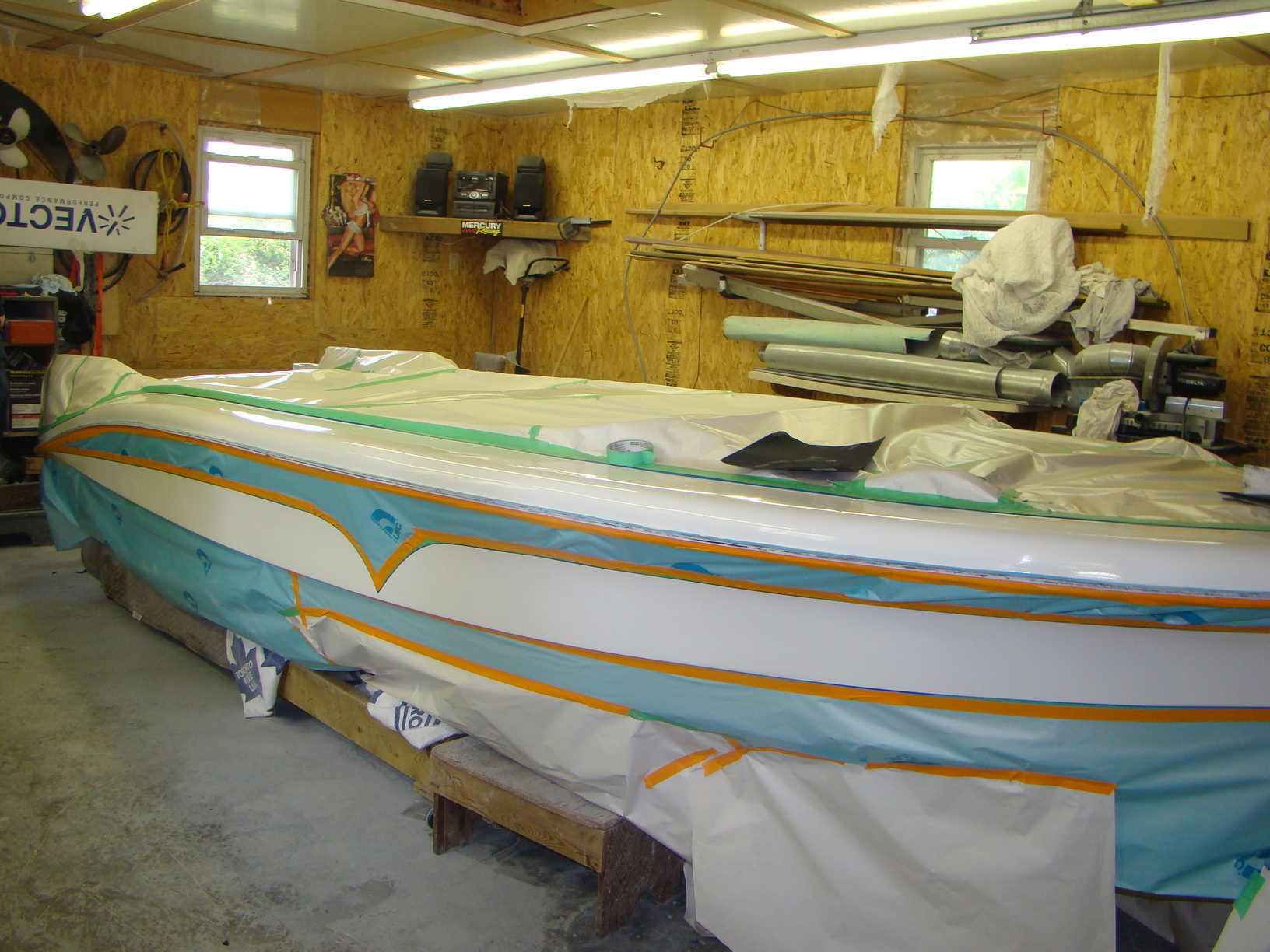

now she's painted white, time for some color.
Re:59 Thunderhawk restoration pics 16 years 7 months ago #3383
  • bogman
  • Junior Boarder
  • Junior Boarder
  • Posts: 77
  • Karma: 1
like this :)

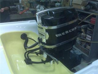

The new old merc looks pretty sweet...

I am interested in how you put the splash well part back in. If you would explain how it is glassed in top and bottom.
Thanks Del
Re:59 Thunderhawk restoration pics 16 years 4 months ago #9218
  • bogman
  • Junior Boarder
  • Junior Boarder
  • Posts: 77
  • Karma: 1
Thanks Del
It's glassed in from the bottom side and Cabosil ( sp ? ) was used to fill in the void from the top side, then lots of sanding ;)
