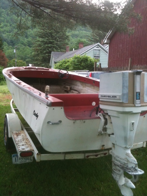

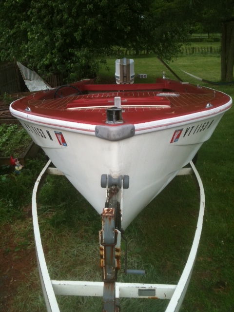

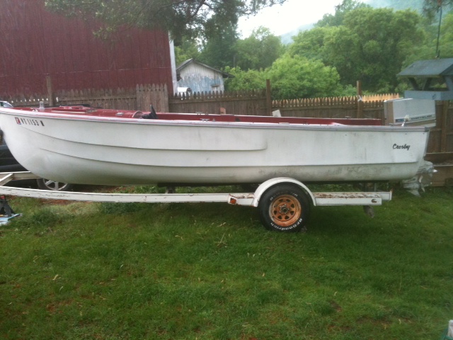

ask and you shall receive
Re:newb hello to all 15 years 5 months ago #32951
Shes not pretty yet but boat, trailer and engine were the right price ....$0.00 Rotted wood components and unnecessary wires and such were removed.
Re:newb hello to all 15 years 5 months ago #32952
I need to pick up a gas tank and battery to check the engine but it really looks to be in nice condition under the hood

rhag,is that a crosby emblem on the side?the bow looks like one,if it is ..brian lawson"crosby boat" will be able to tell you everything there is about that boat,he sure knows his stuff,hes a great restorer.
in the meantime you can look at the "glassic library" at the top of the page,you should find info there.

Looks like a cool old boat- It'll make a fun restore project.... I like those red decks w/the 'fake' planking!
I see you've already got a GREAT anchor- Ooops, my mistake- Thats a Chrysler Outboard :P

john - it is a crosby emblem, im looking for one that is missing on the other side. It is a 1959 Ranger Custom. I will check in with Brian Lawson thanks for the lead.

Sounds like I've got some learning to do about old motors - any info on these Chryslers?

I've got a 66, 50hp Chrysler outboard and yours looks to be a 70's model. Basically, the same motors. If it turns over and you have good compression, you've probably got a good motor. First, do the compression test. Or better yet, clean the plugs, put a battery on it, get some good gas and see it it will run. If it runs, shut it down and replace the impeller, fuel pump and clean the points. Chrysler's are good motors, parts are available and they're easy to maintain. Good Luck.

Based on my serial and model I believe the motor to be 1969 model. Does anyone know of service manual for this series motor?
85hp Chrysler

Randy, My 13 yr old son and I are working on a '62 Custom Craft we got from Mark S. It is a great way to spend time with your children and learn together in the process. Thanks for posting your boat with the red/white combo, as that is what we are considering for the CC and I like to look at other boats with the same color scheme.
