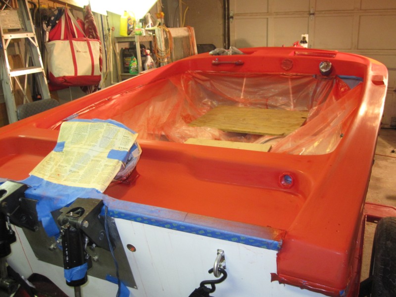

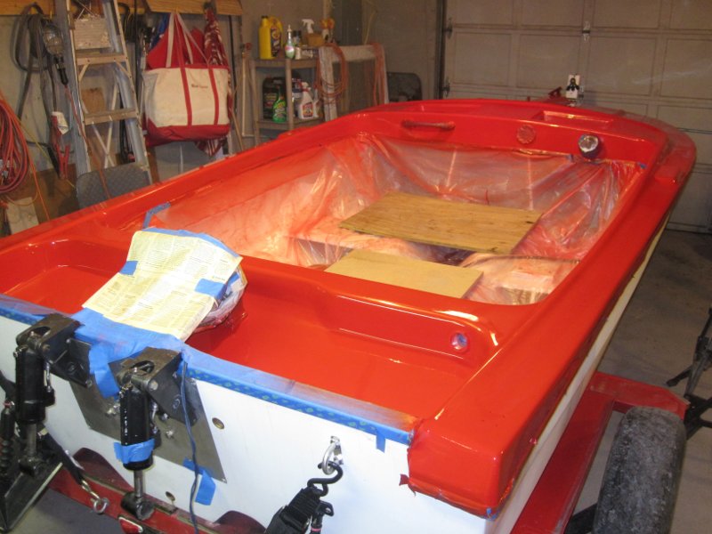

New paint 15 years 5 months ago #32167
What?!? Again?
Yup, sorry...
Came out shiny. Purdy brush.
Note to self, do NOT paint again in hot sun!
Frank

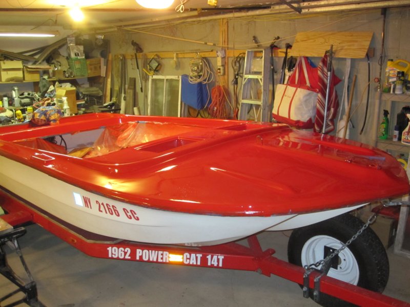

Re:New paint 15 years 5 months ago #32172
Looks good Frank. I'll be flipping my Invader over this week and hopefully get deck sprayed this week. Have to do floor then deck.
Re:New paint 15 years 5 months ago #32175
Looks Awesome Frank!
Re:New paint 15 years 5 months ago #32180
frank,it looks fantastic my friend,great job,and i also like your your little camper,but the finish on that boat is beautiful,john

Thanks guys, came out okay, a few tiny bubbles (tiny bubbles, hmm, that reminds me of a song...) here and there, but okay until...
My brother comes over for me to do some electric work on one of his trailers. I told him I just painted the deck, it's easy to see. Just as he's leaving he says "Frank, what are these little bubbles?" and touched the bow with his finger. Grrrrrrrrr. :(

Re:New paint 15 years 5 months ago #32204

Re:New paint 15 years 5 months ago #32218
Very Nice Frank. Not sure if you mentioned it elsewhere but what kind of paint did you use(for the deck and hull)? Obviously sprayed on but a few details on the paint and how much you thinned it down and with what would be nice to know. What is the name of that color?
Wish I had the equipment and facilities to spray but I have had very good results and mastered the roll and tip method. The key I have found is to use really good paint and good foam rollers and good badger or similar brush for the tip.
Pettit one part poly and I thin to test on a old pane of glass on vertical till it just stops slipping(ie running).

Yes Ron, we can pull the boat and trailer together. I pull Nine Lives with the GMC, Gail follows with the Subaru towing Spot. :)
That is NOT a Maaco shine Ron. Your paint looks 100% better, trust me buddy.

how bad are the bubbles? hit em with some compound and a buffing wheel?
Re:New paint 15 years 5 months ago #32231
I'm not too worried about it Jim. They're sorta evenly distributed, and I just don't want to do that. It still looks good, but will require a bit of touch-up here and der. I'm gonna let it dry REAL well, then go over it and see what needs help, do it, and call it a wrap. Plus I'm not absolutely sure you can even compound Brightsides without losing it's ephemeral shine. Last year the shine sure didn't last, which was one of the reasons it got repainted. I hate the thought of sanding it all off and starting over with a different paint, but I can tell you I think about that a lot!

Re:New paint 15 years 5 months ago #32312
F - Morning! So how did you apply? It looks good. B
Re:New paint 15 years 5 months ago #32313
Top of the morning to you B.
Very high quality Purdy brush. I may re-sand and pick up a Wooster foam brush and a new quart of paint. The quart I had was thinned with 216, and I brushed with 333, so I have some minor flows, plus areas I missed. With 333, everything looks very red, and it's hard to see where you are. Alternatively, I may just use the thinned paint I have without 333.
Interestingly enough, the only smooth shiny surface is where my brother touched the deck with his finger a few hours after I painted it. I wish the whole deck looked as good!
Any chance you could stop over for a few minutes and give me your best advice? I need to figure out what I'm going to do by Friday. Sand, wet sand, touch up, whole deck, foam brush, Purdy, etc. I want to be prepared to re-do it Saturday a.m., first thing.

Bless your heart Frank, I sure hope this time it turns out the way you want it. (Looks GREAT in the pic, BTW) Sincere best wishes for a Sat evening of "job well done" admiration! Keep us posted.

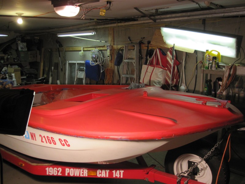

Re:New paint 15 years 5 months ago #32551
Ta da da! Ready for another coat...
Lot more lights set up just for the a.m. Pics later.
