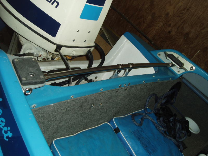

When I did my transom, I covered the top edge with 2 heavy coats of resin. Then I covered it with 5200 and capped it with a piece of aluminum. It definately won't leak water. Looking back, I wish I had put some cloth over it as well but I think I'm ok. Understand, this isn't exactly the way the Dorsett was originally built. Does your boat have a splashwell? Will it cap the back of the transom? You can almost see the back of my transom in this photo. Hope this helps.
