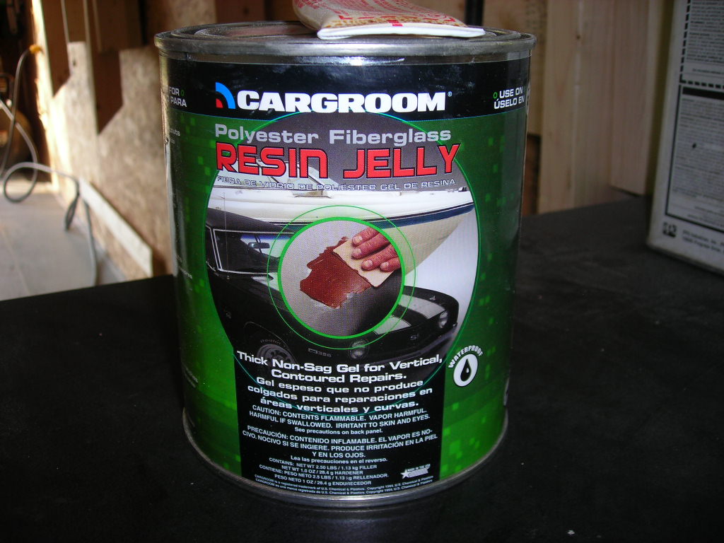

i keep reading about resin jelly on this board. i have a few spider cracks in some gelcoat on my boat, is this product good to repair them with? and were do you get it? i have tryed all the suppliers that our body shop does business with and they have not heard of it.thanks for the help. frog
Re:fiberglass repair 15 years 6 months ago #31057
I just picked some resin jelly up at O'Reillys auto supply. It's a Bondo product, made by 3M,. Haven't tried it out yet. I'm planning on using it as a "fairing" material in some difficult areas. As for the spider cracks, a dremel tool first I guess, and maybe then some jelly in the grooves might work. Give it a shot, the product isn't too pricey, and small cracks might be filled with it. Mr. Gibson claims it is easy to sand, which is nice, but I can't testify about the durability, and I don't know if there are any issues with the final paint and/or gelcoat finish on top of Jelly. Sure hope not...
Re:fiberglass repair 15 years 6 months ago #31058
just sand the spider crack down to the fiberglass,then fill it gelcoat,then sand the gelcoat down to what you need.simple?
Re:fiberglass repair 15 years 6 months ago #31061
here is the resin jelly i use,i get it at franks auto supermarket,its car groom brand,and sands very nicely,and goes on as smooth as auto putty.
