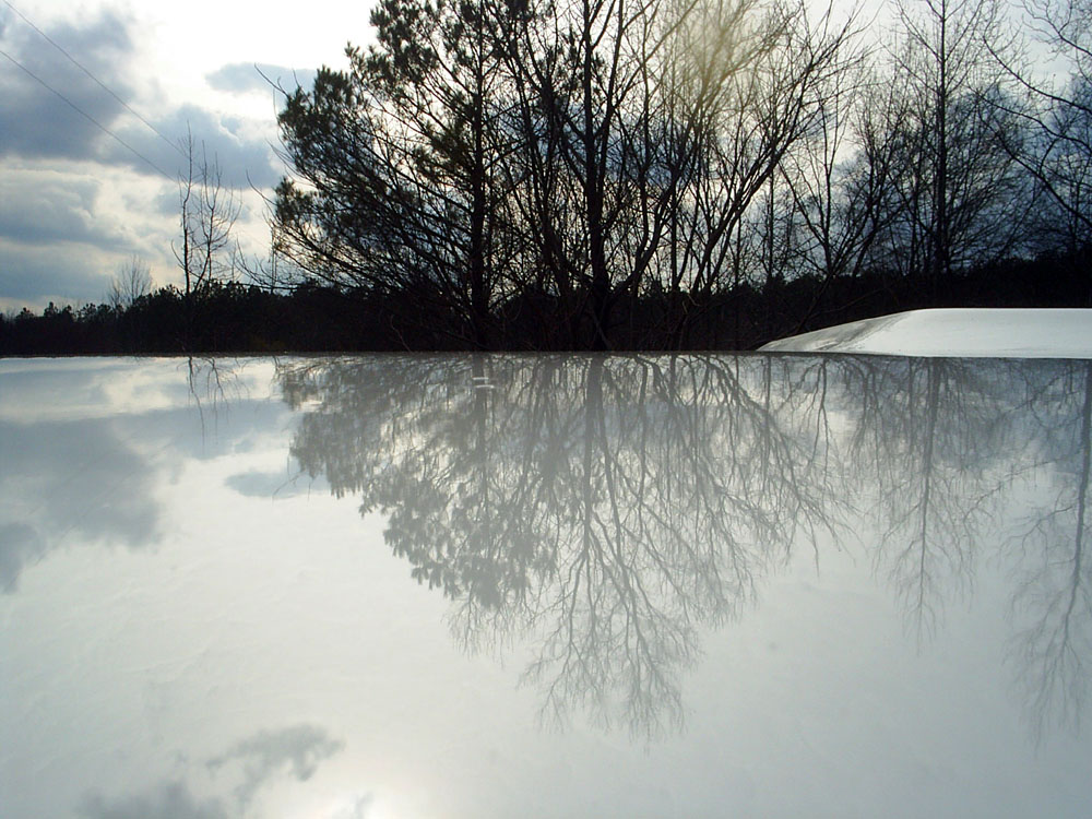

It got it's first work out tonight,.......
Got to love how that Polyurethane lays down.
All in all.. I have good draw but I need to add more filters. I'm not getting enough fresh air inflow. But it evacuates fast once I stop spraying. All in all I am happy with the project and how the booth is working.

Yes, I know Doug is good with the old paint gun. He is also better at explaining stuff than I am. I'm a horrible teacher. LOL :P
Runs, you will get them just keep going and try to minimize them. after it's all nice and dry you can wet sand them away and buff & polish that area and no one will ever know it ran.
